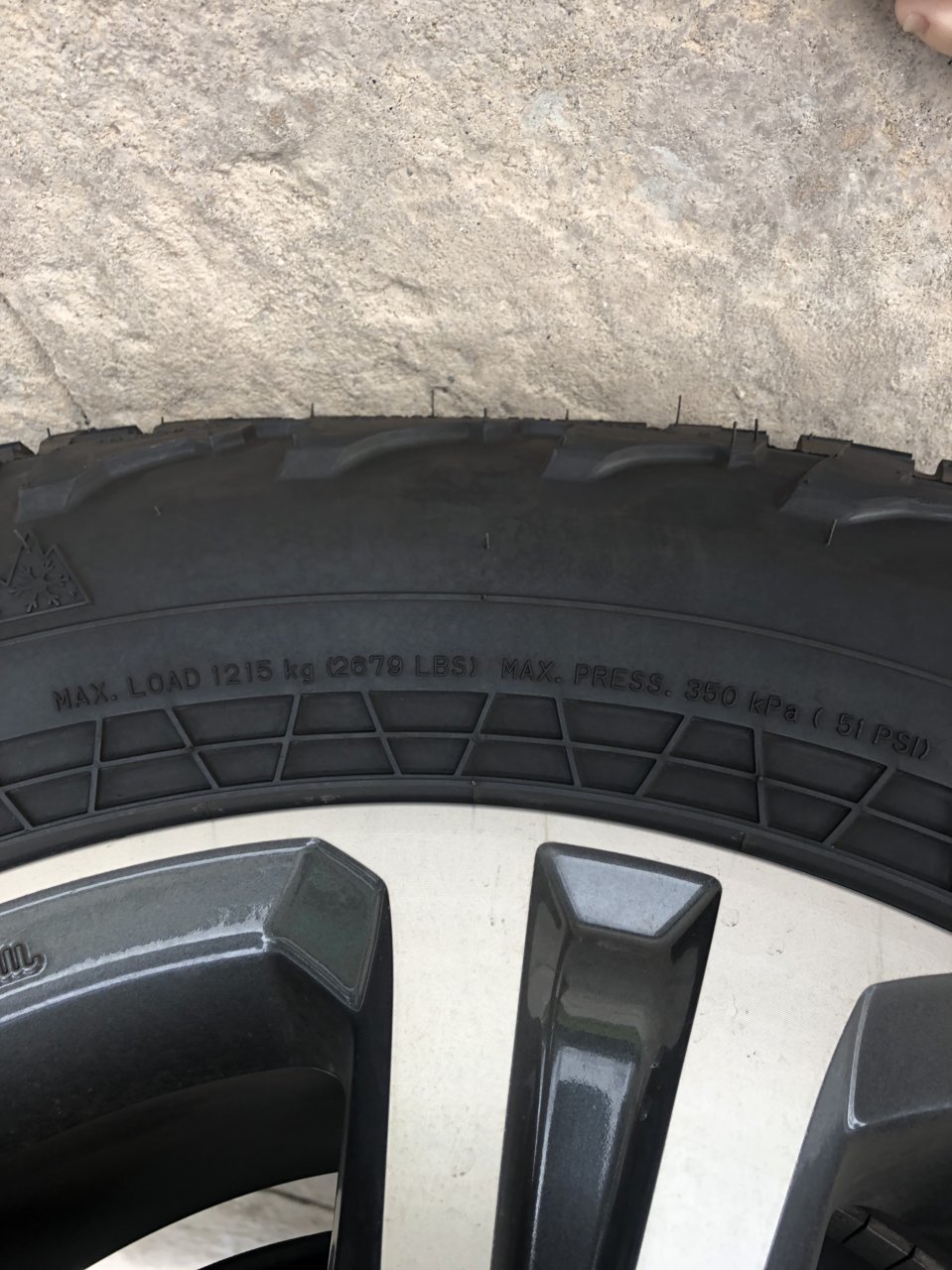

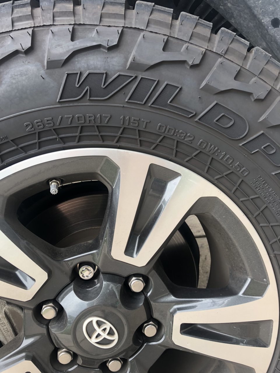

    Ok to answer everyone question about what load rating my tires are here is a picture of the sidewall info because I'm not exactly sure.
    I'm loving all this feedback though, I didn't think this thread would catch on and supply so much info. Keep it coming!

    http://www.falkentire.com/tires/light-truck-suv-cuv-tires/wildpeaka/t3w-tire
    Chart says SL.

    Based on the max PSI of "51" my guess is Load Range "C". Most "E" rated can support pressures up to 80psi.
