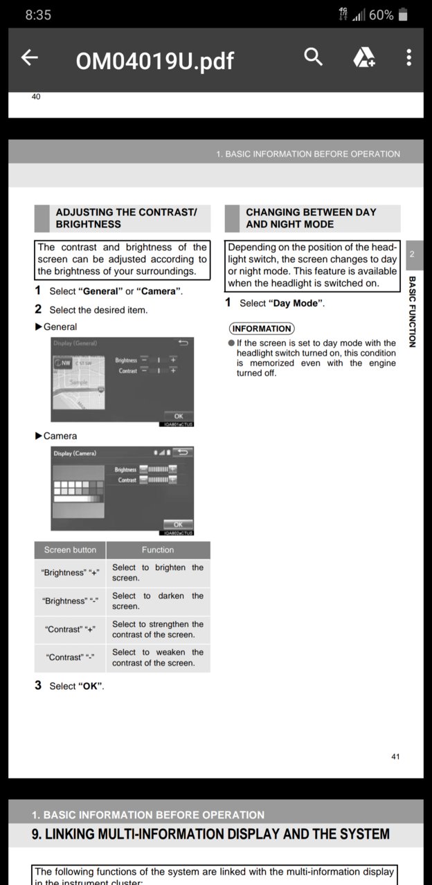

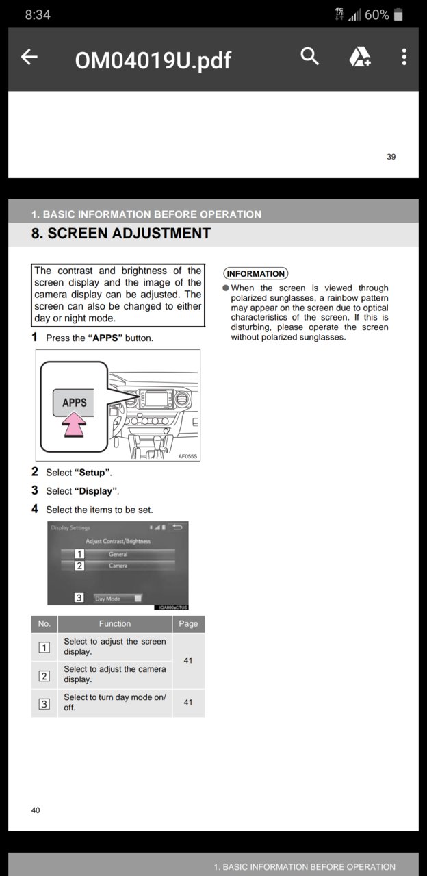

    The reason I asked about it being dark, your reverse lights could be the issue. They are pretty bright on the screen when it's dark out.

    Thank you guys, I found the camera setting, I must have adjusted it while in “general” and not the actual camera brightness. I’ll try it out Friday night and see if it made a difference. When launching boats we always keep our headlights off so that someone can see to back in beside us on the ramp. Appreciate the quick replies.
    And Daddy_o just to clarify. It’s just the overall brightness inside the cab due to the 7” display making it difficult to see while backing down the ramps.
