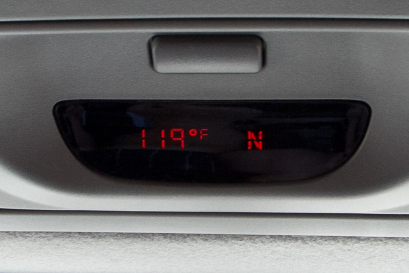

    Synthetic is also more tolerant of high heat. If you are towing or spending a lot of time in triple digit temps, that would be a good reason to run synthetic. I don't do either of those, and 5K miles is about six months in my world. I will stick with dino.
    qnyla lives in NM and has posted pictures of his truck with trailer in tow. Also, if you do the math, 300K miles in (almost?) seven years is more than 40K a year. If he's going 8-10K miles between changes, that comes out to a change about every three months. Synthetic is the only way to go in his situation.
    Another factor in high mileage stories is time. Every high mileage Toyota I have ever seen had a lot of mileage put on in a short amount of time. I think that cold starts and stop and go driving is a far bigger factor in engine wear than what oil we are using. I've seen a couple 400K mile Toyotas and Nissans that were used as courier trucks. They were only six or seven years old. Whatever cheap oil and filter was available at the quick lube place was what they used. They got started up every morning, driven all day, then shut off.
    I figure I am fighting a losing battle trying to get a truck to 300K miles when all I do with it is drive 5 miles, shut off, cool down, restart, drive 10 miles, etc. It's the starting up that kills them.

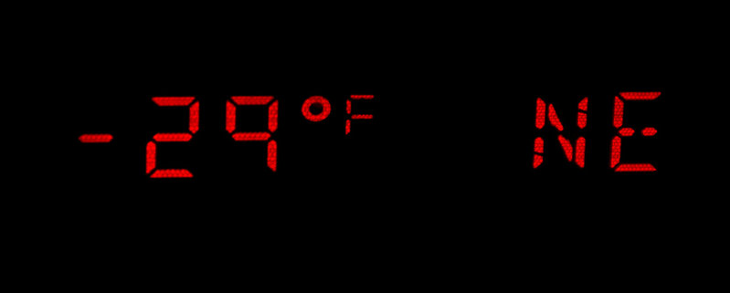

    Also better cold-flow performance, and higher film retention. This better protects the engine on cold startups in any environment.
    Cold startups, especially after sitting for a few days/weeks, are where most of your oil related wear is happening.
    Synthetic "gets moving" better than conventional, and it "sticks" to surfaces better, rather than draining back into the pan after shutdown (yes, that's WAY oversimplified).

    Cold flow is better but I wonder how serious that advantage really is? First: in clime's where it comes in to play don't people garage park and/or use engine heaters anyways? And no one spec's use of 40 or 50 weight oils anymore... I'm sure synth will be better than 20w at cold, but just how much?
