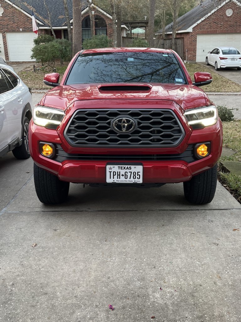

    You did a great job. They were easy to install and are exactly what I wanted.IMG_0025.jpg

    Thanks again…so are the white ones on my Gen 3 technically driving lights (drl) or parking lights?
  11. Mar 30, 2025 at 10:16 PM
    Puppypunter
    Puppypunter Well-Known Member
    Jan 4, 2020
    #315086
    2,735
    Johnny
    2019 Black SR
    They are kind of both but usually are referred to as DRL. When the DRL and parking lights are turned on, they are driven by the DRL circuit. When the low beam is turned on, they are driven by the parking light circuit (at 50% brightness).
