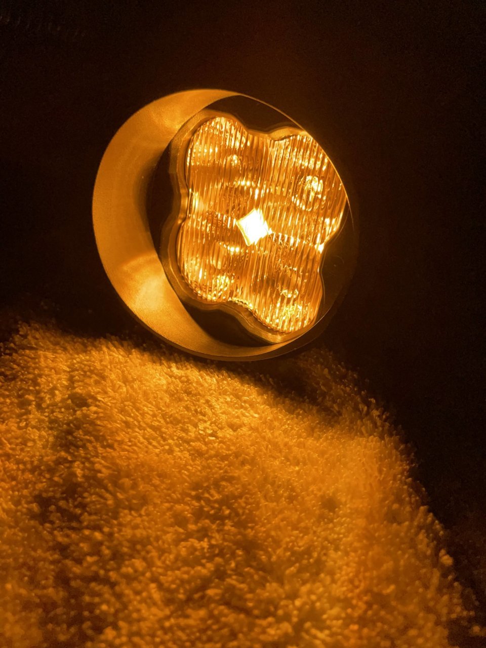

    Is the backlight color yellow or orange? I'm trying to find a matching color to pathfinder prowlrs.

    The backlight is a true amber color. This photo I took is a pretty good representation of the backlight color through a yellow lens.

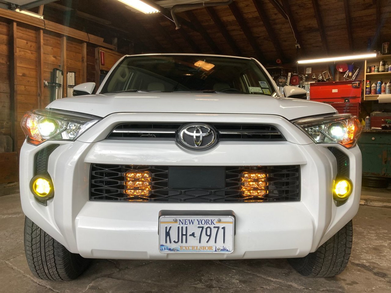

    SS3 Max fogs in selective yellow. SS5 spot beams in selective yellow with lenses swapped to clear with amber backlight.
