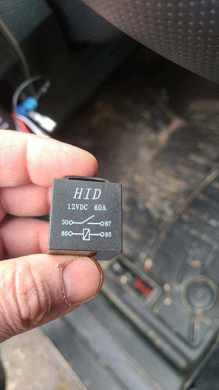

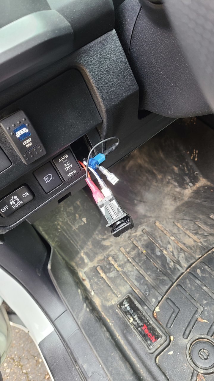

    I just came outside from lunch, and my rock lights were on, the switchlight was on, but the switch was in the off position. I pulled the relay and the lights shut off, but the light on the switch inside the truck stayed on. So i pulled the power cable from the switch as well.
    I had not turned the lights on in days. And ive had these on the truck for months with no issue.

    Probably a faulty switch. The relay wouldn’t pull in without current. And there couldn’t have been any current with the switch “off”. And since the switch had the light on as if it was “on” you can kind of rule out a short and you can rule out the relay. Try a new switch

    Seems to be the switch. Bastard.

    The switch isn’t super complex you could take it apart and take a look just need a small flathead and maybe needle nose if you got fat fingers
