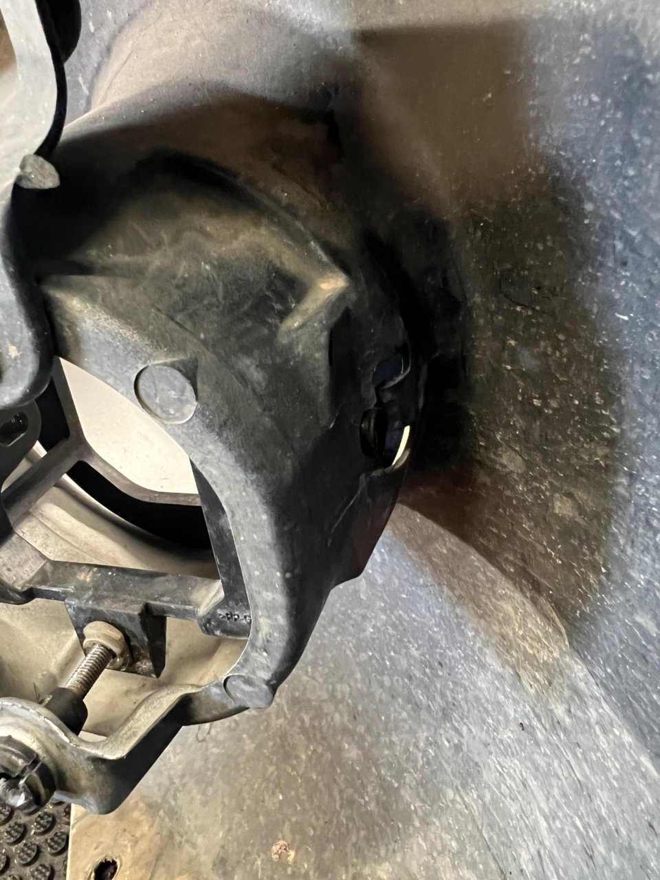

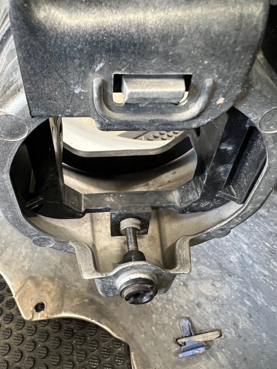

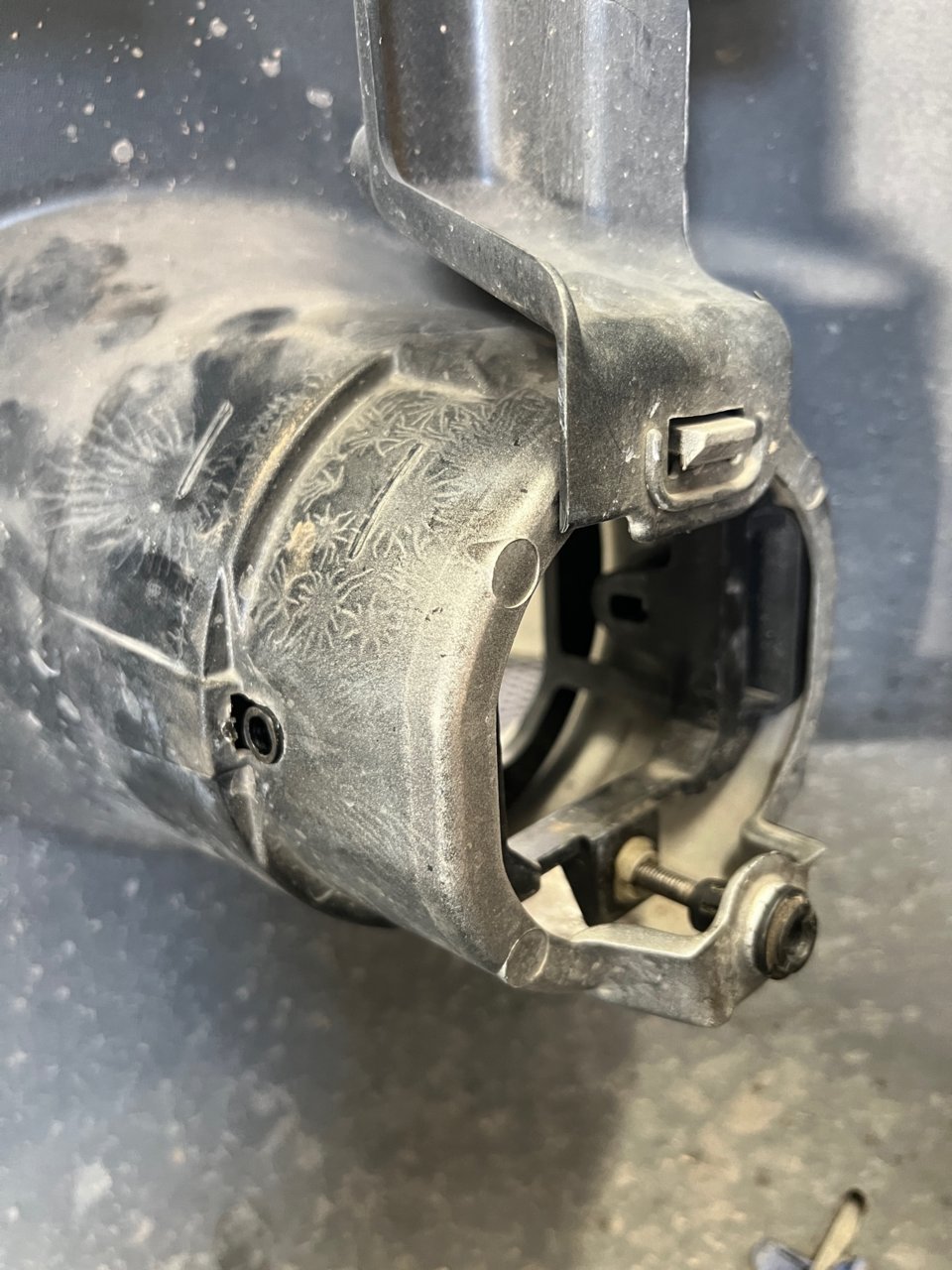

    I just wanted to see if anyone else is having issue with Diode Dynamic Fog Light Mounting Brackets not staying in place and not having enough aim adjustments.
    I contacted DD A while ago and they graciously sent out new mounts thinking I was missing hardware but now I realize that’s that’s not the case. The mounts are pretty flimsy but they can’t take all the blame Toyota's design is nothing short but weak. The screw that pushes or pulls the light up or down doesn’t allow for enough adjustment. Also the side mounting hardware doesn’t secure the light into the bumper it’s more or less just holding the light to the mounting bracket. Toyota clearly designed this from a factory install that a worker can just push a fog light into the bumper and plug it in and be done.
    Am I missing something or anyone have a better design? I might make some brackets that secure the light to the bumper.
    I do know my driver side mount has some damage from a dealer yanking the light out at some point.

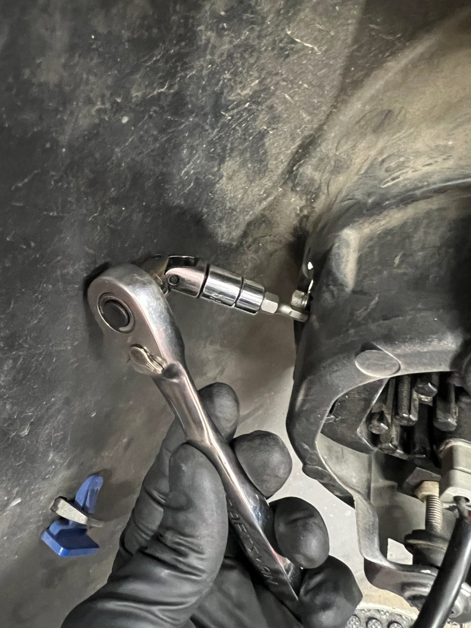

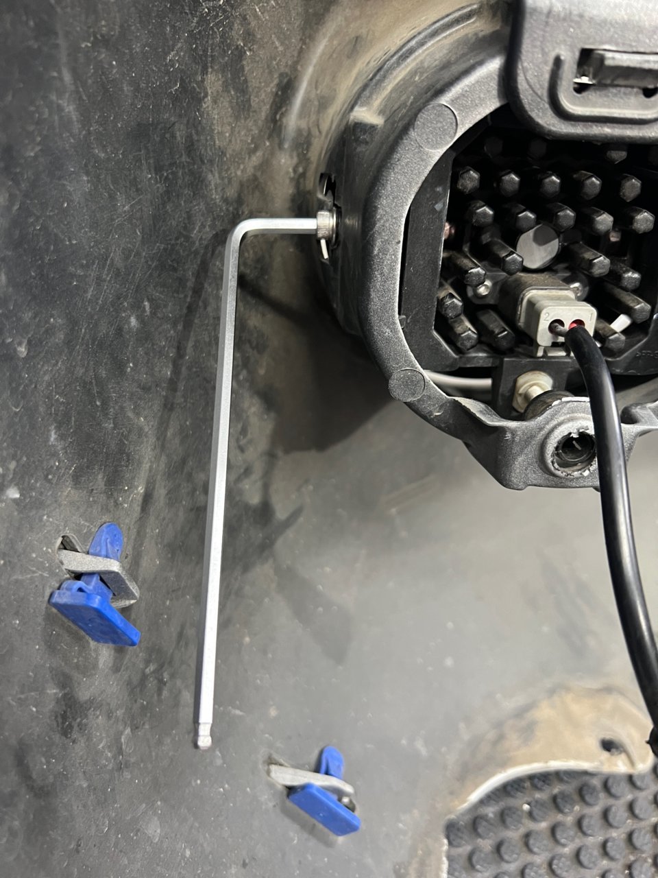

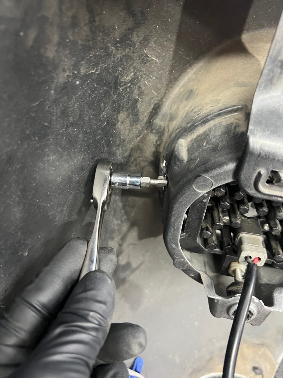

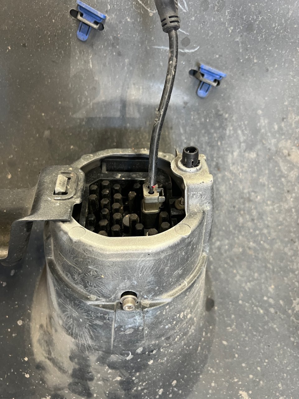

    So I went ahead and installed a two washers on the DD bracket to help push the DD bracket Holes out further. Then I went ahead and installed some large fender washers on the outside where the allen head bolts screw into. This put pressure against the light and help prevent the light from moving around in the bumper housing.

    Mine were super loose and kept moving and even though the bolts on the sides were super tight. I just realized that after I removed the bumper and looking at the lights, I had the plastic insert that holds the light adjuster screw in backwards :annoyed:. That definitively helped with getting them aimed correctly. When I pulled everything out I flipped them and started re-installing before I took photos. I do wish they offered something that held the light in tighter and better prevention from coming out.

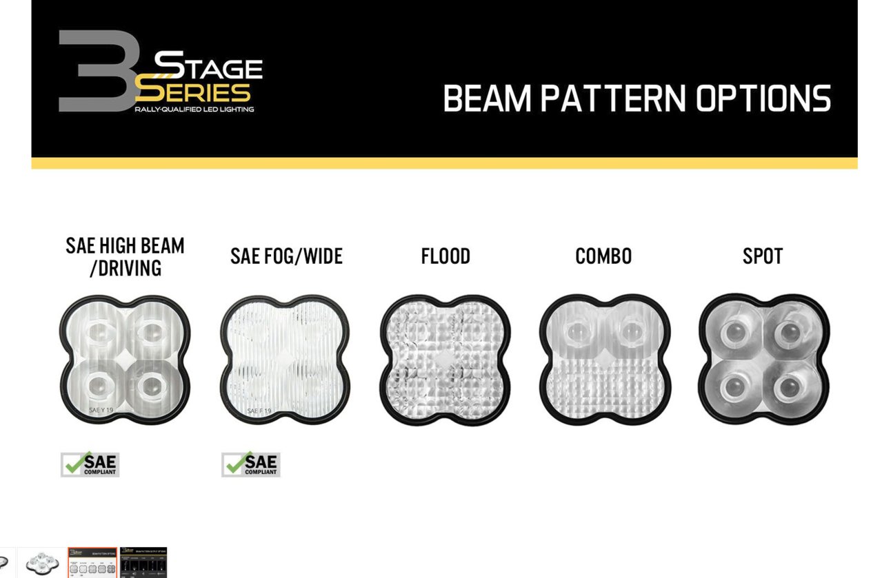

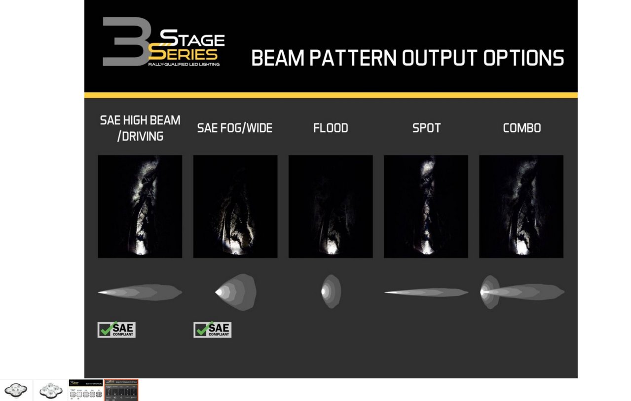

    I have the driving light which doesn't use the diffused panel, and I just checked the DD website and will probably purchase the Fog Beam Pattern and try those.
    Direct From DD"Colors. SS3 LED pod lenses are available in clear material, producing white light, or a selective yellow filter. You can change the color of your lights by swapping out the lens, but please note that changing colors may not be perfect with these lenses, because different LEDs are used depending on the color of light you originally purchased. If you purchased White pods originally, they have 6000K white emitters, while Yellow SS3s come with 4000K emitters."

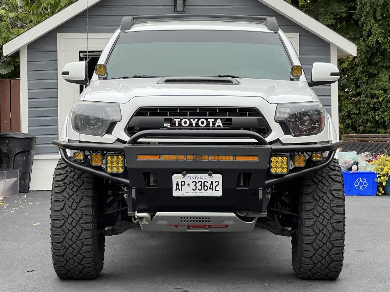

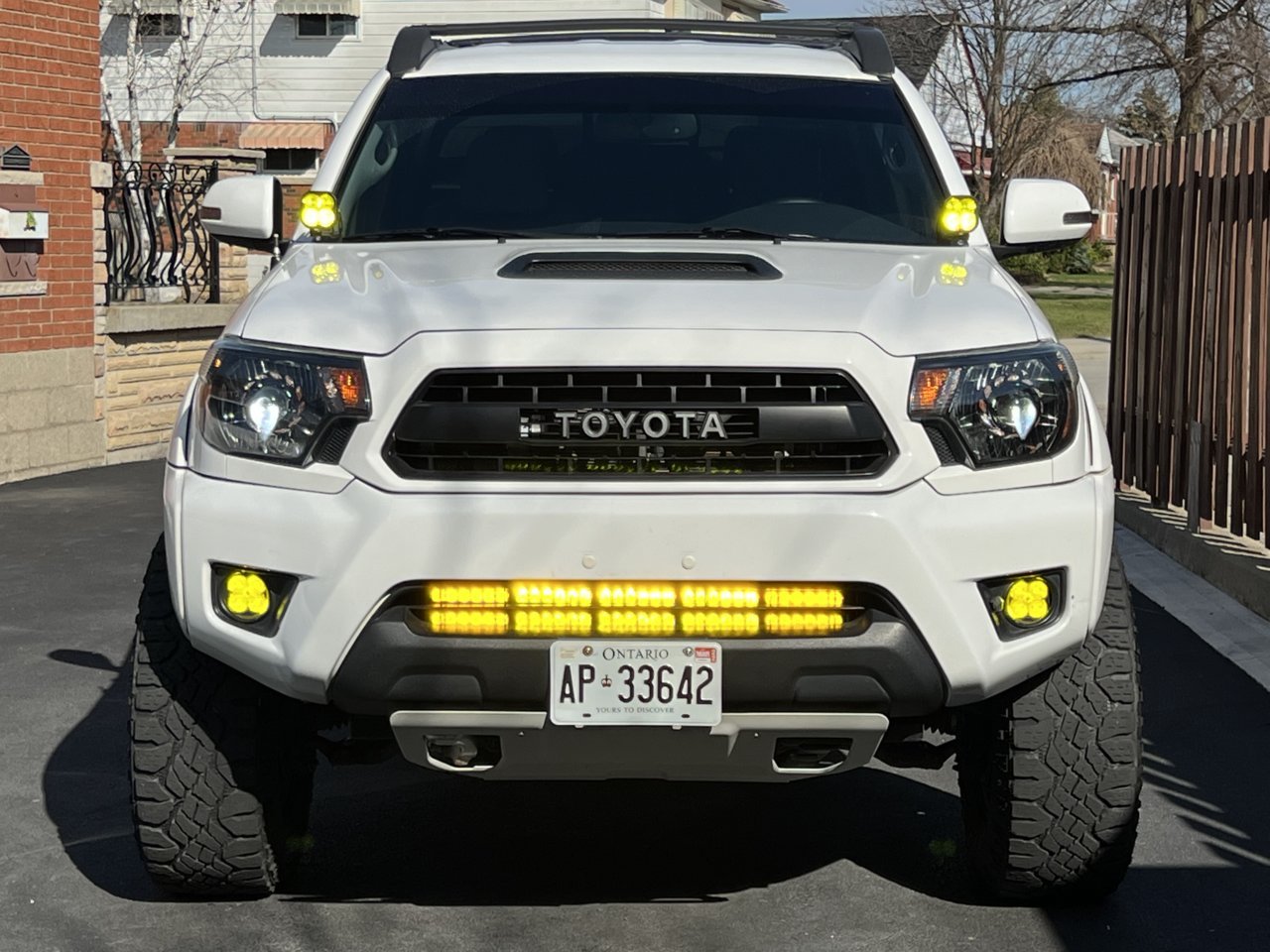

    Dual DD SS30 Bars.

    I would agree they don't have the cut off that I thought they would. I'm going to purchase the fog light lens cover or the combo and try that and see how it goes.
