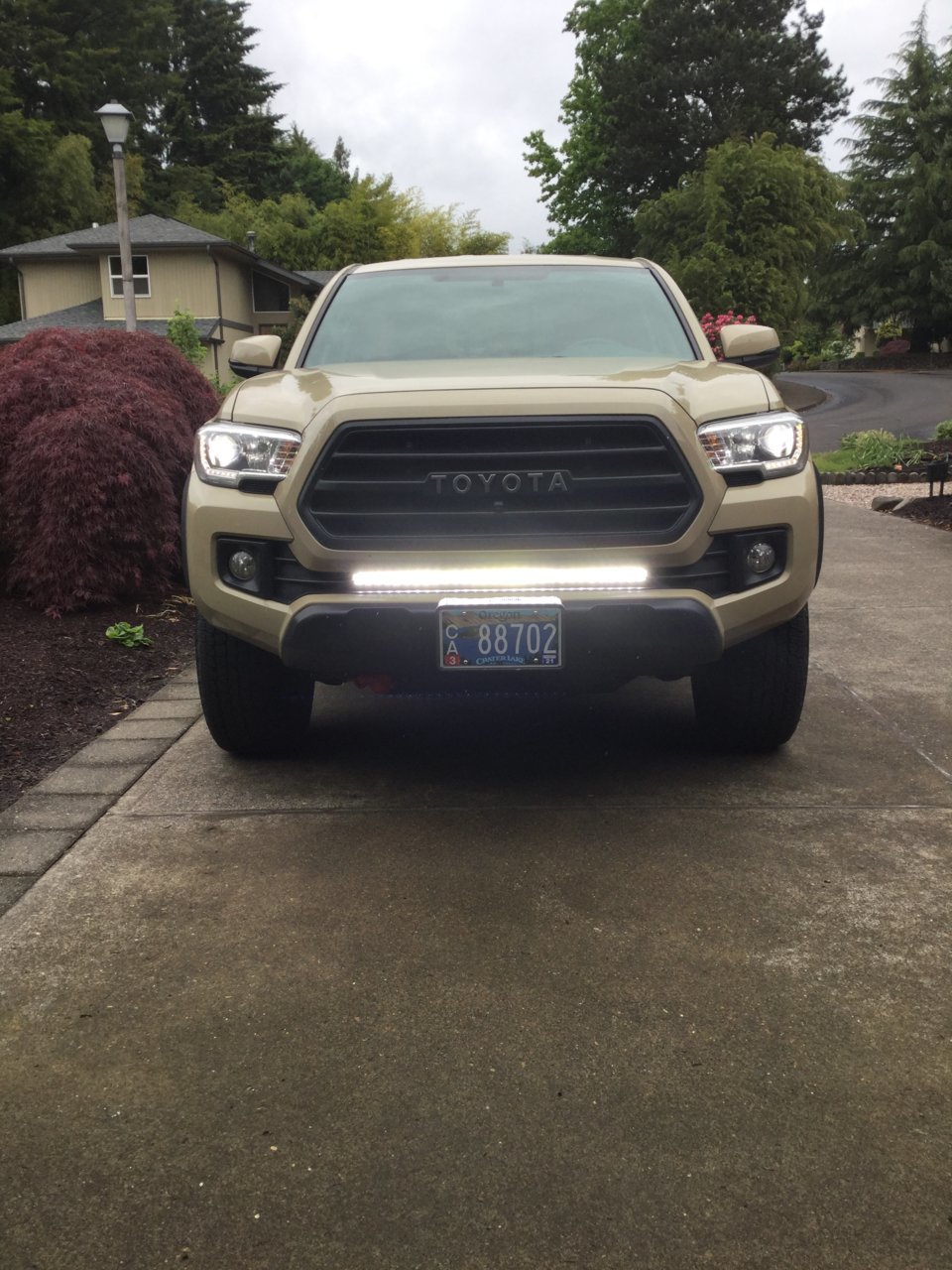

    If you are going to be “off-road” at night then I’d go with the light bar. Insanely bright and obviously not for city/hi-way driving but you can knock down a small plane!

    That looks clean! Thanks for adding the photo!
