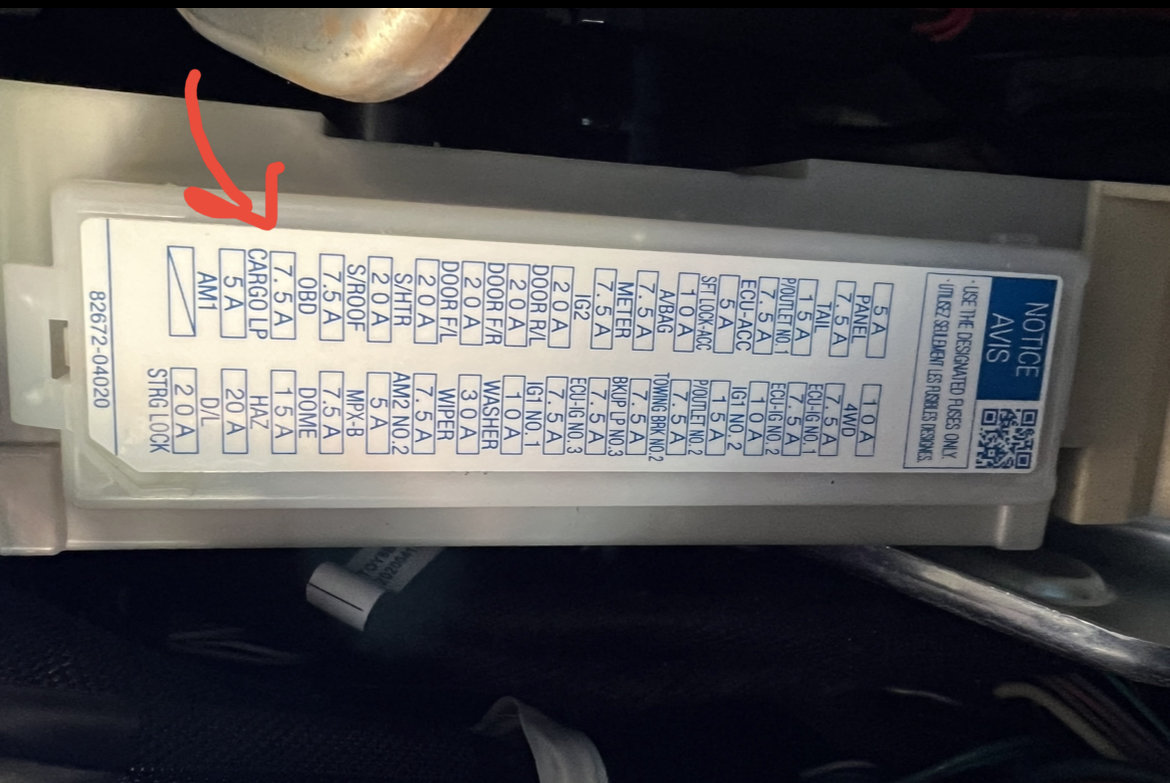

    I haven’t done this mod but if my English is accurate this might be the fuse you are looking for.
    to test simply remove the fuse and see if the cargo lights still work.
