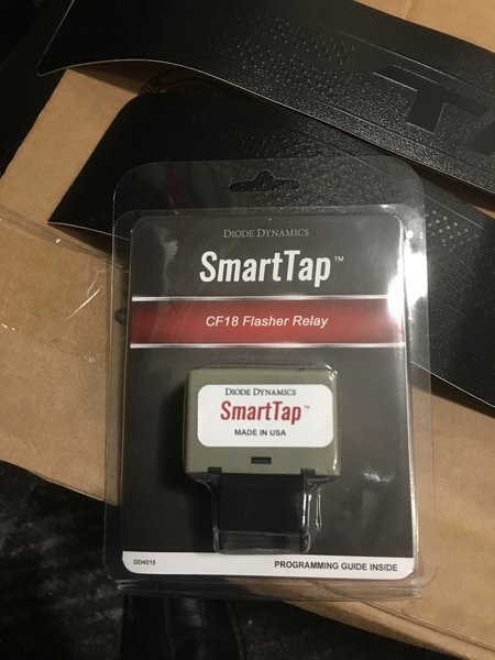

    Arrived today!!!

    Beyond the pita of getting to it, it was fairly simple. Lol. I could get to it on the back of the fuse panel, but I didn't have any leverage to pull it out, so I popped the lower dash and fuse panel off. Snapped out and in. It stopped the hyper flash and works well. Thanks Bruce for handling it. Btw, the programming instructions are on the package and it is fairly simple to do. Key on/key off, hazards on/hazards off, turn signal up/down.

    Hope this helps some with the hazard function. The arrival and departure are already set in and changing the number of flashes on single tap are easy enough.
