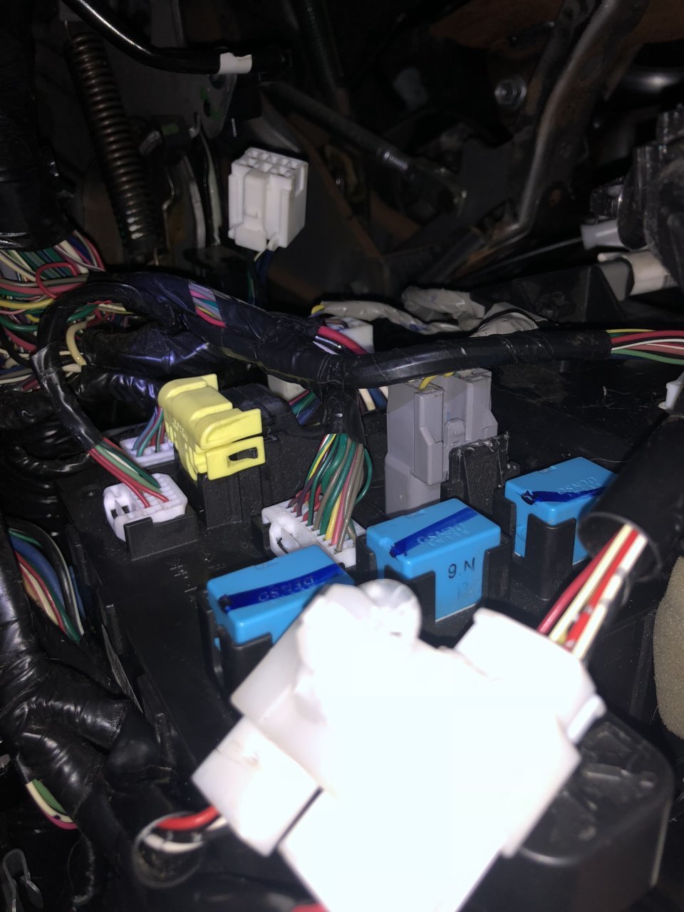

    I just did my install of the Smart Tap and the front turn signals wouldn’t work. I assumed I missed a plug and fussed around for a while before putting the OEM plug back in. Things are back to normal with the front signals now.
    Has anyone overcome anything similar?
    I called Diode Dynamics and they instantly issued a warranty, so that’s great.
    I removed the large grey plug just behind the row of blue relays and installed the Smart Tap in that location. That grey plug was just free in the dash at that point. That’s the right way to install it, correct?
    (That white homeless plug in the background had me distracted for a while thinking that went to the front signals and I had missed reattaching it, must be a feature my truck doesn’t have)

    You goofed. To eliminate the DTRL, you have to install a grey plastic jumper block. That's why your front turn signals don't work.
    Look at post #82 in this thread.

    I don’t have DRL

    Is that essentially the same way you remember it looking?
    I read in some DRL threads that 2012s with the towing package have extra stuff plugged in up there that resemble the DRL module.

    2010 Speedway Blue TRD Offroad
    mines like this.

    Don’t scold me! Haha. I did read it. It’s not clear to me is all because I don’t have DRL.
    I do have the towing package which adds some extra garbage up there. Not clear on the function of any of it.
    Or are you saying that there’s DRL equipment Toyota arbitrarily installs even though I don’t have Day running lights?

    Hmm, guess I’ll try removing everything @Muddinfun is pointing out and hope I don’t lose trailer lighting or some other functionality.
