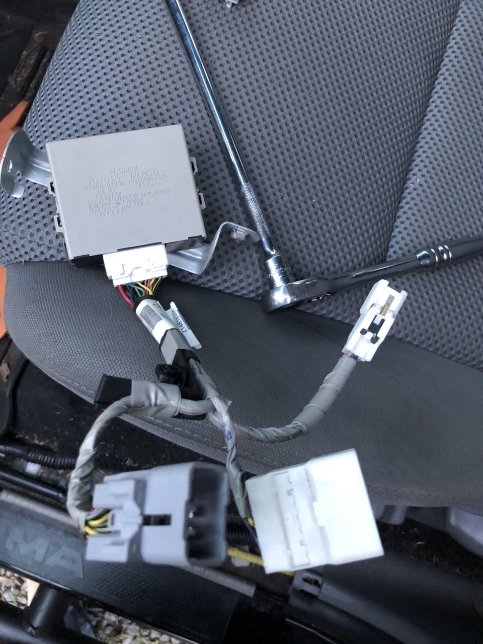

    If your truck looks like this, you have dtrl
    IMG_1726.jpg You have to buy that grey plastic jumper block from Toyota. If your truck has that 3 way wire harness with the flasher mounted to the right side of the fuse box, you have DTRL. I can't help it that they don't work.

    So, are you saying you have the Y harness as pictured above and the FLASHER only has 8 pins?
    Somehow, I think you are counting the pins in the harness and not the pins on the flasher.
  7. Nov 27, 2018 at 9:08 PM
    #127
    Muddinfun
    Muddinfun Well-Known Member
    Apr 17, 2017
    #216500
    7,489
    Just to shed a little more light on this, the DTRL flasher has to control the front and rear turnsignals independently so that it doesn't end up with rear facing DTRL. The jumper cap connects the front and rear turn signals together so that the 2 flasher outputs of the non DTRL flasher control both front and rear turnsignals.

    So, add this to the list. If your a 2012 with the towing package and have this tan 3plug relay it will preclude you from simply plugging in the Smart Tap in the 8 pin slot. This may apply to other years with the towing package as well.
    Diode Dynamics asked me to report my findings so they can update the website.
    This divides the thermal load between the front and back signals similarly to the DRL flasher.
    I’ll have more information on functionality of the trailer circuit at a later time. AF2FD921-9811-49F9-B954-7F50F7FA277C.jpg

    The issue was I found something that looked similar to what the guys with day runners have.
    I had one guy insisting I had day running lights when in fact I did not. So I cross referenced the part number and figured out they use this module to divide the electrical load when a trailer is attached.
    I removed the module and installed the previously mentioned jumper block, but I haven’t yet checked what turn signal power I’m getting to the trailer plug.
