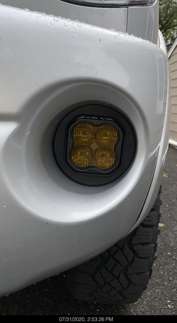

    You won’t be disappointed in the kit. I have one in my 2010 and it was an easy install. Probably 30-45 minutes. I used to have the BD lights with a metal bracket and after a year it started to rust. There brackets are plastic and look stock

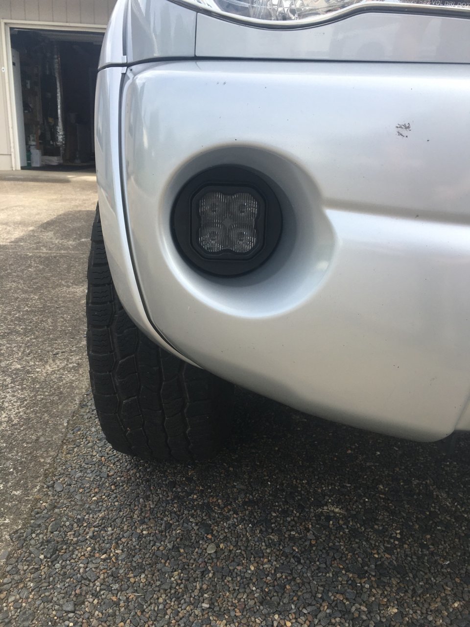

    I installed a set about 2 months ago. It is very easy to peel back the fender liner. To do the whole job took me just under an hour and I am not fast with this stuff. Diode dynamics has a good video on their website. F5619BEF-4DD5-48FB-BA7C-83C074DBA908.jpg
