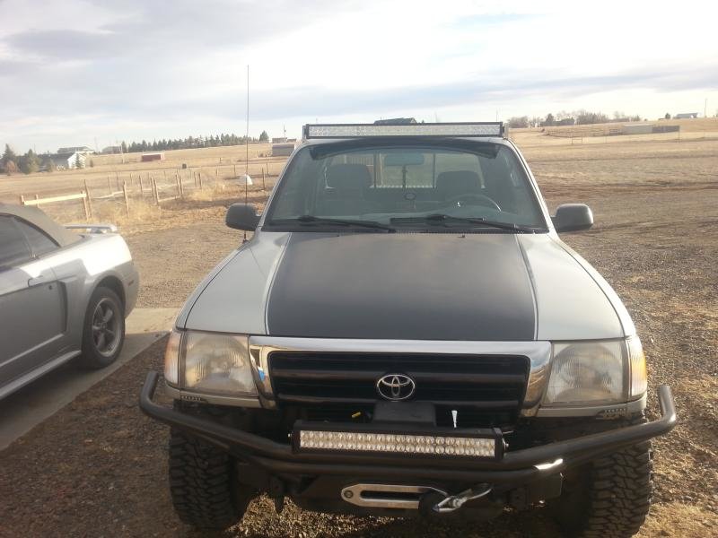

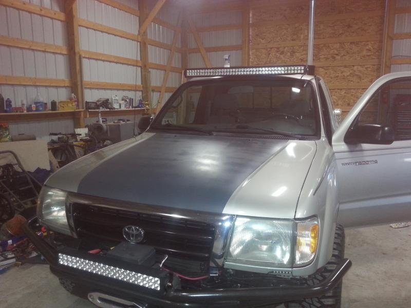

    I spent a couple hours this weekend and finally tinted my front windows, much nicer on sunny days. I also decided to see how going flat on my hood would look, and hopefully it will cut some glare from the lightbar as well. It looks flat black in the pics, its actually the dark grey color of plasti. It's still drying in the pics but I might need another coat to even things out. Still not bad for an hour and $10.
    If it holds up to the carwash I might end up doing the rockers as well. Until I get around to adding some extended flares my sides will keep getting rocks and mud thrown at them.

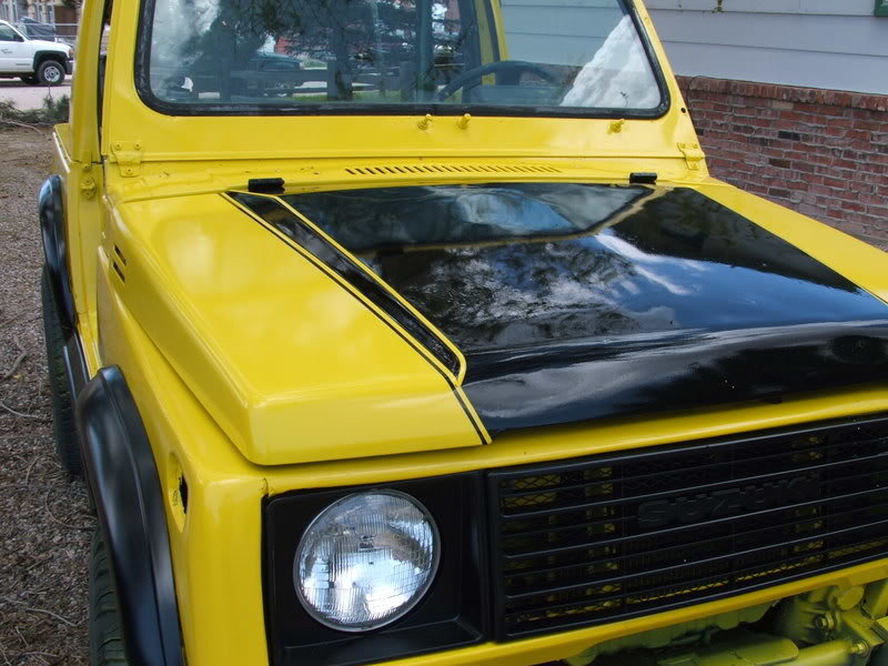

    Start out with "fine line" tape, it's about $5 at any auto paint store. It's a smooth plastic, comes in 1/8 an 1/4" sizes. Usually use it for painted pin stripes instead of stickers later. It's really flexible so you can do shapes etc, lay down the base color, tape where you want to mask and then top. I don't get too fancy but it's how I do things like this.
    After that, yeah with plastidip you have to work fast. It needs to be dry enough to stay but not so dry it's actually rubber. When you're doing several coats... it's a bit of a toss up. I actually had a 1/4 pin strip 1/4" on either side of the hood paint. I made it to the last 6" of the other side when I was peeling the tape and lifted the stripe, so I peeled both entirely. Irritated me :laugh: I did 3 coats total, each one just barely off tack before the next, had the whole thing done really fast, and I still lost the stripes.
    Other than that when you peel take you bend it as far back on itself as you can, if you pull up you're going to lose your edges.
  9. Feb 12, 2015 at 3:44 PM
    Indy
    Indy [OP] Master of all I survey.
    Sep 15, 2013
    #112518
    2,582
    Redid the pin stripes, turned out pretty decent imo.
