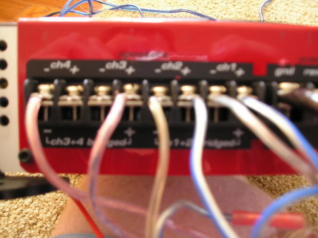

    Aaaah, I've heard about this bridging. Would it be possible to bridge two channels together, say 3 & 4 (not for speakers yet, just directly into each other), and use channels 1 & 2 to power the sub woofer? Or am I missing the point here...
    Sorta like in this picture?

    you would simply connect your sub to the CH 4 Negative (-) and CH 3 (+)
    and no please don't connect channels together like using a jumper. You will not get any additional power.
    Some amps you can do something similar but thats called strapping and thats very amp specific

    Bridged your probably only going to see 150-160wrms. Bridged load of 4ohms, and that sub is a single 4 ohm so your ok to do so. Don't expect this to be any forms of WOW but it should fill in some bass
