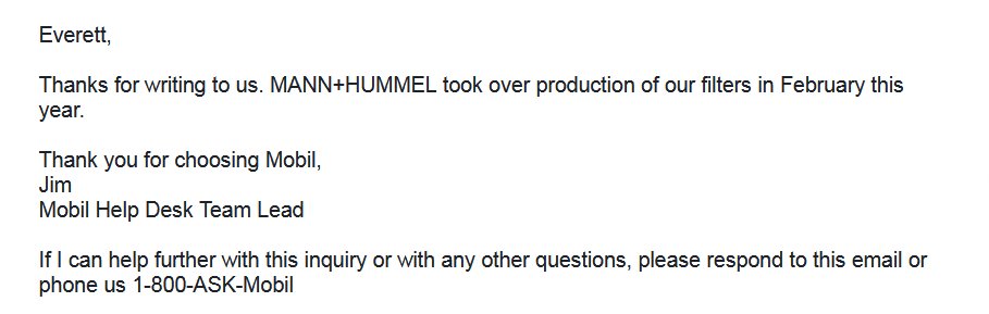

    Hey Bruce Mobil 1 filters are no longer made by Champion Laboratories, Inc. since February of this year. I emailed Mobil 1 and this is what the man said.

    Ah, OK, thanks for the update :thumbsup: I guess that's OK ... I've never seen any MANN filters around here, but when I've looked through the numerous websites like 'Top 10 best oil filters' ... And there's a ton of them out there.. LOL! ... MANN filters always seem to be in the mix somewhere.

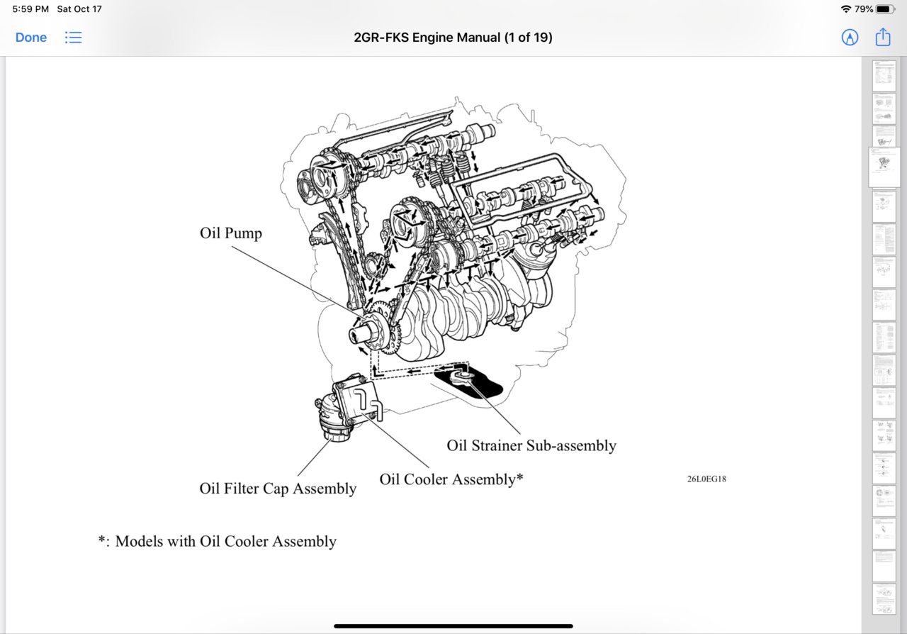

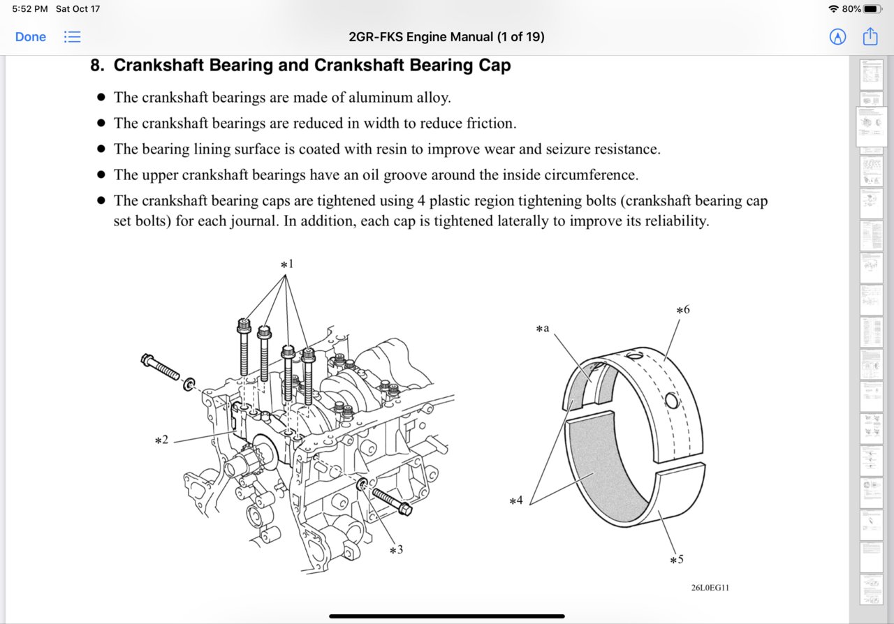

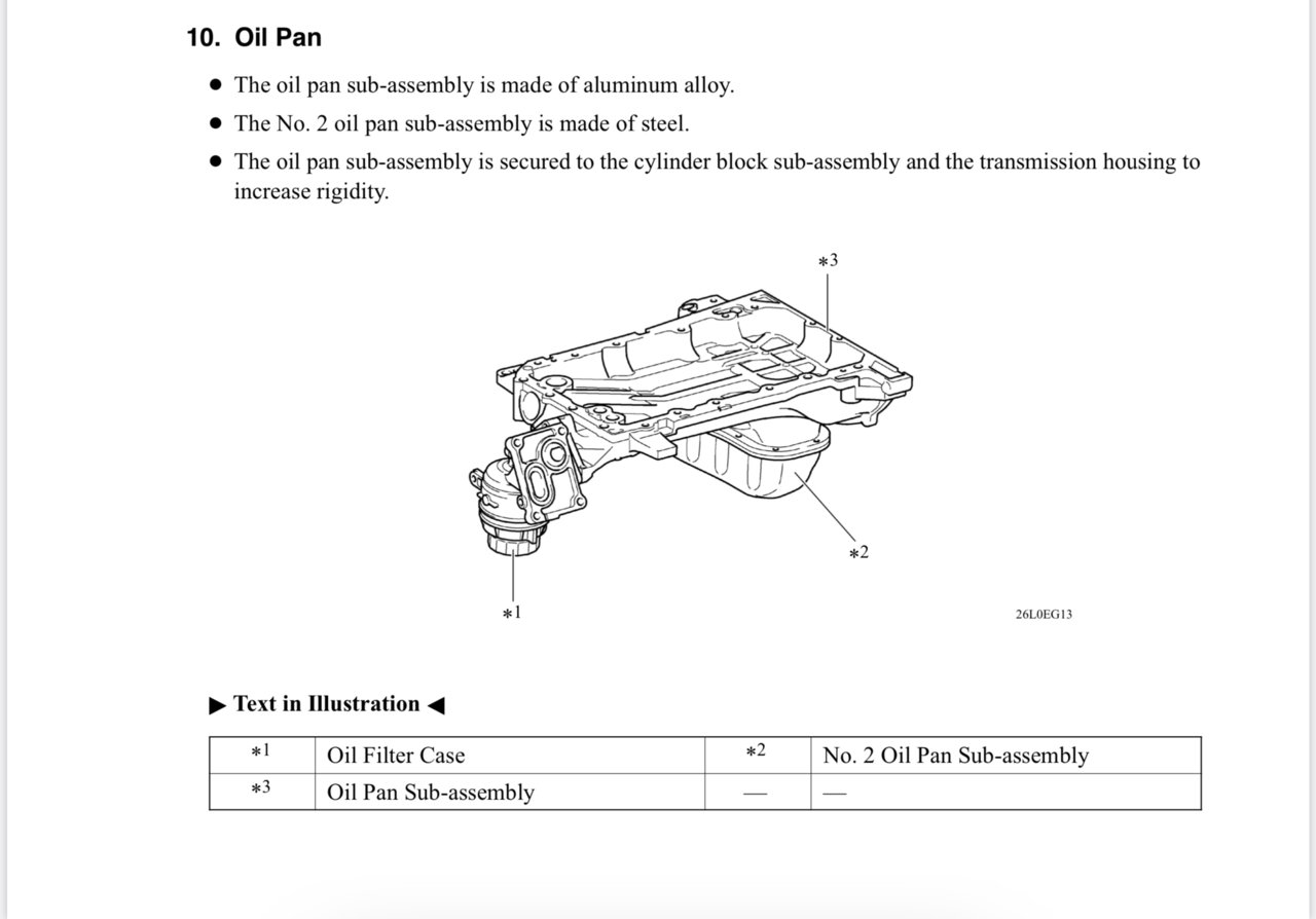

    It looks to me like the bulk of the 2GR-FKS’s engine oil is sufficiently below where the crank and rods spin. An additional .2 quarts of oil probably won’t reach those rotating components. (Sorry for the poor editing).

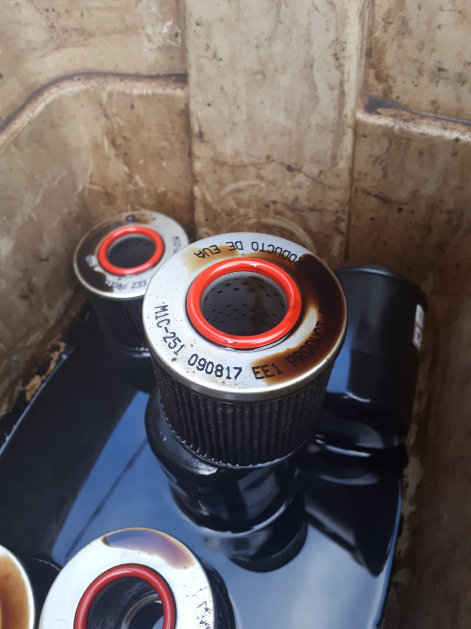

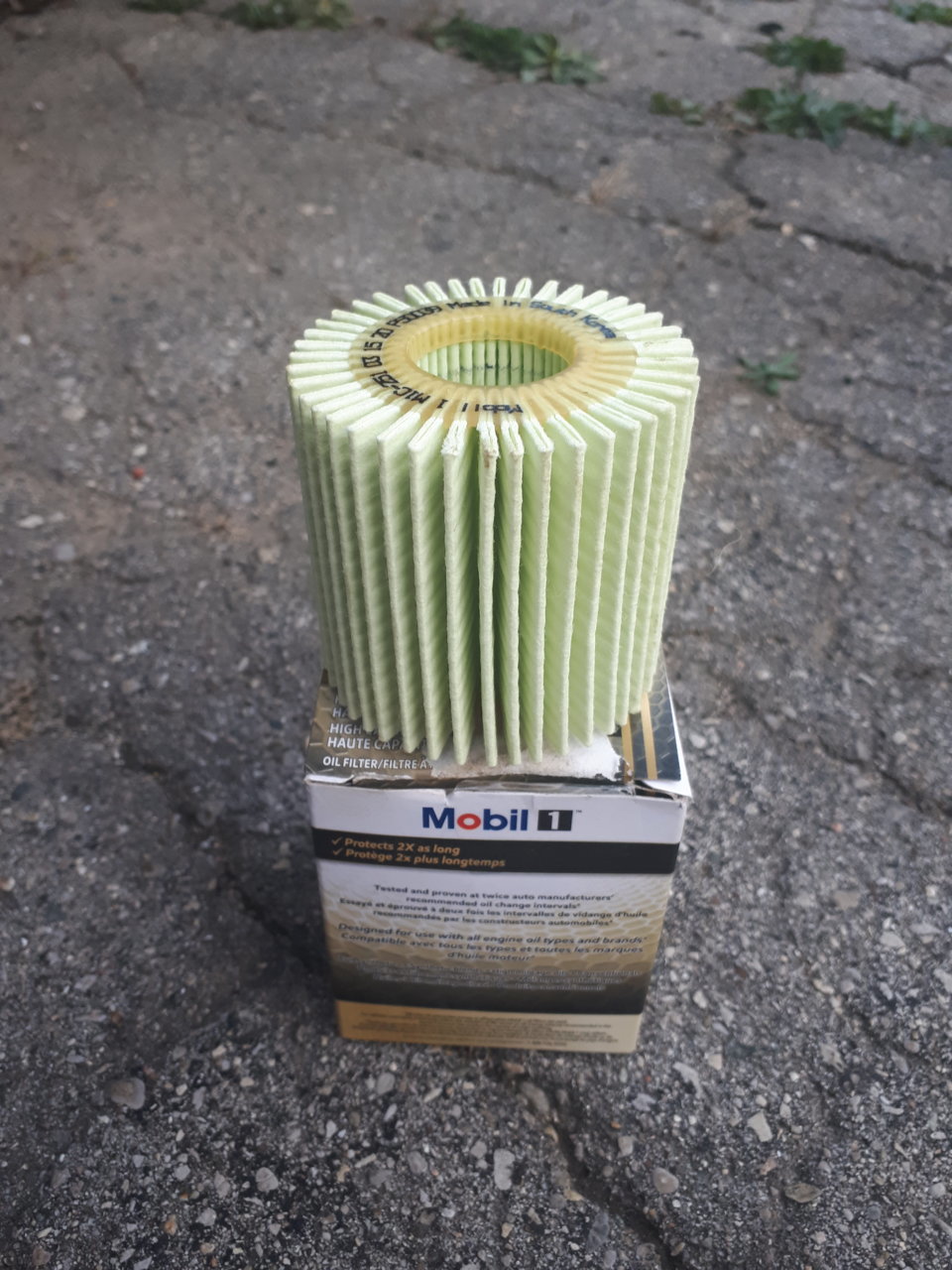

    When I replaced my Mobil 1 filter a couple weeks ago I was surprised. What I got was not at all like what I had. The new Mobil 1 filter was made in South Korea. The Toyota TRD filters do look like the old Mobil 1 filters.
