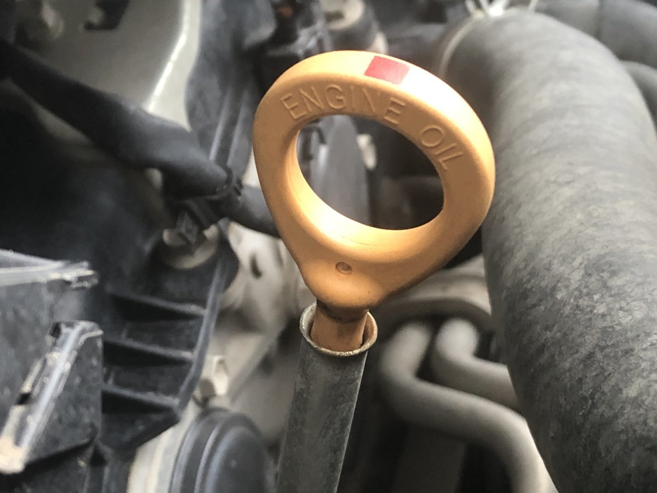

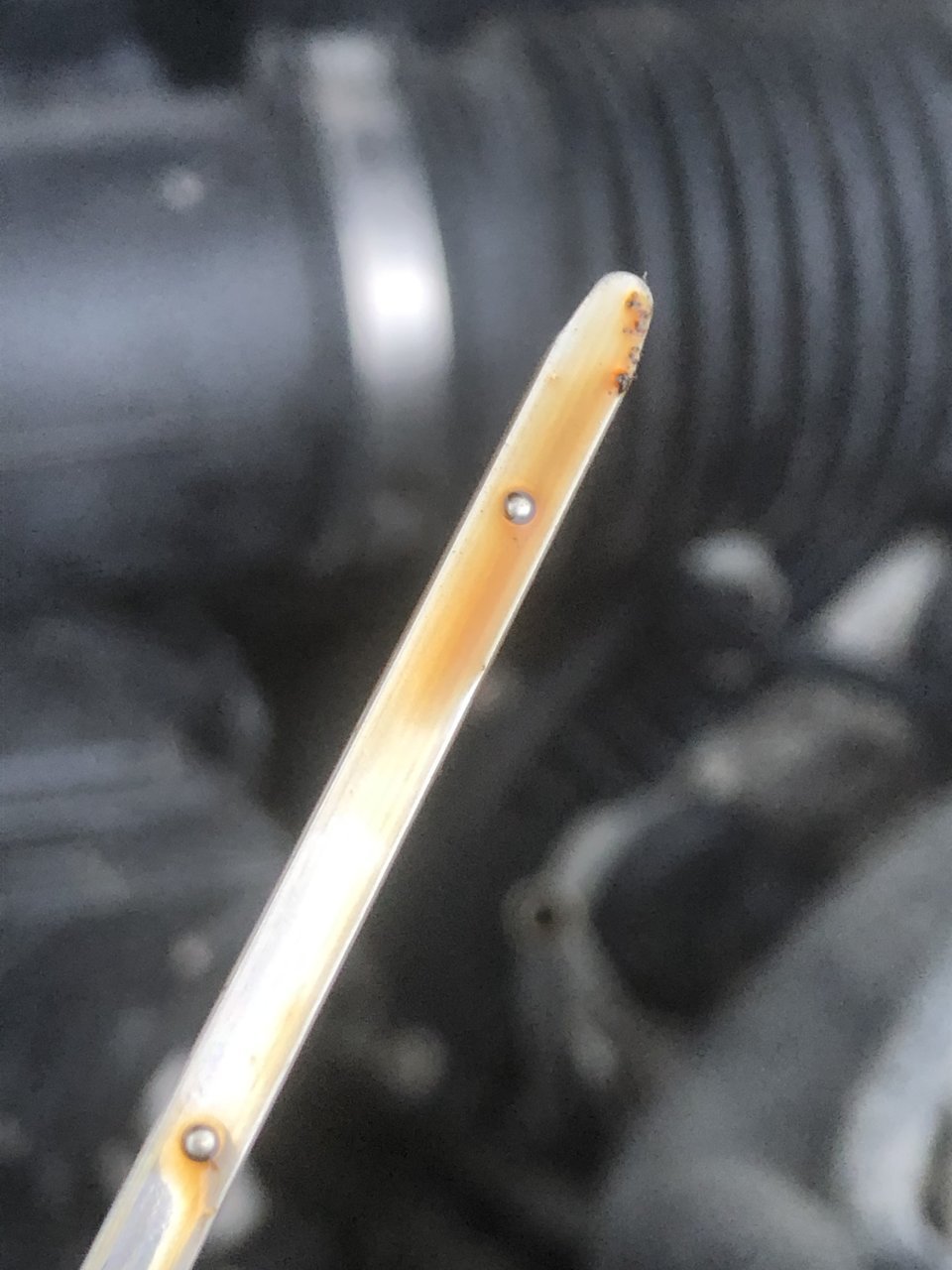

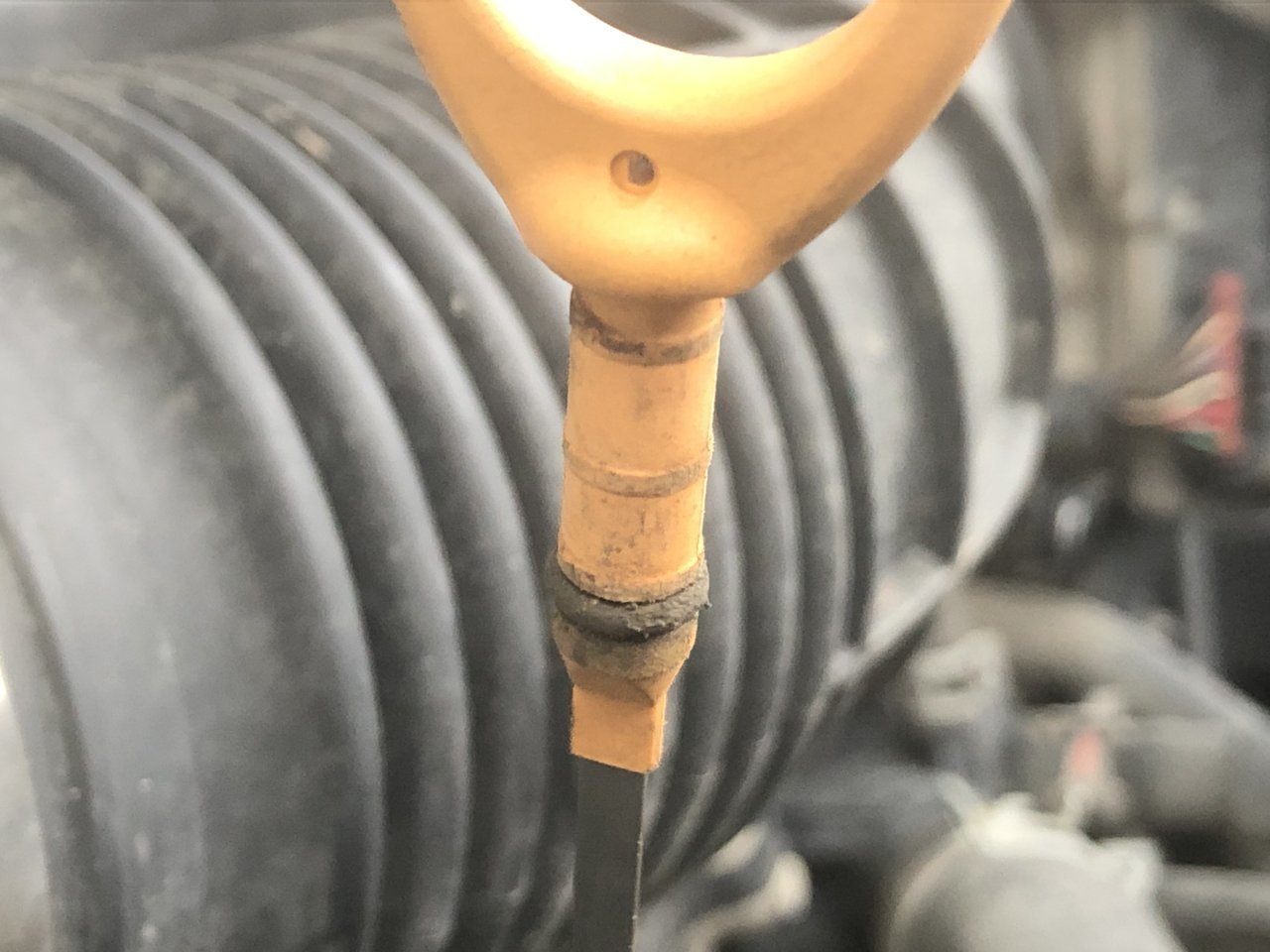

    Went to check the oil on my 3rd gen Tacoma last night and noticed the dipstick was about half an inch from being fully inserted. It was extremely tough to pull out, I had to twist it while pulling out and it finally came out. The plastic tip and o-ring were filthy and I noticed there is grit/dirt on the tip every time I pull it out. I also can’t push it all the way back in, the o-ring gets stuck on the tube.
    Could dirt have got into the engine? Where should I go from here to flush it all out? If I slide the dipstick back and forth I can hear some fine sediment inside. Worried about driving it and trying not to panic!

    It probably wouldn't be a bad idea to speak with whoever changed your oil. It's o ringed due to the crankcase having a slight vacuum from the pcv system. With the stick out, it's sucking outside air in there.

    Get a new dipstick from the local dealer. Drain your oil. Check for anything that shouldn’t be there. Fill back up.

    These responses....your filter took care of whatever may have gotten sucked in. Change the oil. Change the filter. Go to the parts store and get a new o-ring. Lube it with fresh oil. Enjoy truck.

    I'd clean the dipstick tube with a thin brush, clean the dipstick and inspect the oring, pour a little oil down the tube to flush it, change the oil and pcv filter. I wouldn't worry about it after that.

    The dirt was probably just around the dipstick and fell into the tube while you were checking the level. I'd just clean the dipstick, maybe change the o-ring just in case and change the oil.

    Your o-ring looks like it was still fully sealed. Maybe a miniscule bit of trash got in. Change oil, dump some oil down the tube, change filter. You're alright. You don't need a new dipstick. Mine is hard to actuate as well.
