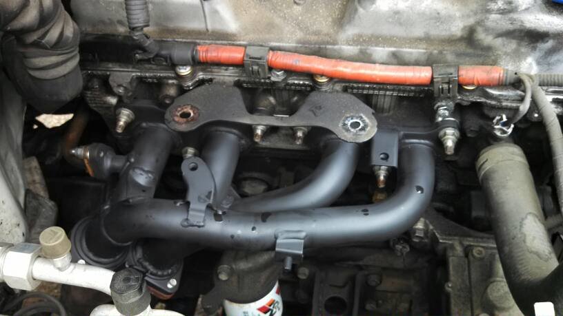

    Just replaced my exhaust manifold with the kit from Deathcougar. It was flawless. uvy9yqaj_800bdf6ba871eb264a6da46efaade5139686e622.jpg

    Looks like that one bolts to the catalytic converter. Eww. The bolts on mine are rusted to hell. Good luck with that :beer:

    This mini header is $335 shipped from these guys in WA. That includes the header, manifold gasket, egr gasket, downtube gaskets, studs and nuts for the downtube and egr tube, and nuts for the manifold bolts in the head.
    I did not replace the heat shield, no effect.
    All the parts included are Toyota and make for a easy install.
