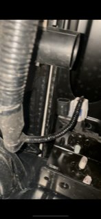

    Hello, I am trying to connect an OEM wire connector and I was wondering if the unused plug under the truck can be used to connect the trailer lights. If not, what should I use?

    I believe it is an sr without the tow package.

    That be the connector (BE1) to the Parking Assist Sensors and also to the Cross Traffic dopplers at the corners of the bumper which the SR doesn't have.

    oh okay, thank you
    caribe makaira
    , if anyone has a good link to the harness it would be greatly appreciated.

    etrailer.com for the 4 pin (ground, tails, & combined turn/stop)

    You can usually buy a harness, I think curt makes one. They just plug right in to your taillights, no splicing plug and play.

    So this cannot be used for trailer lights?

    HELL no...:burp:

    So plain and simple the sr5 4cyl. is not plug and play? Haha!
