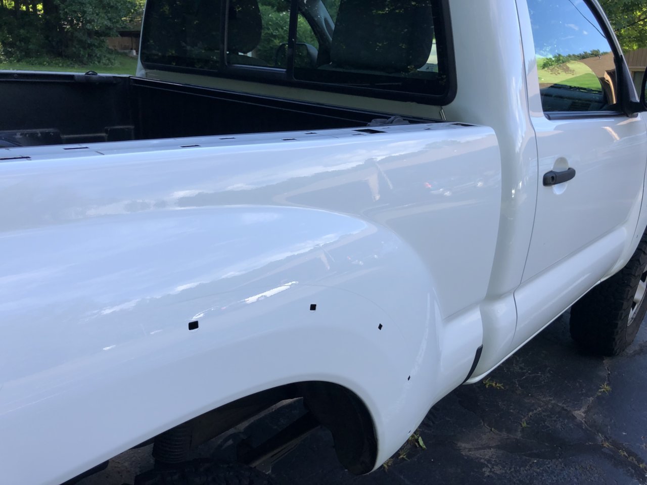

    Thanks for the tips.
    There is still stuff in the paint at the bottom of the truck where the flares were and on the rocker panels.
    I also had to remove the "line" that was left behind when I removed the flares. For that I used AllClean+ diluted 20:1 and a Mr. Clean Magic Eraser (it also removed the fingernail scratches behind both door handles).
    I did a test on the R/F fender because I have a new one (already pained) to put on, current fender has a big dent in it.
    I bought some Adams iron remover and Adams ultra fine clay bar and detail spray (I was using a medium clay bar from Chemical Guys and it kept falling apart). Stuff should be here this week. I'll do the final step of waxing/polishing after my new fender and bumper are installed
    Here is a picture of my bedside. The front of the bed is very smooth now using the clay bar, glaze and then wax. I removed the plastic at the top of the bed because when I was washing the truck, black stuff was coming from that area. I still need to remove the line.
