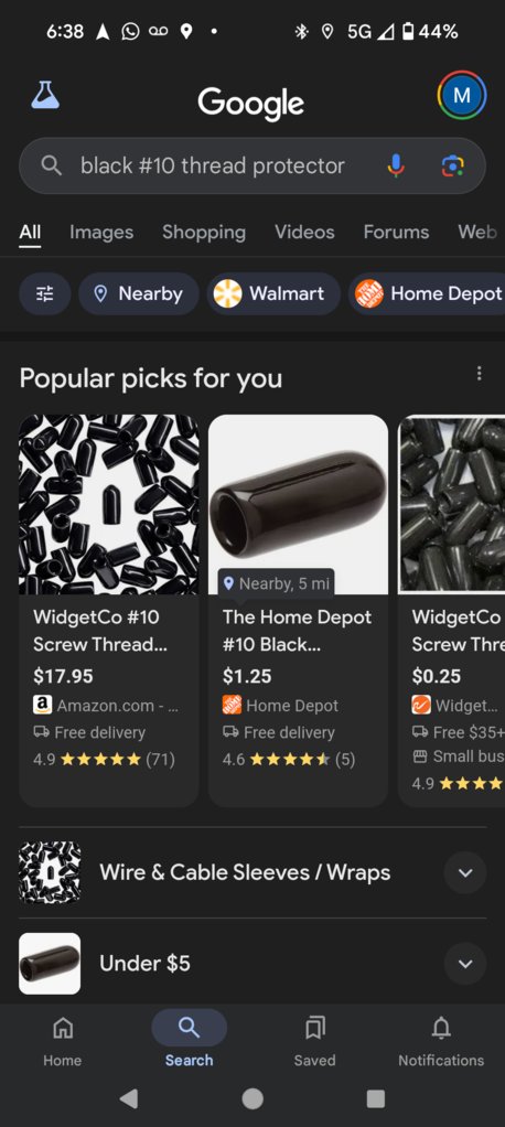

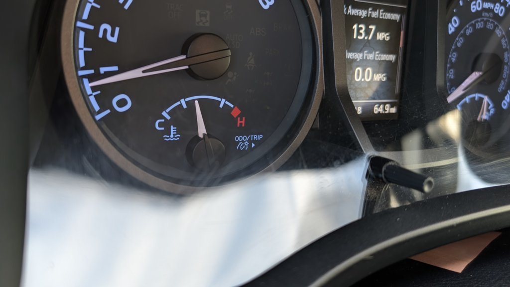

    I think that i found a solution. Take a #10 rubber thread protector and cut the angle needed on one end. Then cut an opening on the closed side. It's pretty snug, so I stretched it out a little. Should work to keep more dust from collecting.
    musicisevil and Stuck in VT like this.

  14. Nov 19, 2024 at 6:11 PM

    Its Black, that's a plus. Should work a bit better than the cut at an angle heat shrink. I like it.
    The only problem I see with the cutting of an angle on either the heat shrink or thread protector(cap) is that the knob does have to be turned slightly and pushed in and out, thus causing an opening. Albeit temporary and in my case not very often.
    Spend much time in the fastener section of your local ACE? I think I have every color of thread protector they sell.

    I wonder if a #12 rubber thread protector would work any better? I never use the trip setting so I don't mind that it's tight... It still goes right to left just fine for brightness though. I was also thinking any sort of rubber tubing could work if you find a better size. I'm sure you could find black or clear to work.
  18. Nov 20, 2024 at 1:59 PM
    #58
    Mlofthou
    Mlofthou Well-Known Member
    Jun 24, 2022
    #400052
    46
    Mason
    2021 tacoma
    I stretched it out over the top of a pencil a couple times to loosen it up.
