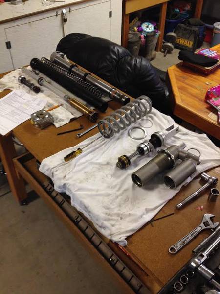

    In the middle of doing a full rebuild on my suspension, I have a 2003 CR250, replacing all seals, most bushings, and found I have Race Tech gold valves so I figured might as well revalve while I have them apart. I miss my old suspension so going with a FMX/Supercross, A class, standard age/height/gas tank for 165lbs. So wondering if anyone else does their own suspension work or tuning? It seems tough but actually pretty easy once you have taken them apart and see how they work
    In pieces :D
    Shock valve stack, rebound on the top and compression on the bottom

    I used to do my WP's until I took them over to see what GDR in Wilkesboro, NC could do with them. Huge difference. Now I just play with the clickers. :D

    Generally I would agree and have always had someone else do it too. But I had the same bike a few years ago and just copying the suspension it had before, I havent ridden on it yet, so I may be wrong but I think it will be pretty easy :eek:
