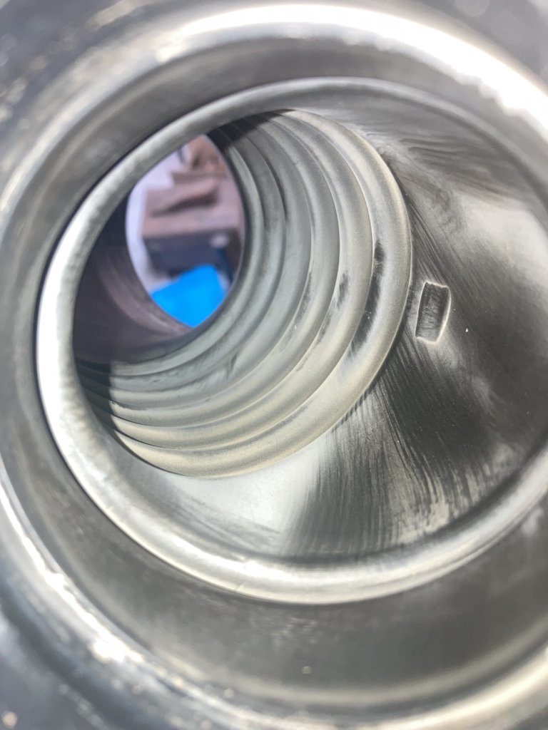

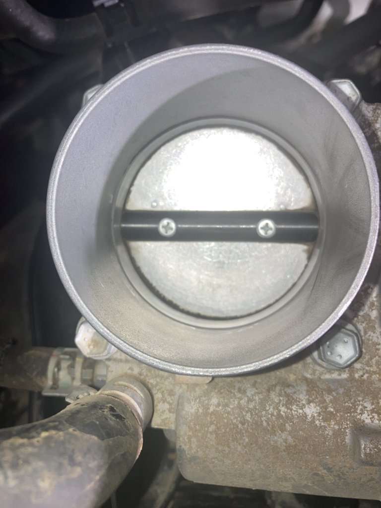

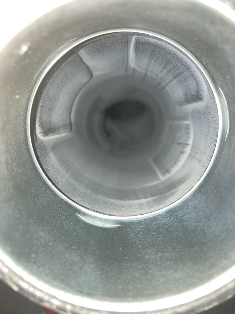

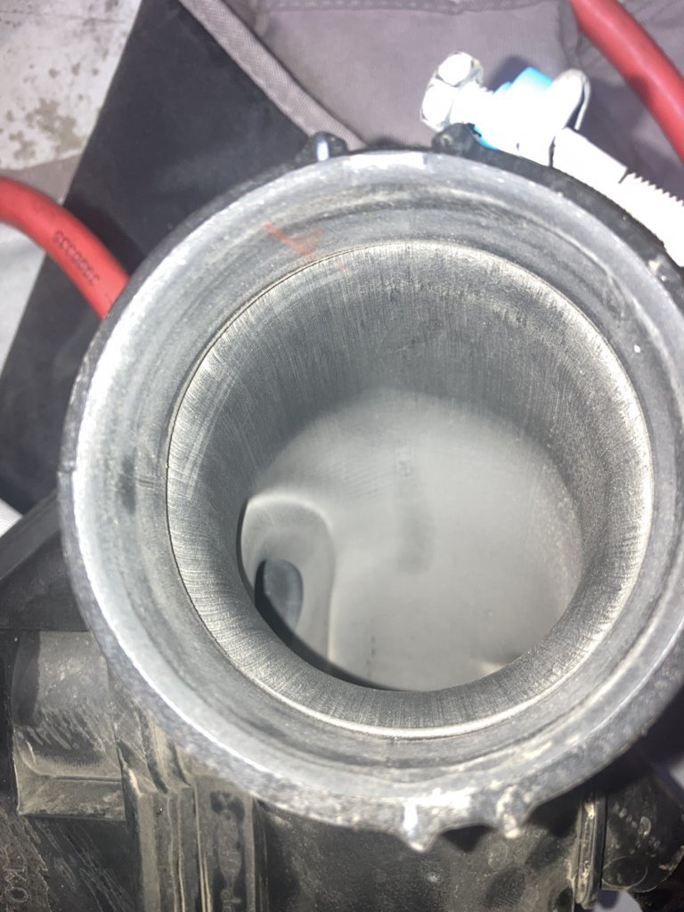

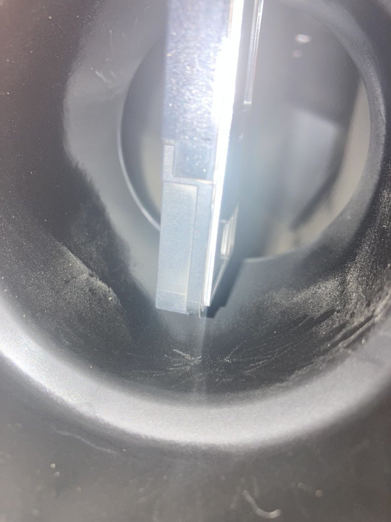

    Today I noticed it was hunting a bit at idle, so I opened up the intake and the portion downstream from the filter was rather dusty. Think a thin layer that will cake on your finger if you wipe a couple inches… I don’t know how much dust is too much but I’d imagine it’s any amount. The MAF was a bit dusty so I blew it off and reinstalled. I pull the whole intake and noticed about a 1/16” of black residue surrounding the throttle plate on the TB. The long part of the intake that goes over the engine also had a tan hue to it.
    Should I be worried about this? The dealer said they’d take the truck back tomorrow if I want to bring it back. They’ll squash the loan and give me my old car back. I know my way around a car a little bit by I’m no mechanic, as you can tell. Will be back in a bit with some pictures.

    I’d foolishly wiped down some of the dust from the parts, but here’s some pics. Oil on dipstick looks fresh. I’m assuming the dealer swapped it. The pan plug all clean with caked mud in the surrounding area

    Also, inside the wheel well cover is SUPER dirty and dusty. Plan on cleaning that out if end up keeping this thing. This truck definitely saw its fair share of work.
    Is the oil quality relevant because of dirt or dust getting in the PCV inlet? Outlet?

    Just a thought that if the intake had a ton of dirt and dust some could have made its way into the engine. Oil/filter changes are cheap insurance.
    I don't think you have much to worry about. Just keep up with regular maintenance.

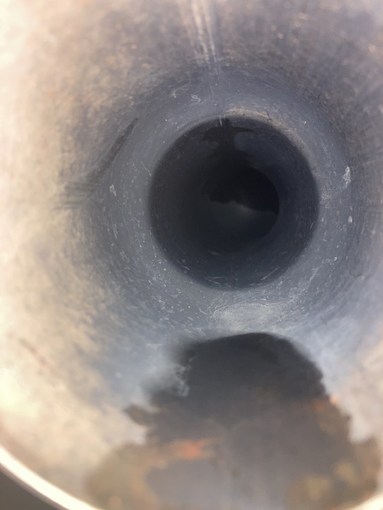

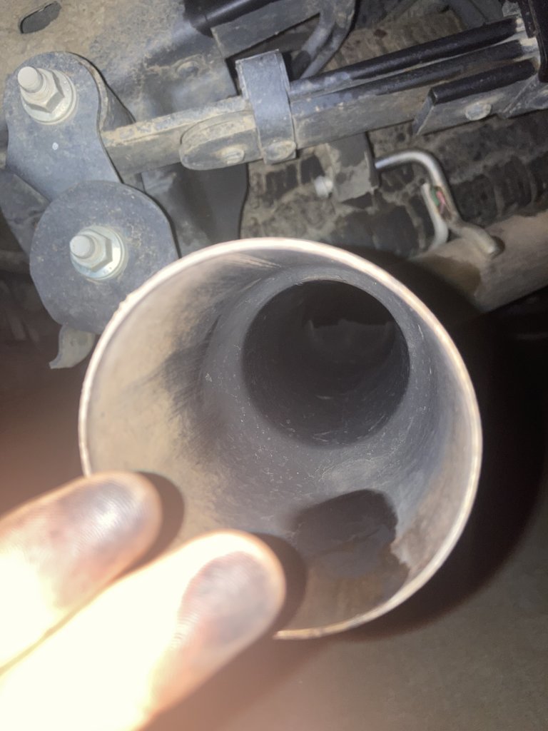

    Does it smoke?
    Tail pipe sooty oily or black?

    Negative, light soot on the inside, nothin outside, no smoke comin out.

    Pics of exhaust. Looks and felt a lil slick, no CEL tho

    I’m pretty sure it’s fine.
    Chew and robman872[OP] like this.

    It’s fine, just make sure it’s properly sealed, do the maintenance and enjoy!
