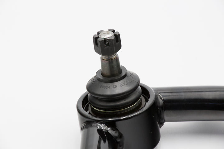

    Zoom in on the Elevate BJ.
    MOOG

    I stand corrected, the Elevate versions use Moog ball joints too per their website photos.

    So I don't know shit about ball joints, but what am I looking at on this picture, to identify moog ball joint?

    Zoom in on the picture and you'll see "MOOG" embossed on the rubber boot of the ball joint.
