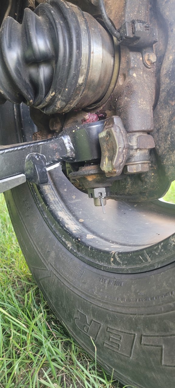

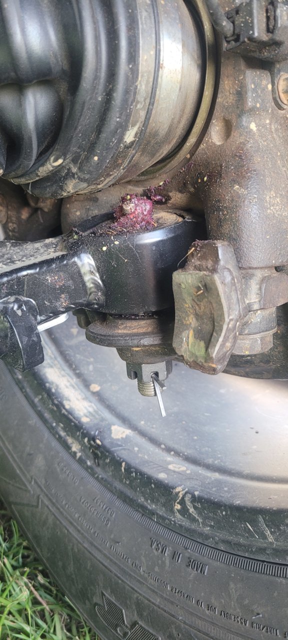

    I had factory LCAs on it as of yesterday. I don't understand if these DK LCAs are the same as factory they should have bolted up the same way.
    Here is some pics

  6. Jun 19, 2021 at 4:53 PM
    2000prerunner23
    2000prerunner23 Well-Known Member
    Nov 29, 2018
    #274262
    906
    steve
    My concern is that ball joint cup will rip away from the lower arm with a hard hit. That cup doesn’t seem to have any gussets or an overlay , welding it firmly to the arm.
    Also also, if you are going through all the effort for stronger aftermarket lower arms why not get something made out of 4130 , beefy with large uniball pivots . Camburg lowers for example (all uniball pivots) . If you don’t mind spongy flexible ploy bushings frame side, TC makes a boxed uniball lower too. The uniball will also provide for more misalignment before you bind up.
    that drop down bracket might not be so bad . Is that spindle made of forged steel or cast ? If it’s cast I would remove the drop down bracket kit with spindle and all . Run the stock spindle reinforced with aftermarket upper and Lowers.
