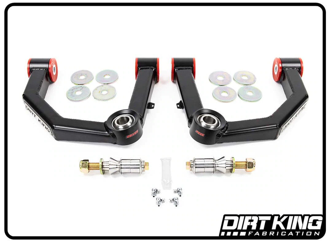

    Hey guys,
    Just curious to get feedback from anyone who has installed either icon billet, camburg kinetik, or dirt king heim UCAs. I currently am running Dirt King Boxed UCAs with standard poly bushings and love them but need additional adjustability in my UCA for additional caster with my desired tire and current wheel offset. I’m not wanting to drop over 1k for icon or camburgs but haven’t seen many people running the dirt king heim UCAs. These don’t seem to come with the spacers included in camburg or icons kits so I was curious about the additional caster they claim to have over their other two options. Thanks in advance! Pictures for reference:
    What I’m currently running:
    What I’m inquiring about:
