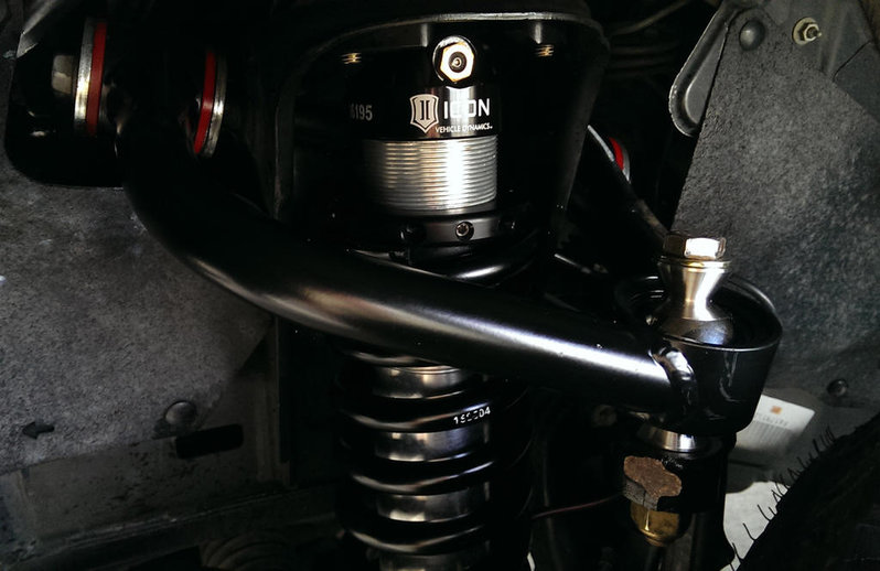

    I'm obviously biased because I have the Dirt King UCA's and LCA's but I did a bit of research before my purchase :
    • The TC's do not have greasable LCA's on the "race" model either and I will be honest I just didn't like the look of the TC regular model and the extra uniball adapter etc...just not a fan.
    • I think the Dirt Kings are more comparable to the TC "race" model. Does anyone with a stock length set up actually run a secondary bypass anyway ?
    • The TC Race model is $1799, the Dirt King is $1425.
    • The TC's "race" model are not gusseted at the cup either and the Dirt Kings are gusseted at the bushings and at the bump the TC's are not reinforced at the bushings.
    • The TC's do NOT have a built in/on steer stop location on either model so your spindles smack the LCA's and put little dents and marks in it. Your OE steer stop just mashes against the LCA and if your happen to articulate at slower speeds at lock the scratches and dents to the LCA are pretty brutal. The Dirt King LCA has a stainless steel steer stop ( looks like a gusset by the cup ) The stainless steel can be custom ground to set your steer stop as needed and will not rust after grinding in fact mine look polished.
    • Take a look at that TC logo sticker on the LCA it looks like a little kid made the sticker with a pair of scissors...The Dirt King has an awesome machined brushed stainless plate :)
    • I love to buy local and Dirt King is right here in sweet home San Diego !
    To each his own huh, just thought I'd share what I compared.

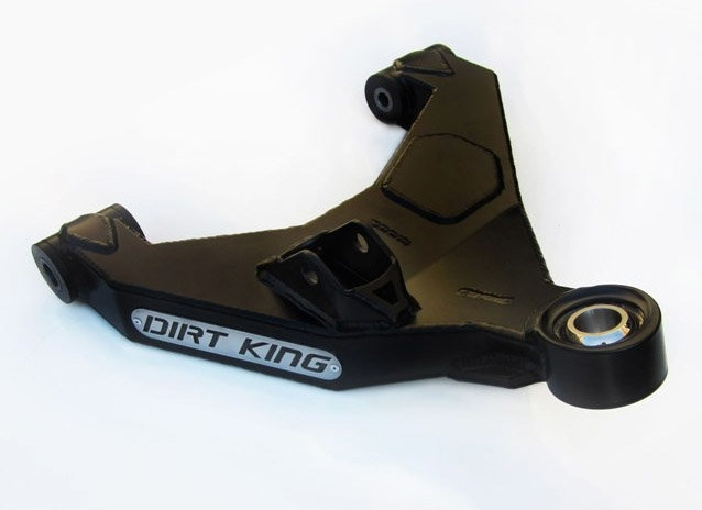

    You're 50% wrong :) The pic below is the TC "race" model for a Taco which is what the Dirt King is more comparable too IMO...and $375 cheaper.

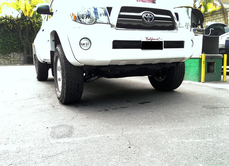

    Anybody have photos of Dirt King LCAs on a Tacoma?

    I can take a pic for you tomorrow, they look great. There is a pic of a raw set on their site which will give you a look at the shape etc. TC does say that you need a spacer for a stock length lower on their site and I always assumed it must have something to do with how much bigger the uniball set up is vs the OE lower ball joint maybe ? I have aftermarket wheels so I can't speak to that issue. You should call Dustin at Dirt King tomorrow to ask about the spacer issue.

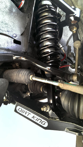

    Yes
    Here you go, sorry the flash on my iPhone wasn't working too hot.
  19. Mar 22, 2014 at 1:53 PM
    #19
    rogerkamp8817
    rogerkamp8817 Well-Known Member
    Mar 10, 2010
    #32975
    313
    Orange County, California
    2010 Toyota TRD Off-Road 4x4, AC, Superwhite
    squint0241 likes this.
