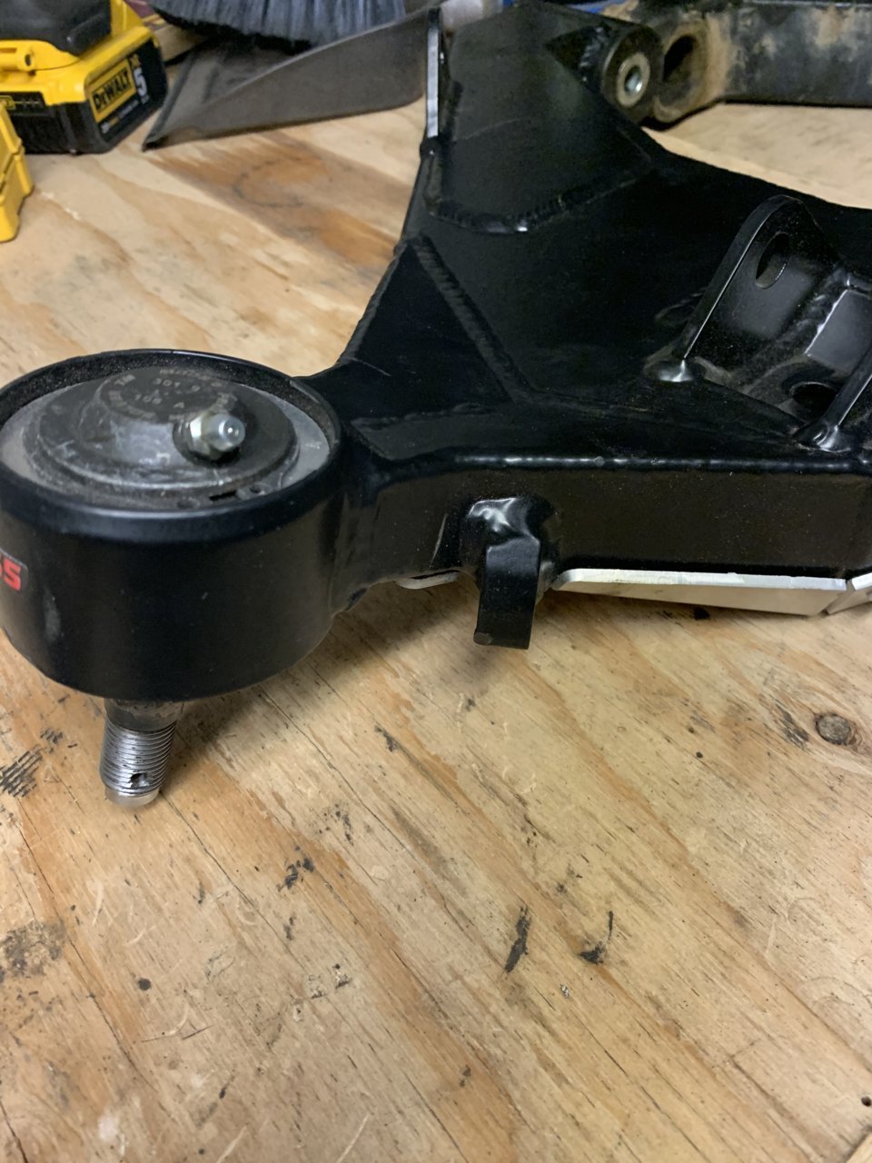

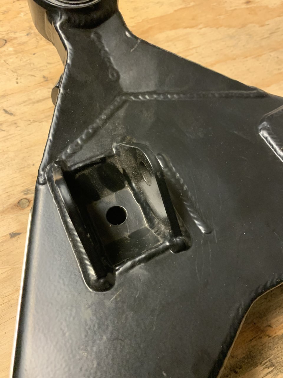

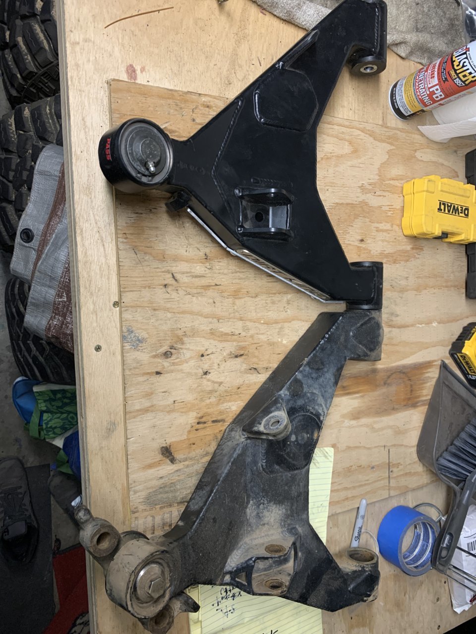

    Here are some pics of the new taper on the BJ cup and the recessed shock mount.
    deeezy likes this.

    Regarding the taper, as I have a 4R currently with taco spindles and 4R lower spindle adapter, I am quite familiar with the tapers on both UCA and LCA. The first set of DK UCAs I got were universal for 4R and taco, however the spindle tapers are different. At the time I was running my original 4R spindles. The UCA adapter seemed to fit well, it would fit into the spindle hole and seem snug when trying to shift it around pushing perpendicular to the mounting plane of the spindle, but when applying force to the top to "tip" the adapter, it was loose (this was discovered after the following issues). As a result I cracked 2 pairs of the SS adapters and DK couldn't figure it out, they just kept sending me new ones.
    I then bent my spindles and got a new taco pair, and at the same time called DK about a new set of adapters and they informed me that they now have 4R and taco specific adapters. These are quite snug in the spindle and you cannot tip the adapter in the spindle. I will also note that they just sent me my 4th pair for the UCA when I ordered these LCAs and I cracked the taco version on the taco spindle, so IDK, and yes the bolt has always been tight as I am very anal about them with the issues I have had.
    While this isn't directly applicable to the LCA, the taper may appear the same and the adapters may look to be identical, but a very small difference in fit can result in failure of the adapter and possibly other parts like the bolt if driven with a broken/loose adapter for awhile. I am not saying that they are not, but beware.
