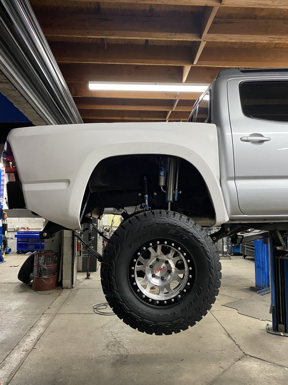

    I saw pictures of the rear spring under set up on Instagram. I noticed the frame seemed to be notched where the bump cans are which is the first I've seen on a production rear spring under. why did you decide to go that route. Is this going to be comparable to the camburg or DMZ spring under kits that are available as far and travel and set up?

    We have the frame notched to use all the travel the leaf springs and shocks will allow for. Our spring under kit can be installed without notching the frame but it would limit the up travel by an inch. That doesn't sound like much but up travel is more important than down travel and if the only trade off is slightly more work it's worth it in our opinion. I don't know enough about the other kits to compare but I'm extremely confident in our design. The kit is capable of 20" of travel and has 18.25" of travel with our bedcage and spec bypass shocks. The travel is limited around a 1/2" with the limit straps so in total it safely achieves 17.75" of travel. With that amount of travel it requires a custom drive shaft. The factory drive shaft safely allows for 15"-16" of travel. The 2"-3" of travel that is lost is down travel so it's not a huge loss in performance in comparison if the up travel was limited.

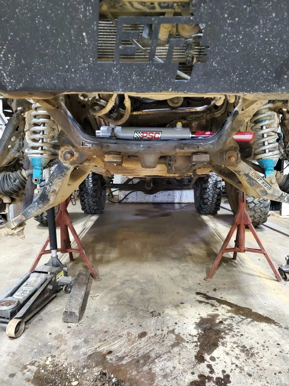

    This will be a nice game changer for the trails. Going slow through the rocks running 37s tends to wear out quite a few racks so my buddy and I figured a way to get a double ended ram to work out for us.
    Ignore the caked on power steering fluid, I drove it 6 hrs home from the last trip and went through 4 quarts of ps fluid.

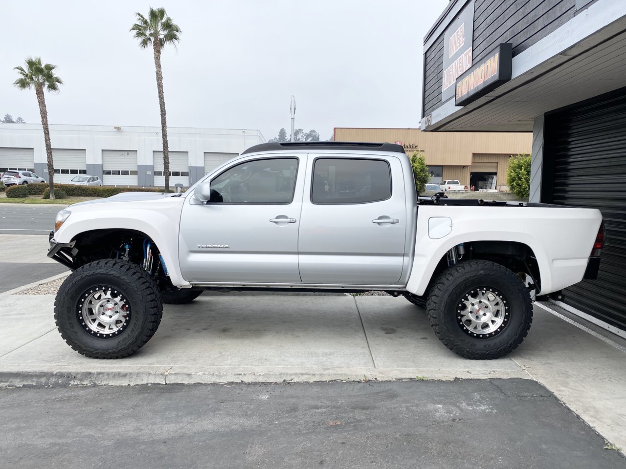

    What do you mean by they notched the frame?

    Picture number 5. They cut the frame vertically to allow the axle to move up a few more inches.
