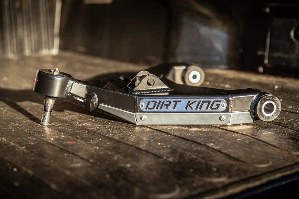

    Was ready to purchase these but was told by @Dirt King Fab sales that they're only good for up to 33's. Just ordered new wheels with 35's :censored:

    Derek at DK said they had rubbing with 35” at full lock so 33” is the max. I had them in my cart then got that email and cancelled my order. I don’t want to do TC due to the uniball and NY winters.

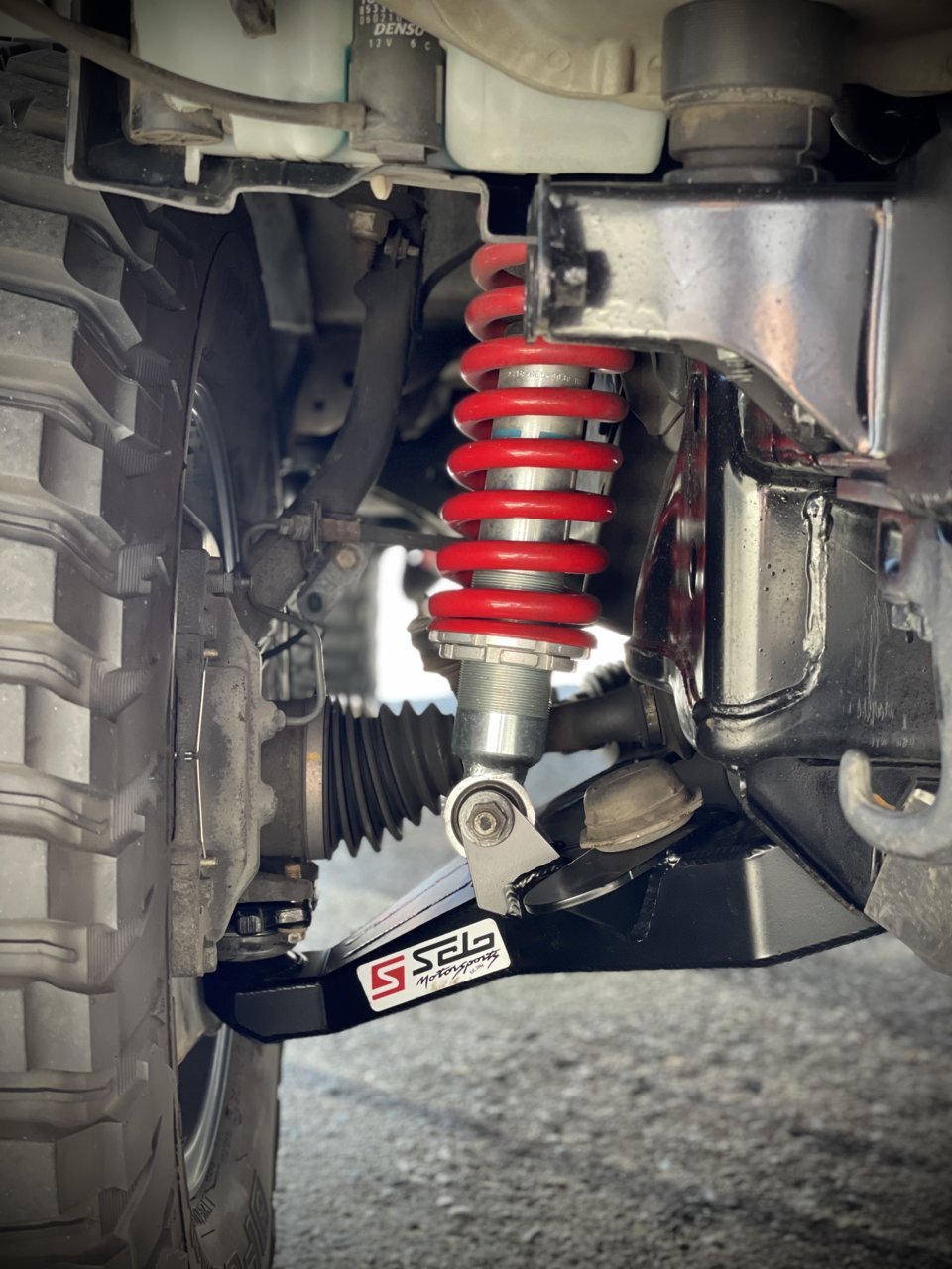

    I have dirt king UCA’s and LCA’s. I’m on 34’s with no issues. A friend had Dirt king LCA’s on 35’s with no issues. Maybe it just depends on your wheel offset.

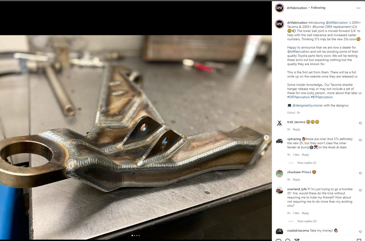

    I think it’s ridiculous that we need a CMC to run 33”s on any negative offset wheels. Wish Dirt King would make caster adjusted LCA’s like solomotorsports. Simply moving the LBJ 1” forward adds 1-2 degrees of positive caster. Ran the solo LCA’s on my 02 4runner and had tons of clearance in the rear. If dirt king or solomotorsports comes out with this solution I would buy a set in a heart beat.

    With 35's they were likely rubbing the firewall along with the cab mount if it wasn't already aggressively chopped or relocated. With 35's its no longer just the cab mount that becomes a concern for rubbing. I rub tf out of my firewall, I want to get it tubbed but I have been exploring LCA options too.
    There's a company called btf fabrication that is currently working on a LCA that moves the ball joint forward. I'd like to pair those with Accutunes new upcoming UCA that moves the upper joint forward as well and PRAY I no longer rub but I could get the firewall tubbed for 1/3 of what all that would cost.

    35s are possible with our performance LCAs, depending on what modifications the end user is willing to do. We try and make our products as straight forward as possible, and while 33s are the max recommended tire size, dozens of people have used 35s with great results. Its going to be dependant on tire brand and model, wheel width, offset and alignment specs. A negative offset wheel will cause rubbing problems on the cab mount (which can be cured with a cab mount relocation) and a positive offset will cause the inner tire to rub on the rearward portion of the LCA (steering can be reduced with a modified steering stop) so there will be some trial and error of wheel offset and width of tire. Also, our performance LCAs do not move the lower ball joint forward, if we did that in combination with the alignment correction already put into our UCAs castor numbers would be very high and far out of our recommended spec.

    I'm on 35s with DK upper and lowers. No issues with the DK parts at all. Love them. With any 35 you will need to modify the wheel well. No way to get around that. If that bothers you forget about 35s.
