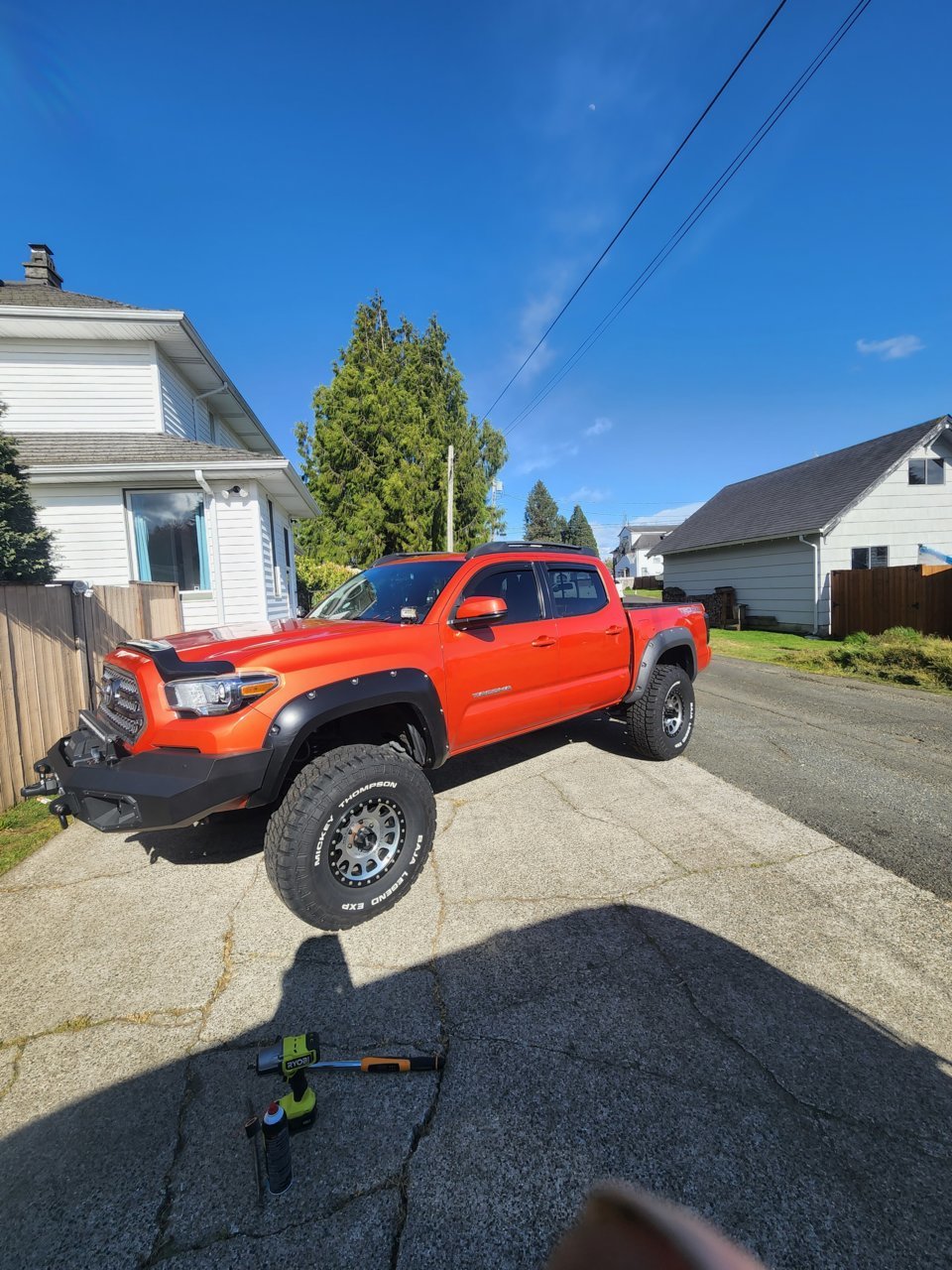

    Rough Country 6" slight rubbing at full lock 315/75/16s

    Didnt chop nothing . I do have cab mount relocation kit just haven't installed it yet
