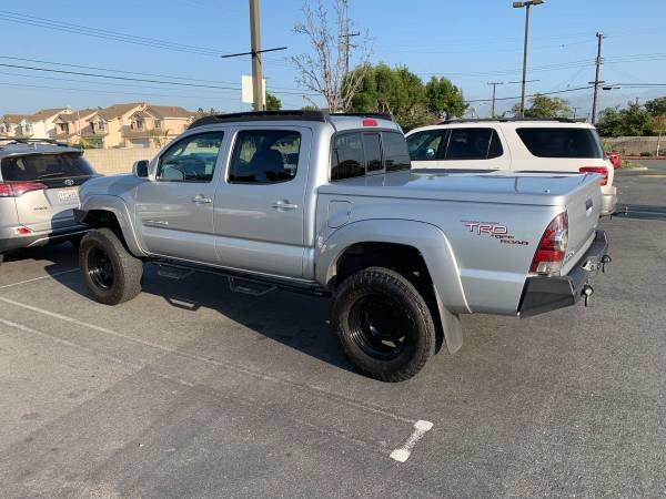

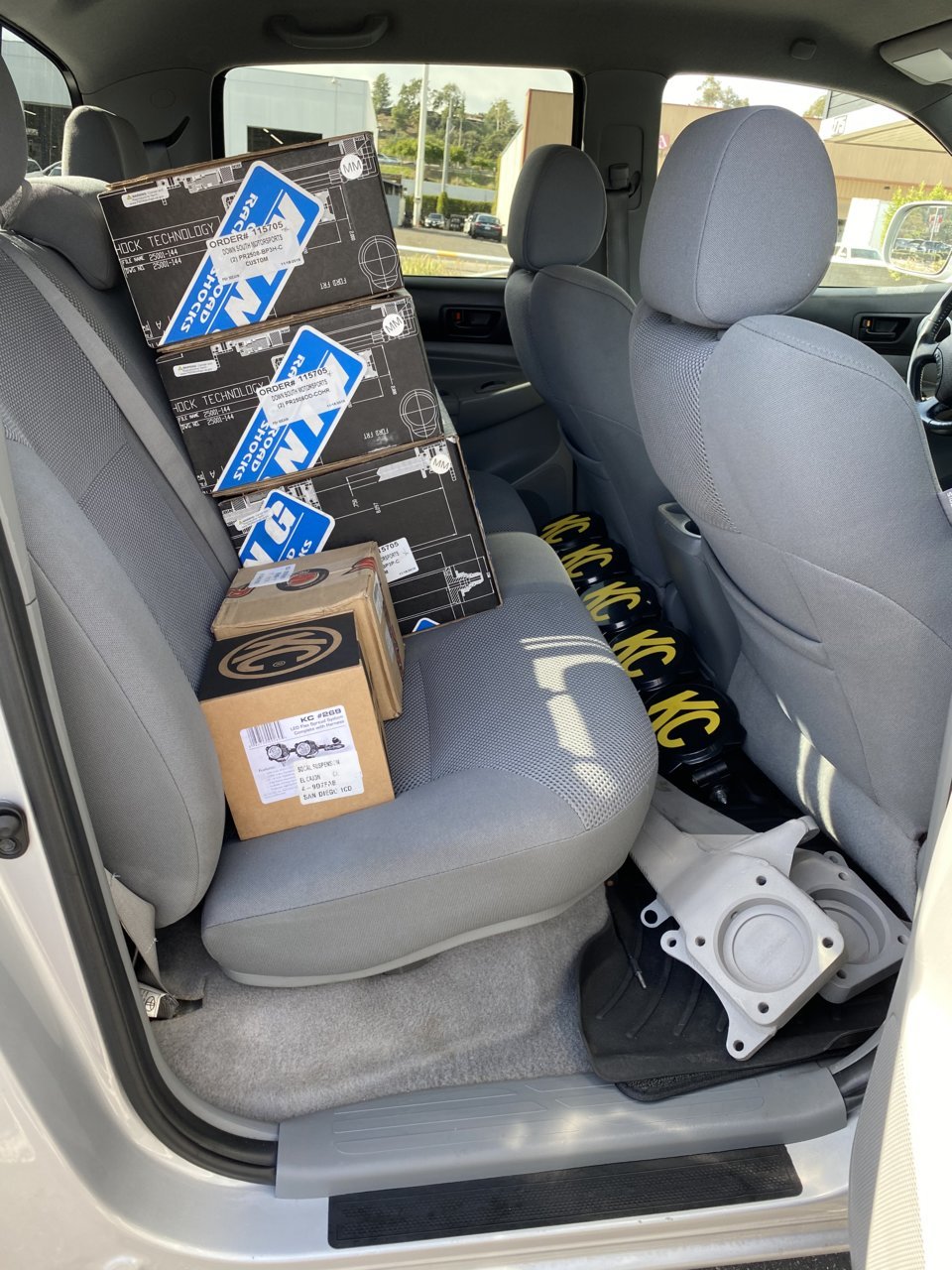

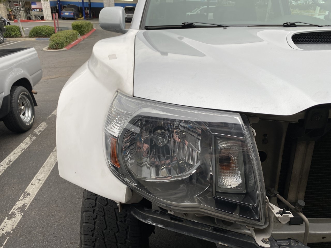

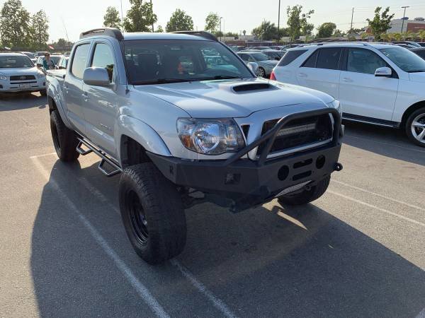

    Hey guys thought I’d start a thread to mostly document the build of my recently purchased 07 double cab prerunner. I have a very long history of long travel trucks but this is the first one I’ve built from essentially complete stock I’ll be asking some questions along the way through the build!
    purchased the truck a couple months ago from the original owner it had quite a few mods and I will be taking everything off (figured i could recoup some of my money from these parts)
    plans are
    Dirt King long travel kit
    Camburg spindles
    King 2.5 coilovers front
    King 2.5 bypass front
    King 2.0 bumps front and rear
    King 3.0 bypass rear
    Fiberworks glass
    17” method double standards
    35x12.50x17 Toyo RT
    Dirt king will be prototyping their new spring under kit and bolt in bedcage and plating the frame from the cab back

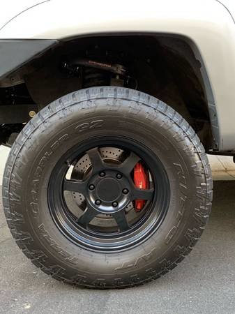

    Here’s a few before pics, bumpers, tires and wheels, all suspension is for sale DM me if interested

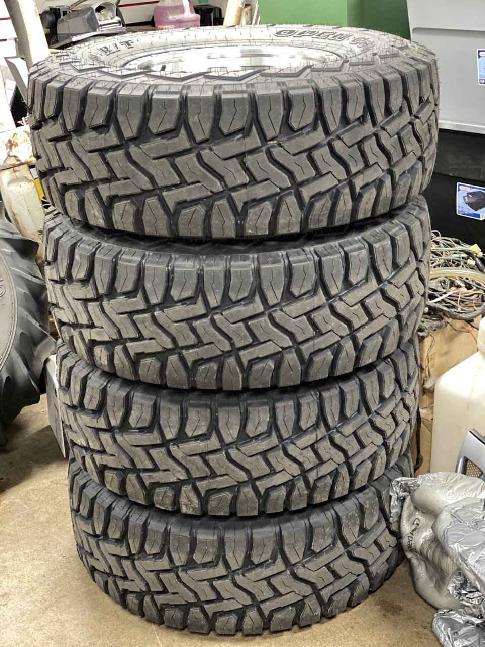

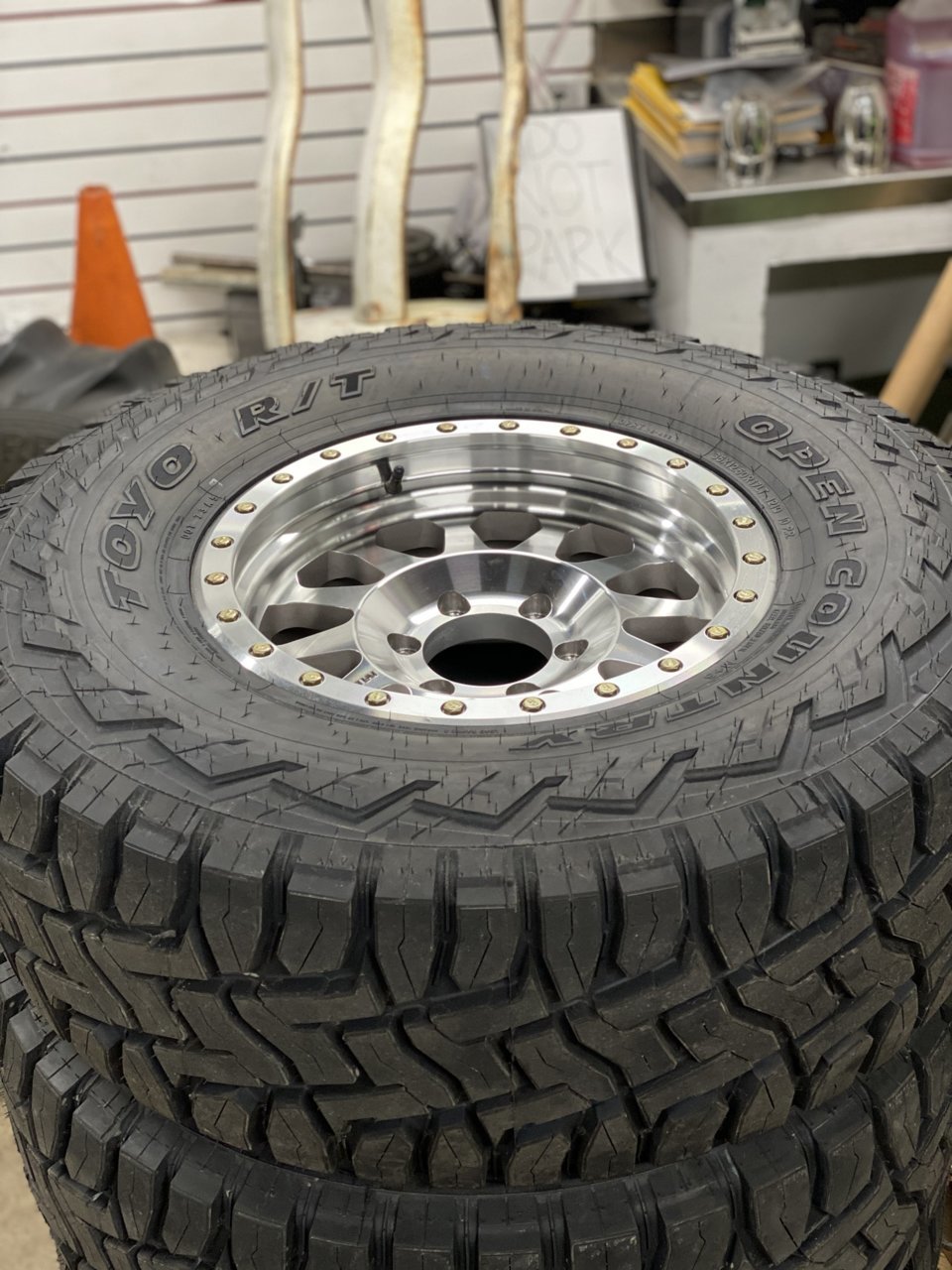

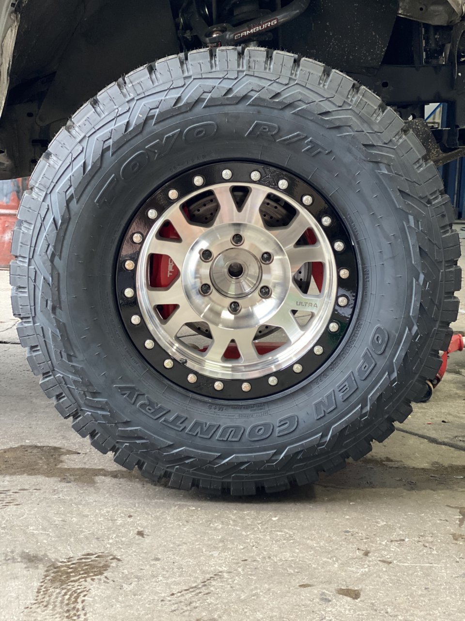

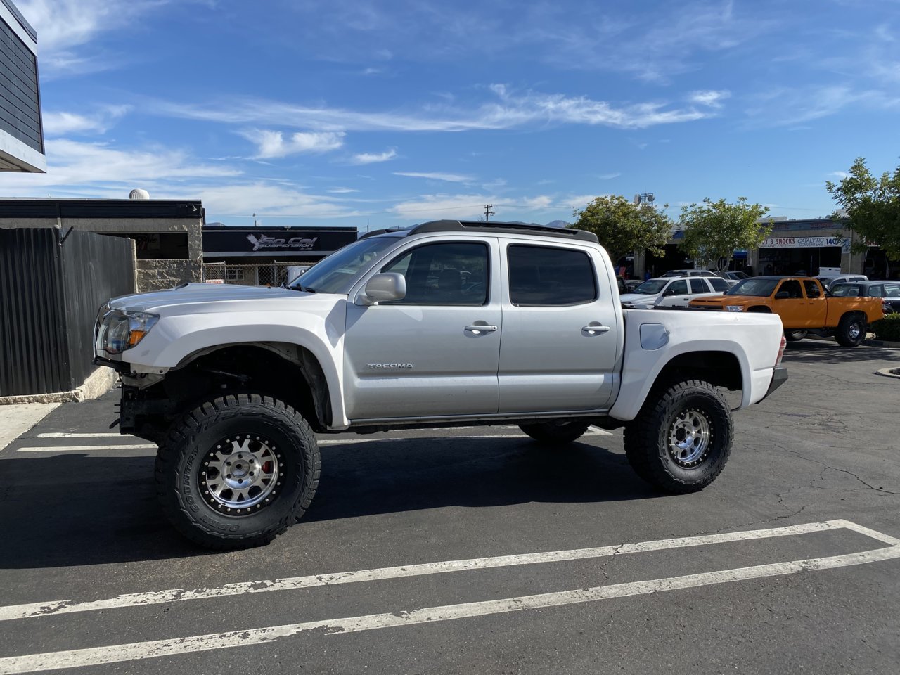

    Got my front glass on (Fiberwerx 6”) and putting the bedsides on this weekend. Also mounted my wheels and tires I ended up selling my double standards and getting some Ultra X103 beadlocks

    Haha that’s the truth I had those methods sitting there for months and literally about a week ago I thought I better get real beadlocks. I’ll post updates throughout the next few weeks while it’s at Dirt King

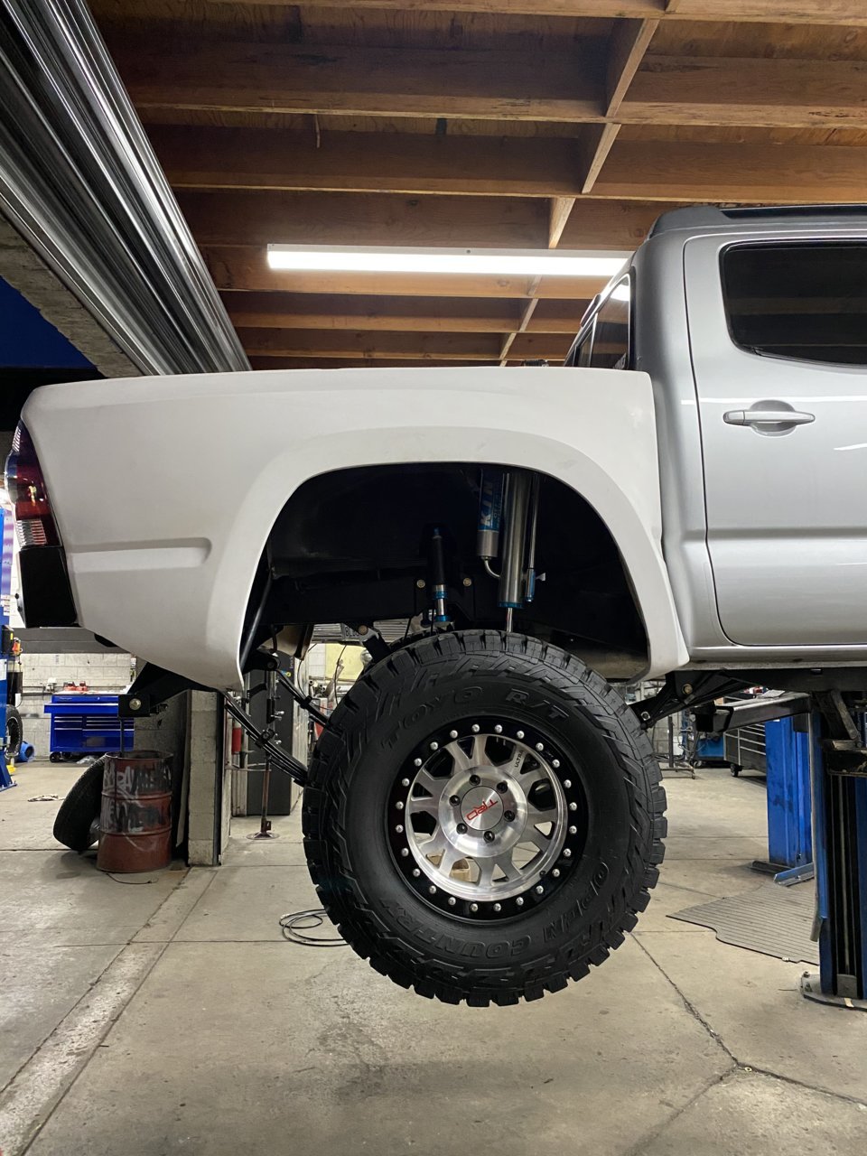

    Got my bedsides installed and dropped the truck off at Dirt King today

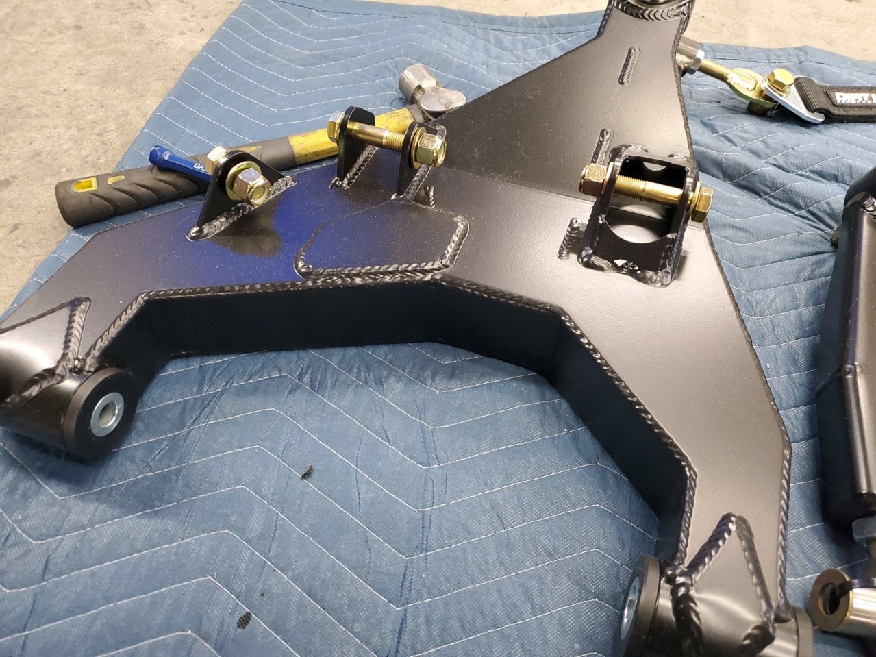

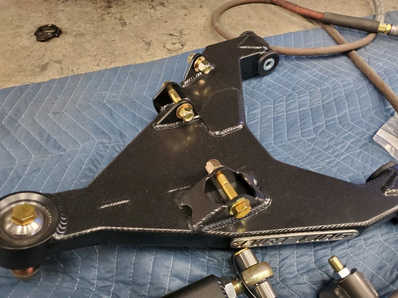

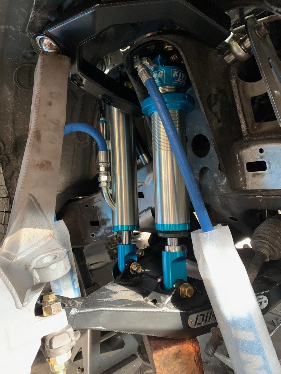

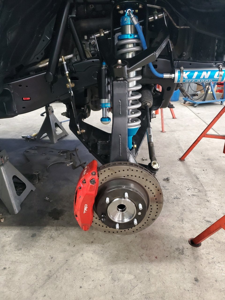

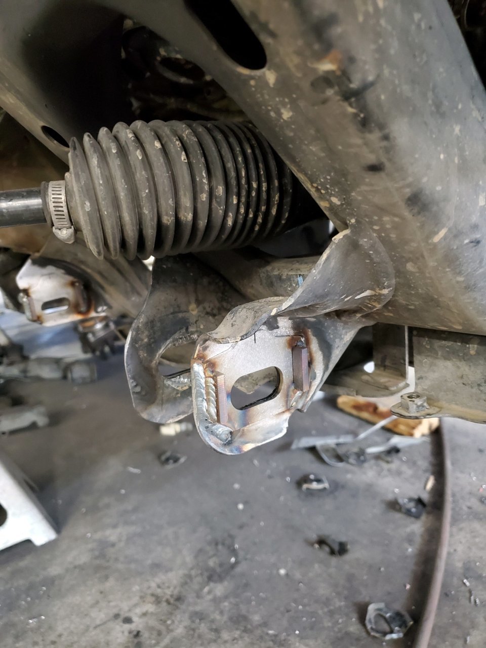

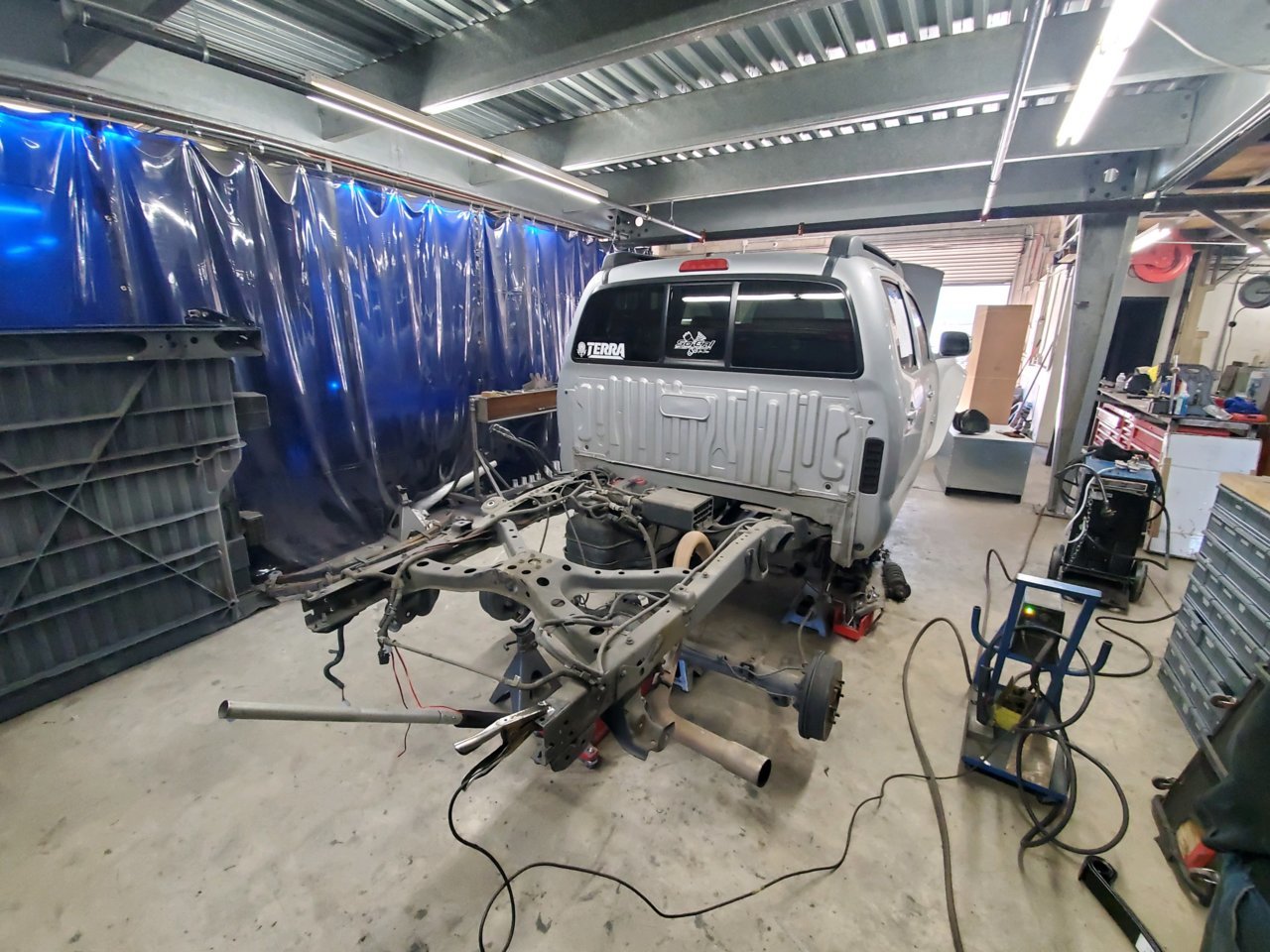

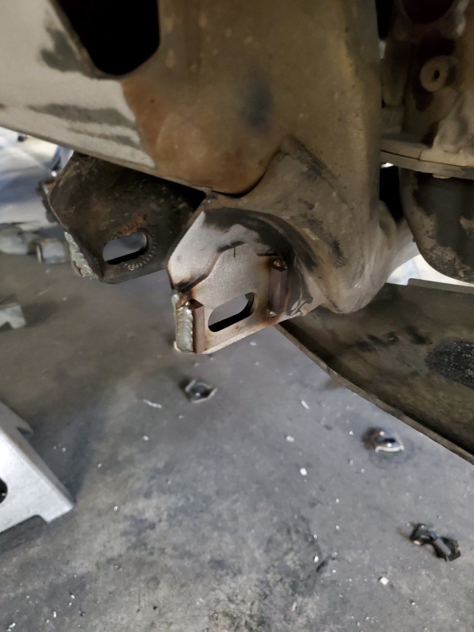

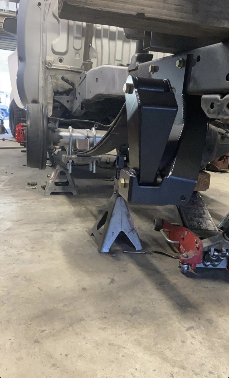

    Update from dirt king
    jo2010, whatstcp, FishnTx and 3 others like this.

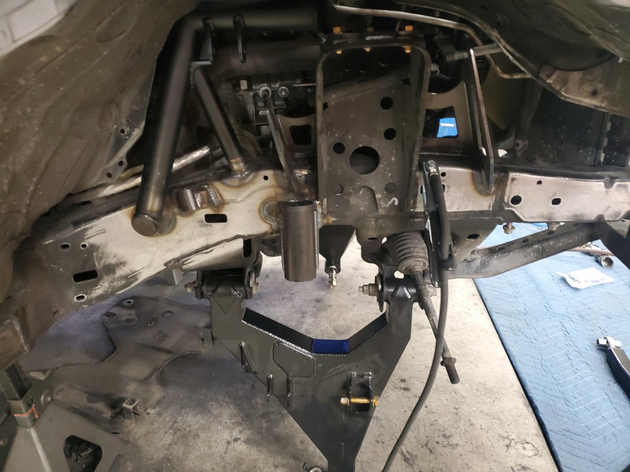

  9. Dec 31, 2019 at 8:53 PM
    Nickgbmx
    Nickgbmx [OP] Well-Known Member
    Jun 1, 2016
    #188500
    139
    Nick
    2010 Tacoma Trd

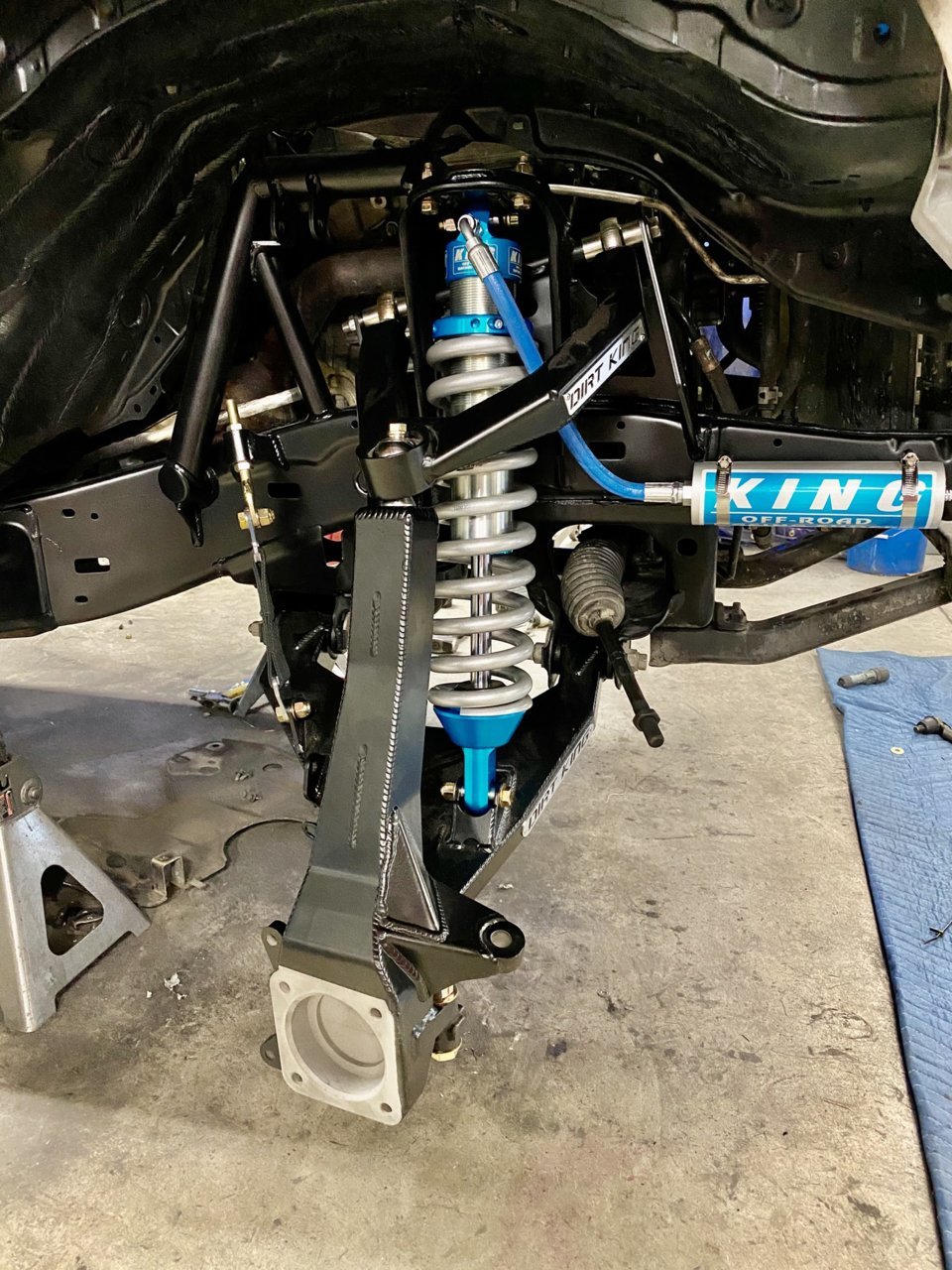

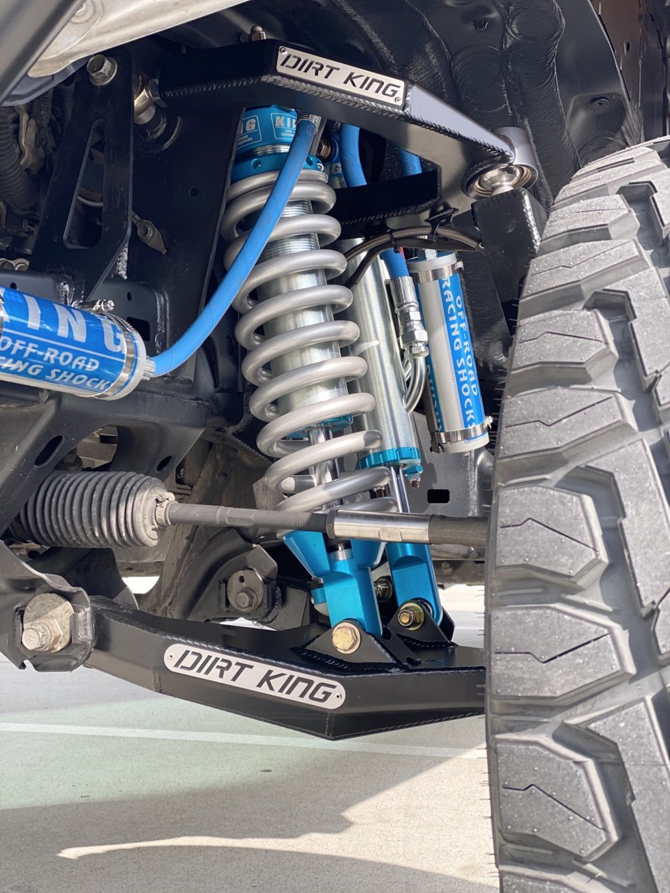

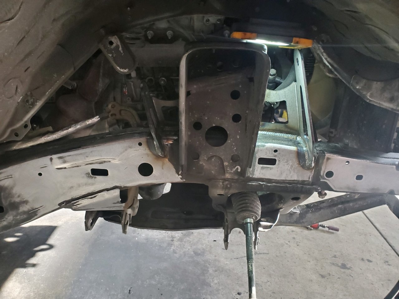

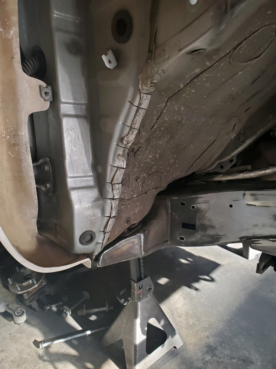

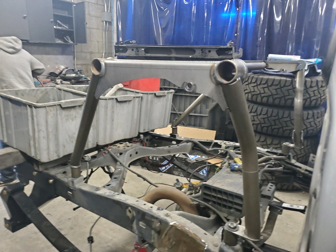

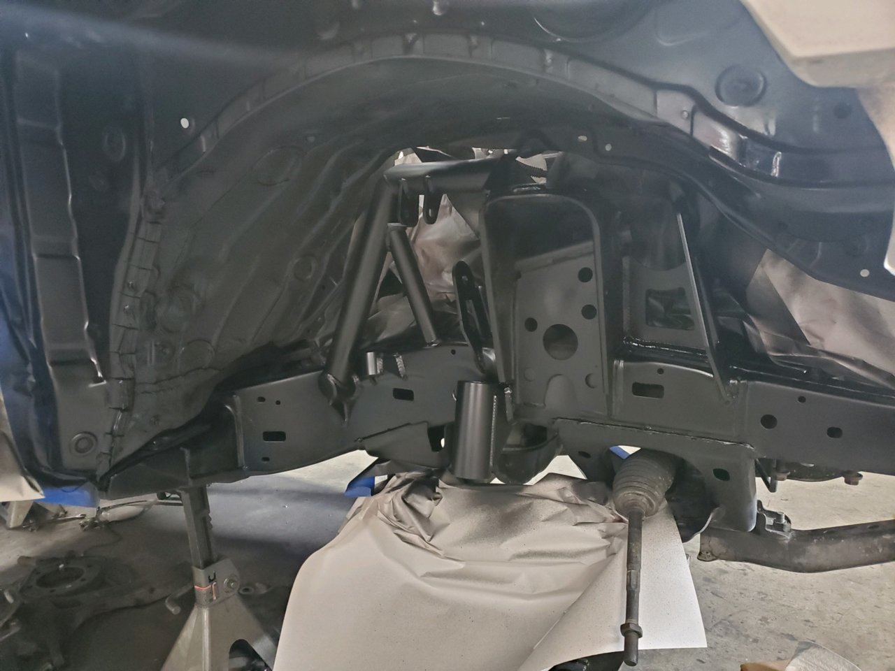

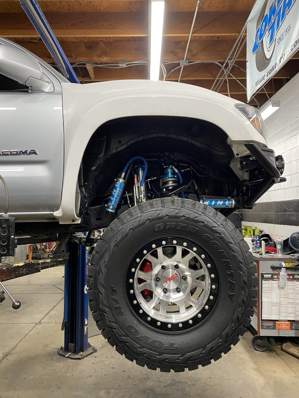

    Dirt King has been kicking ass they are revising the hanger and shackle setup currently to get more bump travel, gonna have them notch the frame and integrate the bumpstop into it and build sheet metal inner fenders in the rear to get 19” of travel and strap it at 18”. Going into it I was hoping for 16-17” so I’m beyond happy, also modifying the inner fenders in the front for upper arm clearance to get 15” of travel all said as done. Bypass hoop is mocked up and starting to assemble and cycle the front suspension to set the bumpstop

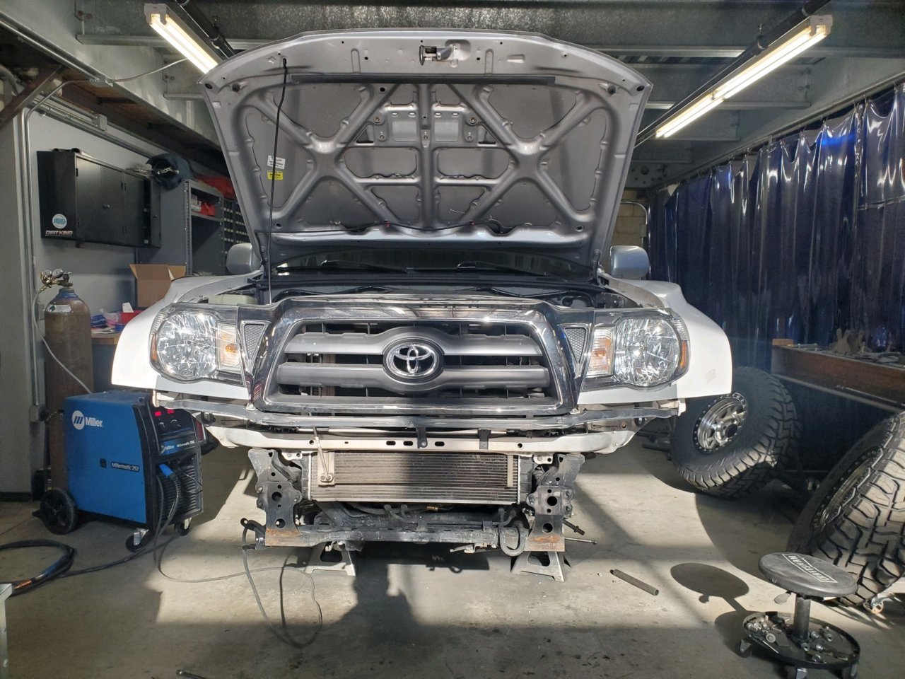

  10. Jan 6, 2020 at 9:26 AM
    Nickgbmx
    Jun 1, 2016
    #188500
    139
    Nick
    2010 Tacoma Trd

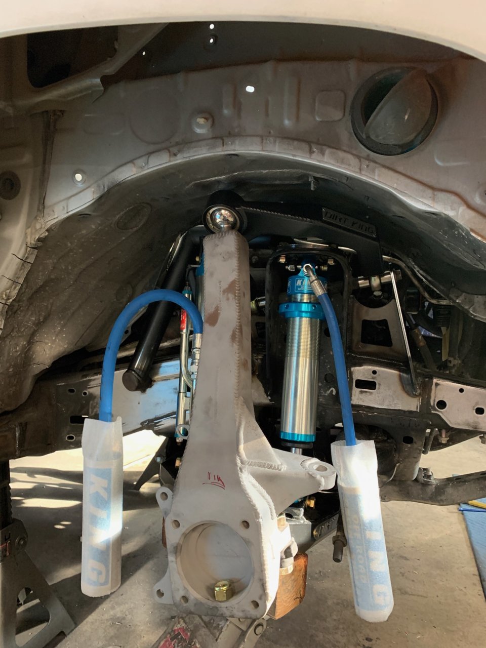

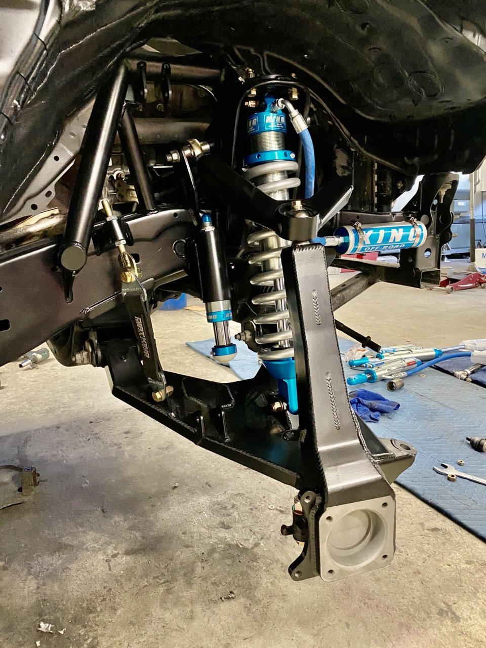

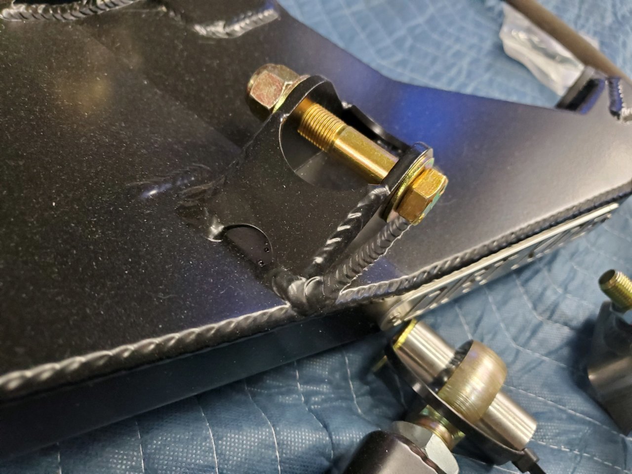

    Cycling the front suspension to set up the bump stop, King was supposed to end the shocks with a +1” rod end which they didn’t so downsouth Motorsports is swapped those out and got everything set up, pulled back apart and painted and should be final assembled today or tomorrow

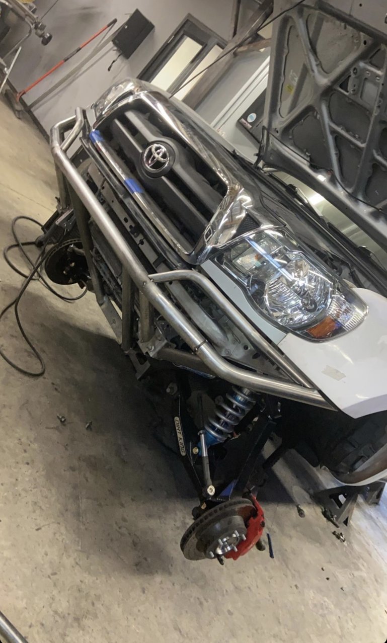

  11. Jan 6, 2020 at 7:00 PM
    Nickgbmx
    Jun 1, 2016
    #188500
    139
    Nick
    2010 Tacoma Trd
    Bypasses will be on tomorrow then onto the rear
    loyaltothetaco and Babybluetaco like this.
  12. Jan 7, 2020 at 8:30 PM
    Nickgbmx
    Jun 1, 2016
    #188500
    139
    Nick
    2010 Tacoma Trd
    Front is pretty much buttoned up besides bypasses and brake lines

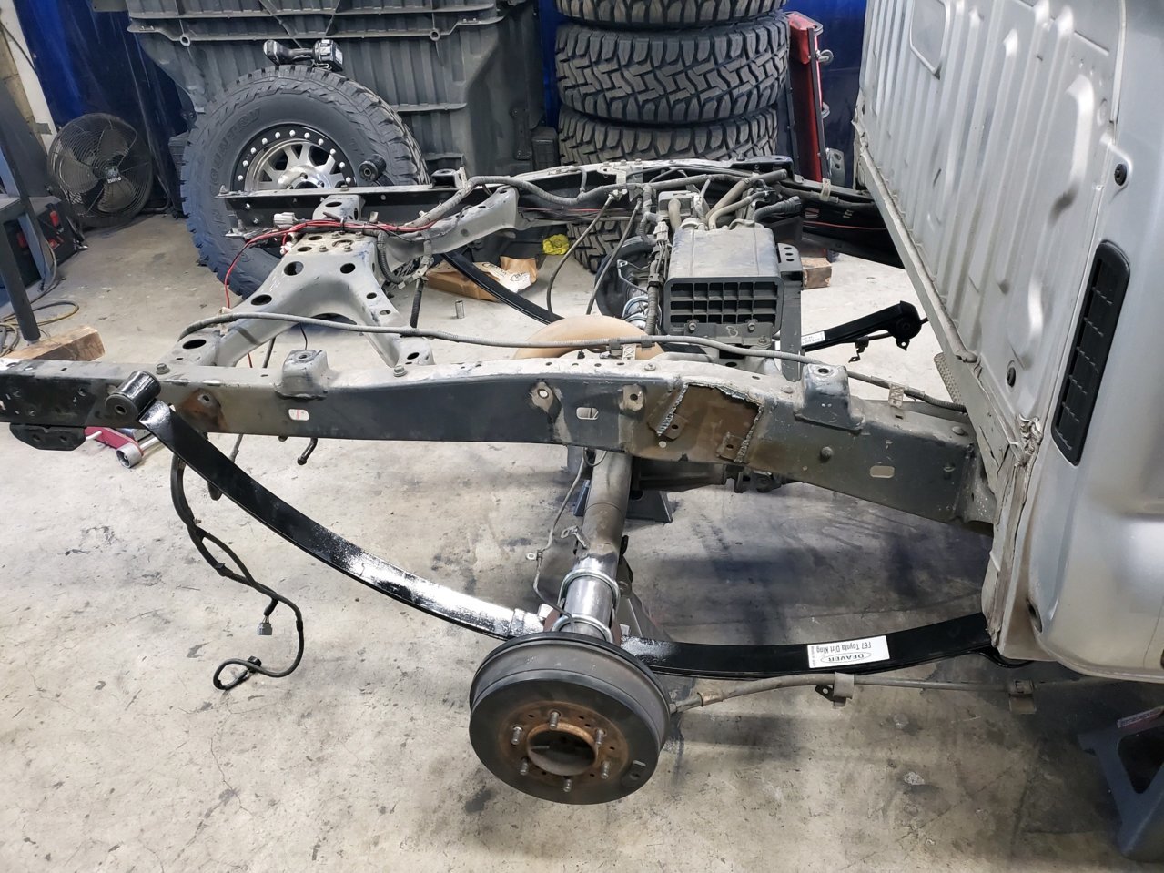

  13. Jan 11, 2020 at 7:26 PM
    Nickgbmx
    Jun 1, 2016
    #188500
    139
    Nick
    2010 Tacoma Trd

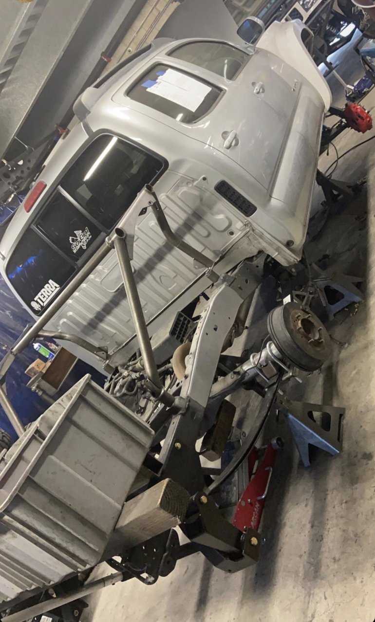

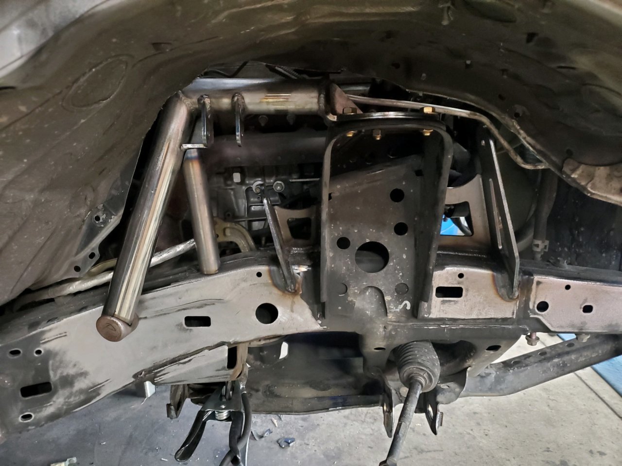

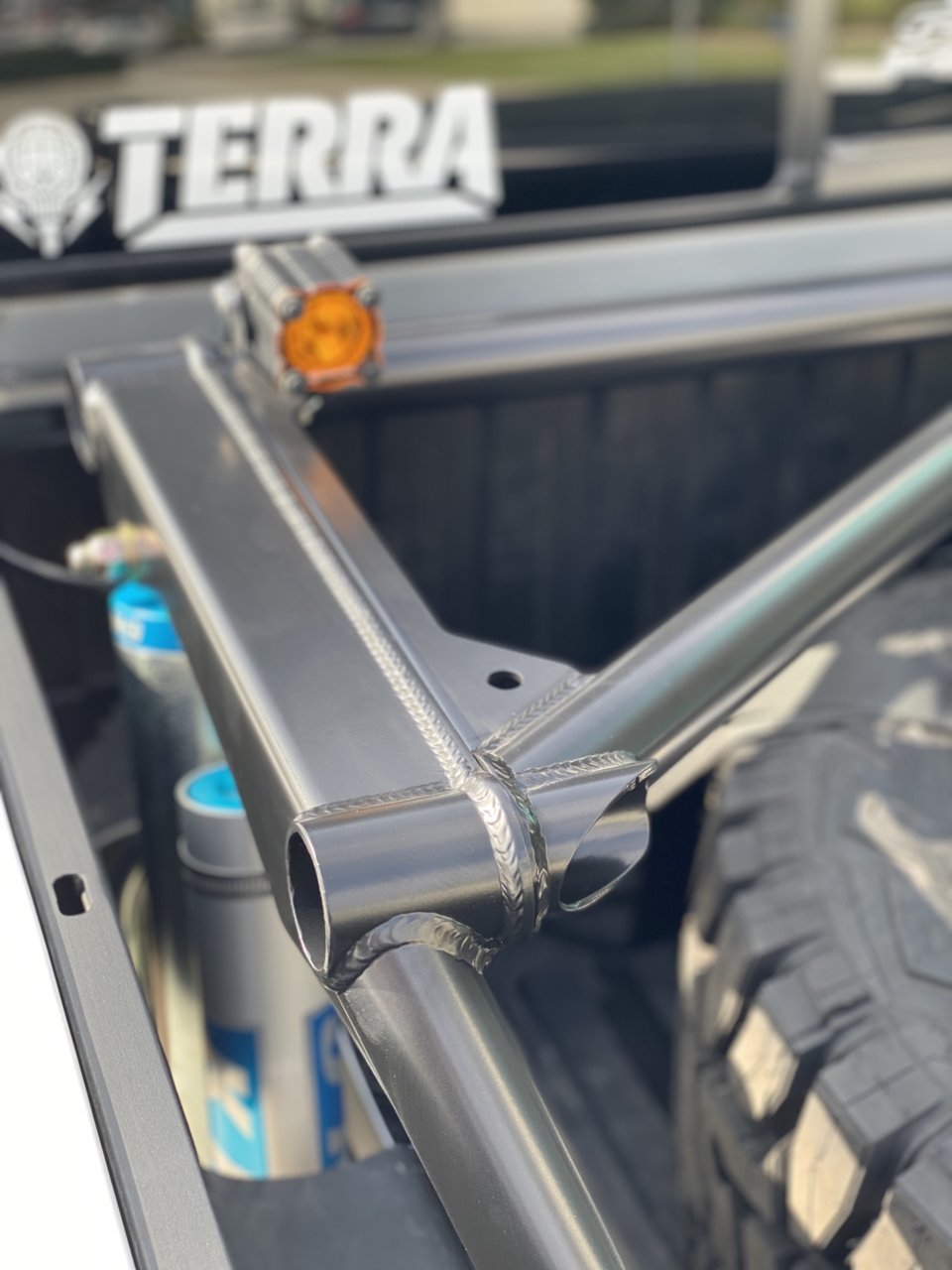

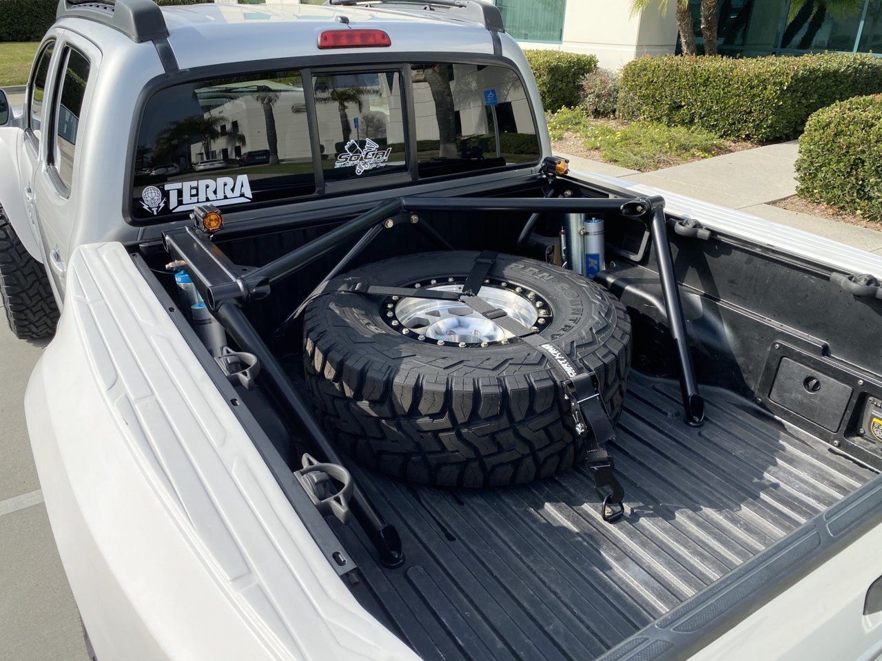

    Now that the front is wrapped up onto the back, front and rear hangers and shackles are done, started the bedcage. Then onto notching the frame, setting up bump stops and building the rear inner fenders and finish the front bumper

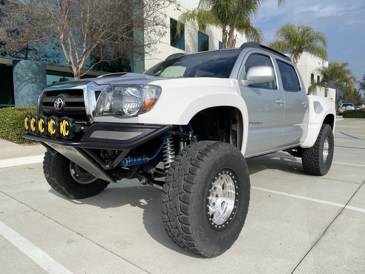

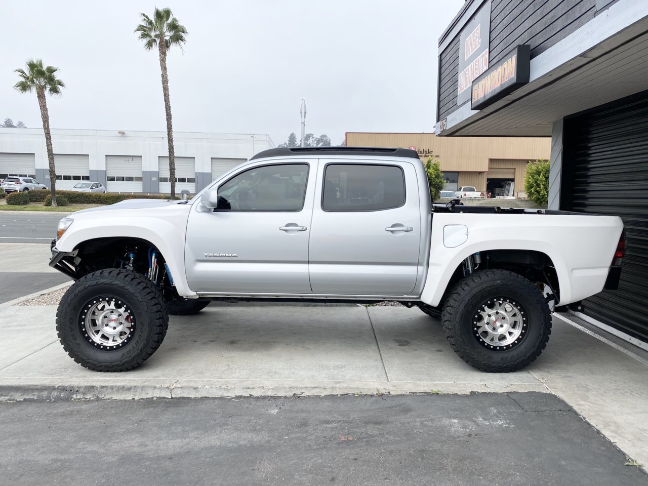

    Sorry skipped a few steps but the truck is done and I’ve been enjoying the hell out of it
