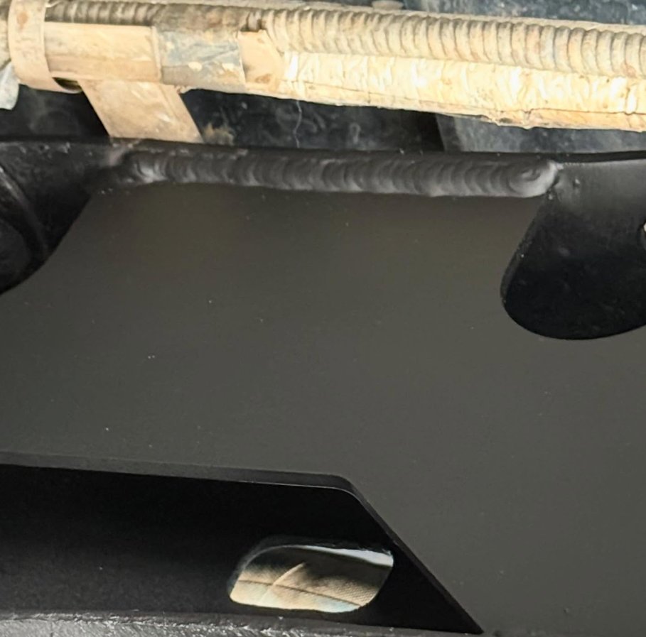

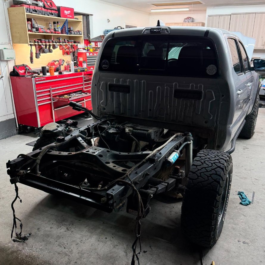

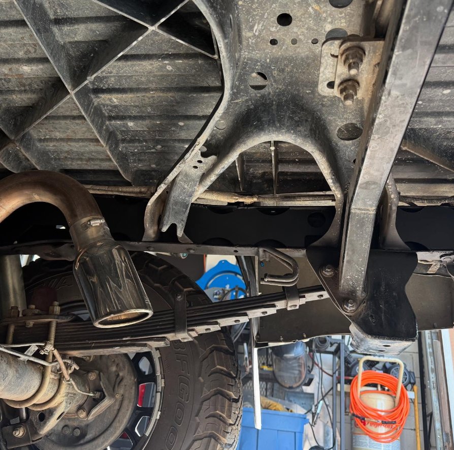

    Resurrecting.

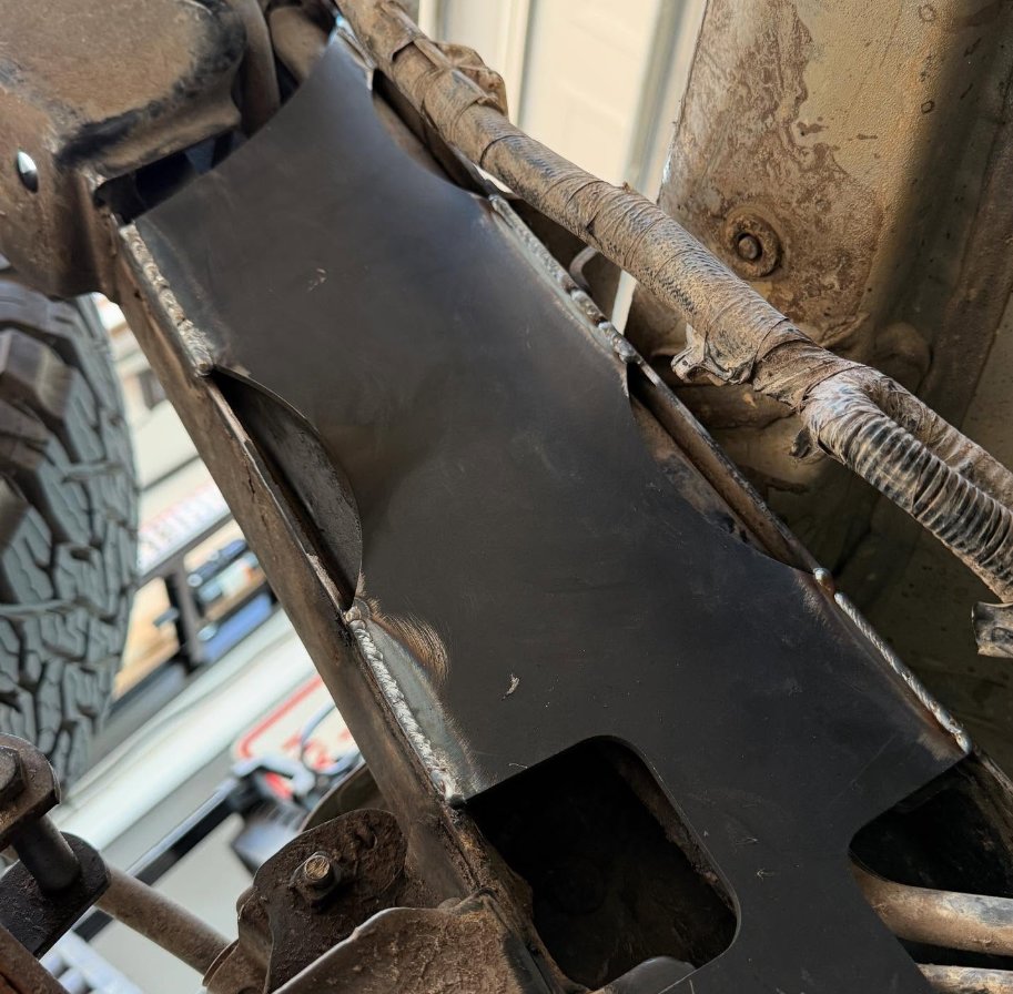

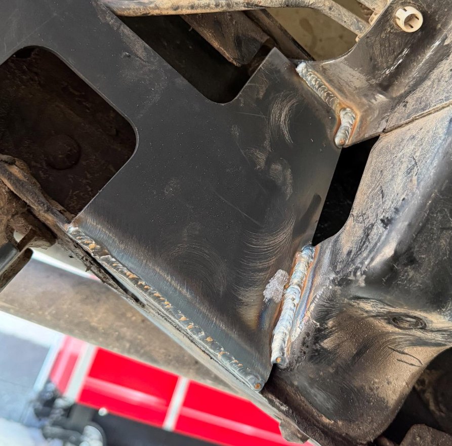

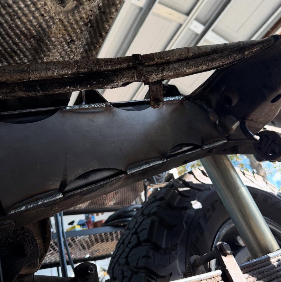

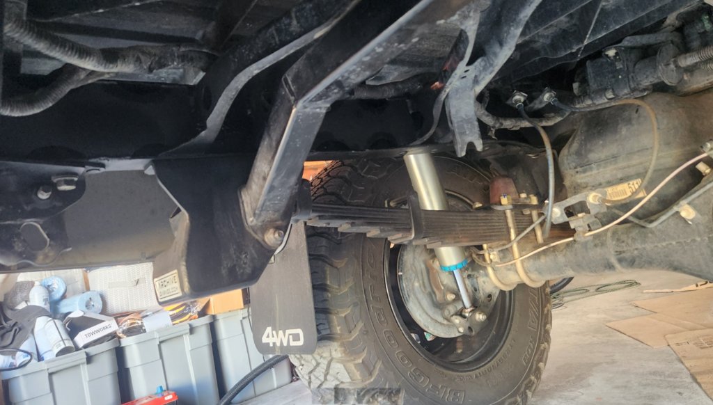

    I just had this done about 2 months ago and have spent enough time off pavement to notice the differences before and after.
    I wish I could do something like this myself, but I cannot weld. Fortunately, I have a great fabricator local to me who has helped with multiple projects including cam tab gussets, spindle gussets, and frame horn reinforcement and gusseting with new grade 8 1/2 inch bolts welded in place of the stock M10 bolts that I stripped the first time I used my winch.
    I have been on a continuous quest to improve the rear end ride quality starting with a Deaver U402 Stage 1 leaf pack, then Archive Garage HH, HC cross tube and U-bolt flip, then King 2.5 extended shocks from Accutune set to +300# over stock on rear axle, to finally having the C-channel plated.
    All of these updates combined took away the rear end jitters. The ride is firm, but not harsh and there is no sway and no more looking in the rear view mirror to see the bed shaking like a fat hooker on a cold night.

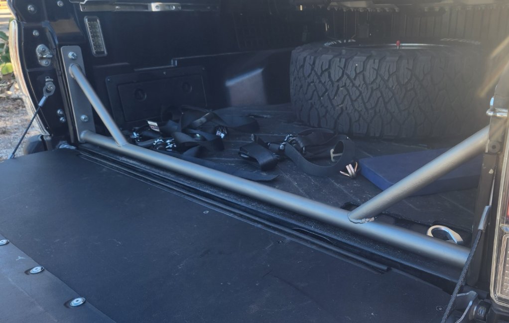

    I also put in the Kaizen bed brace which does limit bed access, but was worth the compromise for me.

    Did you happen to try it before and after the bed brace? Looks good!

    Thanks! Actually just the first shakedown run was sans bed brace (I put it in about 2 weeks after the frame plating). I did not notice any difference, but when I looked at standard bed stiffeners and the design of the Kaizen brace, I felt like it was worth giving a try to have a one piece design that connects both sides and is reinforced with 3/16 plates behind the taillights.
