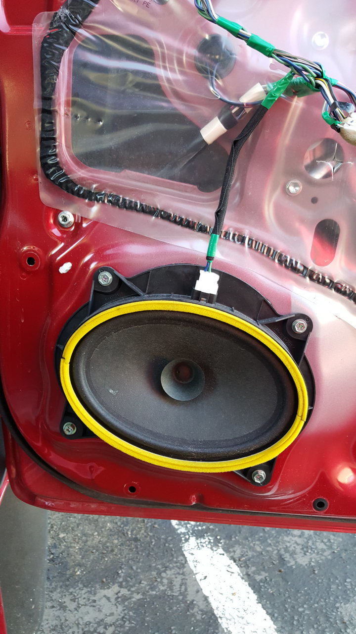

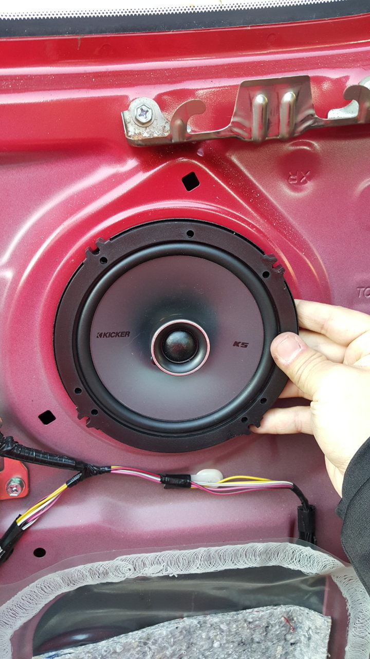

    Pretty quickly I realized that not having a backup camera sucked, and the stock radio left much to be desired especially having aftermarket audio in all my previous cars. Spoiler alert- I work at BestBuy, so my decision-making was real simple lol. I looked around, and decided I would start with the headunit and add a backup camera. I settled on a new Kenwood DDX9702S, and an Esky backup camera. I’d also add some bass with a Kicker Hideaway powered sub under the passenger seat. I also decided to add a Maestro RR instead of SW, so that I could get realtime gauges, and CEL codes directly on the radio.
    The upgraded audio sounded great, but of course I wanted more. I purchased a set of Kicker KS 6x9’s for the front, and KS 6.5’s for the rear door panels. To really get the full effect, I also added in an Alpine PowerPack 4ch amp. Now I had the sound I was looking for!

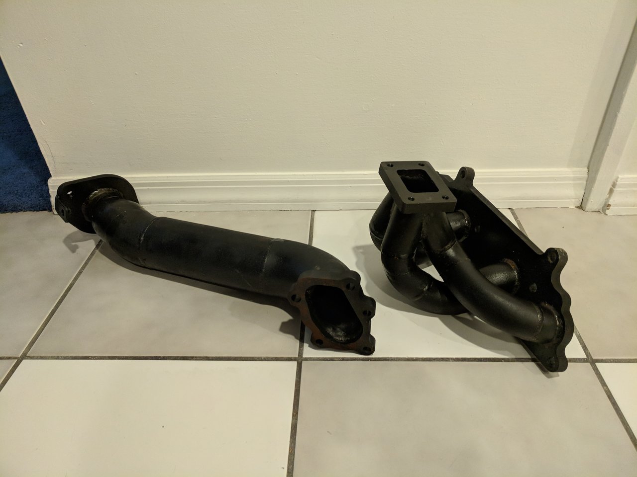

    One late night, I don’t know how or why, but I ended up searching 2TR-FE turbo manifolds on the web and came across a result on Alibaba by a company called Shanghai Waystar. Immediately I noticed it was the exact manifold and downpipe that OzBoost was using. I reached out to them, and about a month later (and $400 less than OzBoost) I had a manifold and downpipe sitting on my doorstep. It’s mild steel and heavy as balls, with a T25 inlet and 5-bolt outlet. From my findings, this was perfect for this size motor.

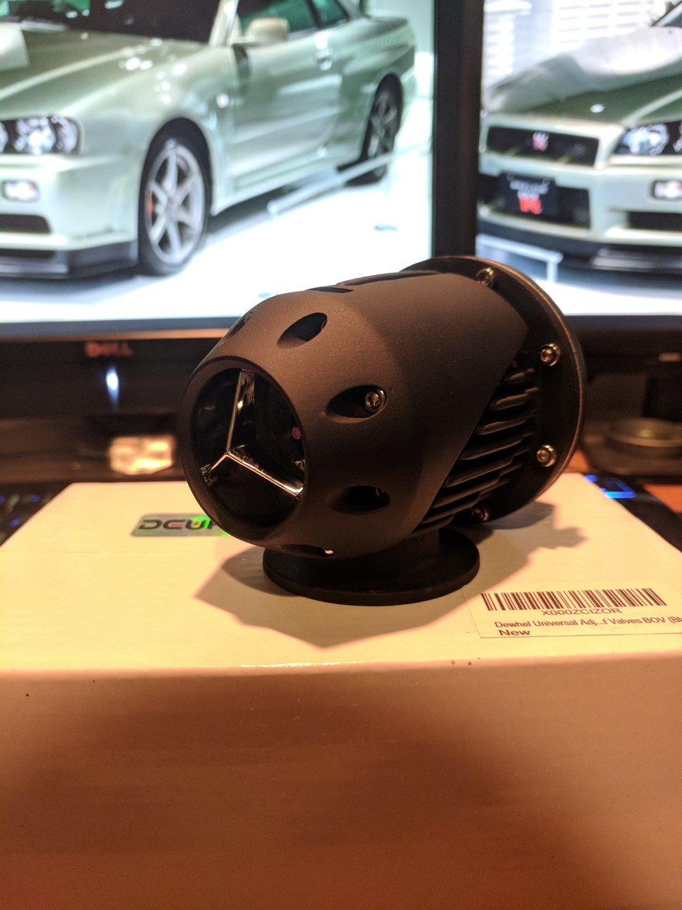

    I decided to pair this with a replica GT2871R turbo. No it’s not a genuine Garrett, eat my ass. It’s from Supercell Turbos, and featured dual ceramic ball bearings, a billet wheel, and 360 degree thrust bearing. It also wasn’t cheap, at $700. It had good reviews for guys running 20-25psi through it, so I bought it. So sexy!

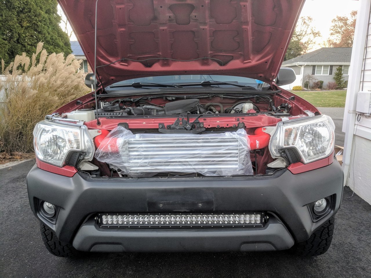

    Next up was an eBay intercooler kit. Knowing I wasn’t pushing a ton of power, I was okay with this. I went onto Treadstone Performance and picked up a MAF flange to be welded onto my intercooler piping.
    Following Kirk’s advice, I converted my MAF to a blow-through setup where the MAF sits just before the throttle body, after a blowoff valve that can be vented to atmosphere. So I picked up an HKS-style BOV.

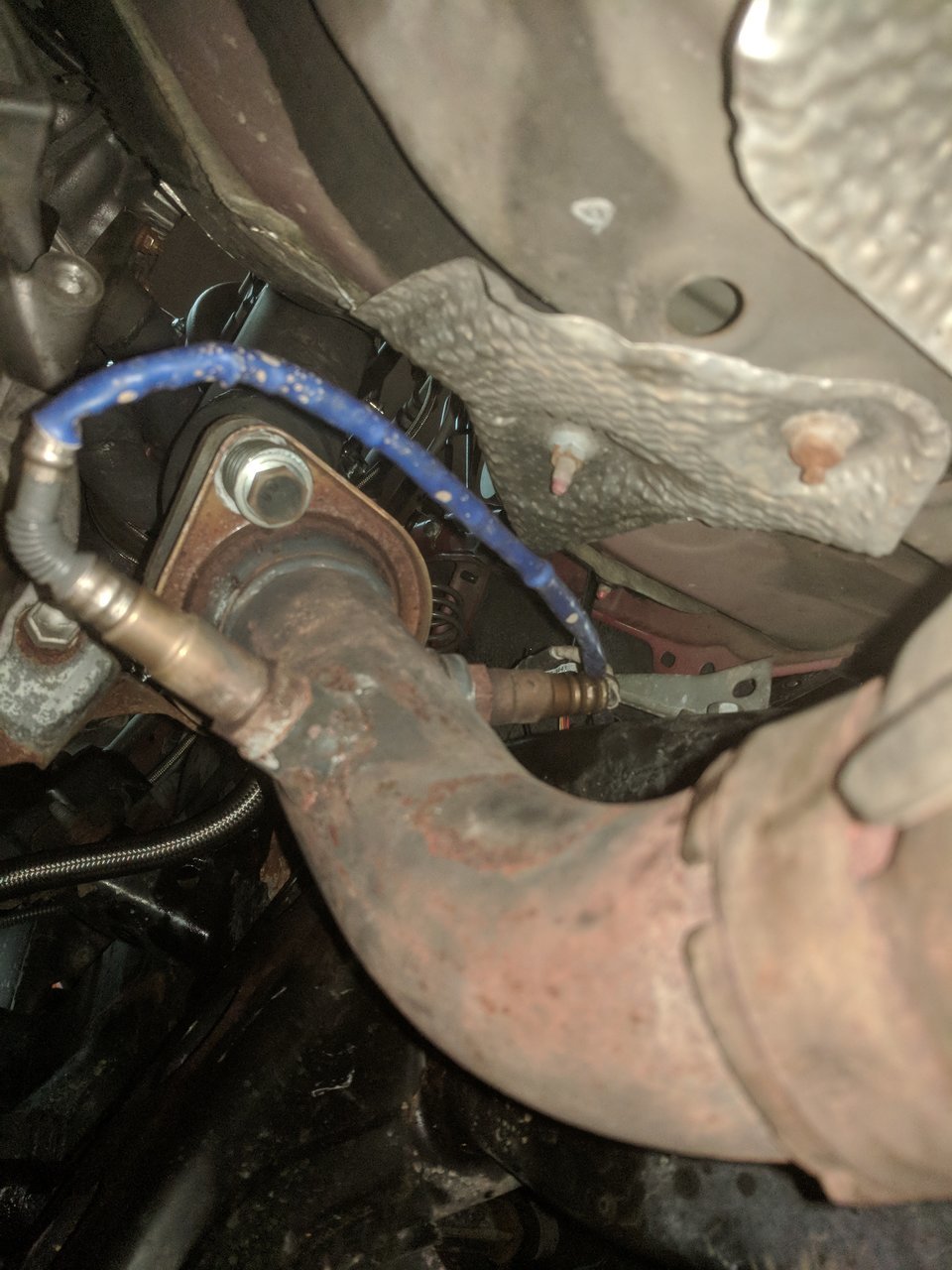

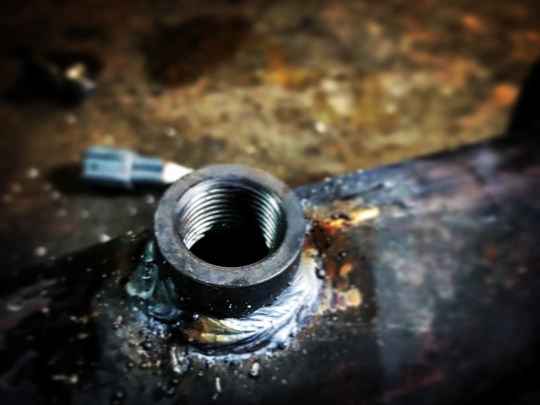

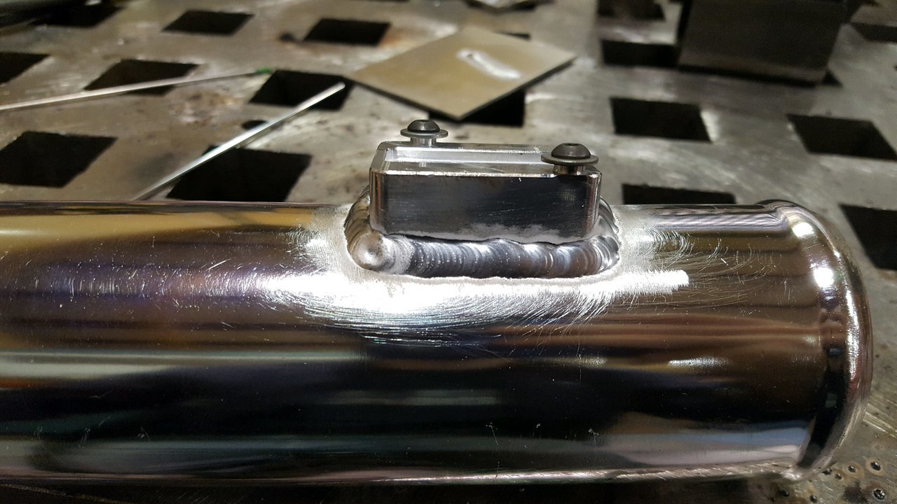

    Picked up an AEM Wideband, welded the bung into place, and also scored a new AEM boost gauge locally. Winning!

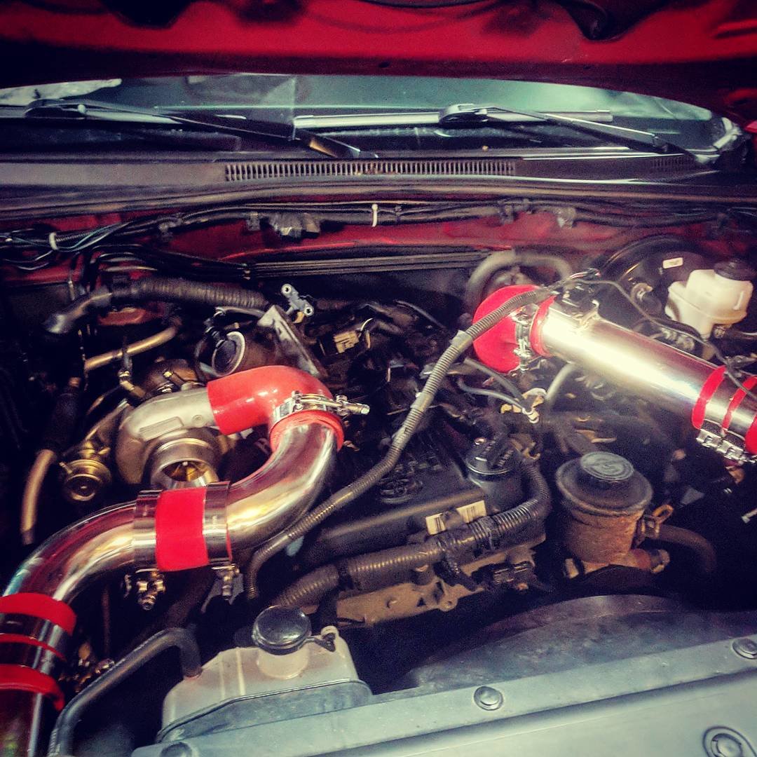

    After about 6 months of research, and parts gathering…it was time. By the way, the truck had 113k on it at this point. Needless to say, it gets driven a lot. I enlisted the help of my best friend and the use of his lift, and said fuck it, we’re doin it live. It was a Fri, and I drove to his shop after work, and prepared for the scariest/most exciting thing I’ve ever done on a vehicle. We pulled the front diff/driveshaft to gain access to the oil pan in order to tap the block for the return. The red circle is where we drilled through using a stepped bit for the fitting.

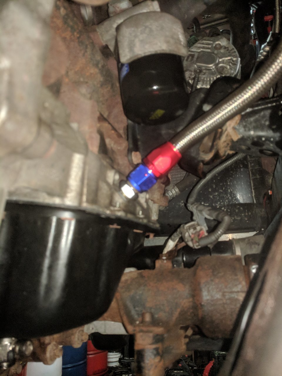

    Smooth as butter. Sealed it back up after the fitting was secured, and brought the truck down to driving height. Removed all the air intake systems, disconnected the exhaust in front of the cat, and removed the header. For a truck with 113k on it in the Northeast, the header bolts came right off with a little bit of Kroil and heat. To me, that was the scariest aspect- breaking off an exhaust manifold stud. Looking at the exhaust ports, I was surprised there was so little carbon buildup. Great sign! We installed the Kinugawa manifold studs in the manifold and turbo, then installed a new Felpro manifold gasket. Next was time for the turbo manifold, which went in without a hitch. One major thing to note is that the turbo manifold does not have a provision for the SAIS. I relocated the pump itself to where the factory airbox was, and extended the vacuum line and wiring so that the pump would run and not put the truck into limp mode hopefully. The exciting part was placing the turbo on the manifold- it looked so good in the engine bay, like it was meant to be there!
    Secured everything down using copper locknuts and made all the connections to the oil/coolant lines. The coolant lines were intercepted off the throttle body, and the oil feed was already in place from my oil pressure gauge. I used a -10AN drain line. Once everything was mounted, the AC lines had to be gently bent out of the way to clear the downpipe and wastegate actuator arm. No big deal, plenty of room!
    Plumbed all the intercooler piping, which basically required no cutting at this point, as I had mocked up the piping as best I could a few weeks prior. I plugged in the MAF sensor, topped off coolant, and cranked the truck over- with my heart pounding. Started right up, and idled without issue right at 14.7 AFR. Checked for any leaks, tightened everything back up and was told to go drive down the block to make sure nothing happens. As soon as I pulled onto the side street and started lightly accelerating I heard the turbo start to suck in air and my face instantly light up…It was like the sound of the angels coming down from the sky to take me to a higher place! The truck was officially turbo'ed on 5psi and driving like stock.

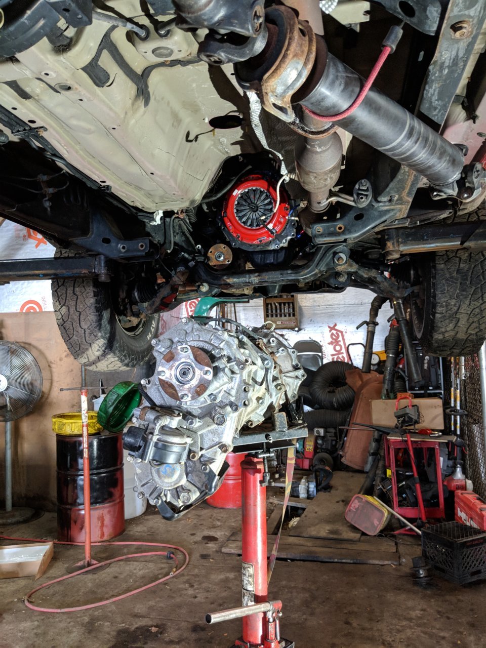

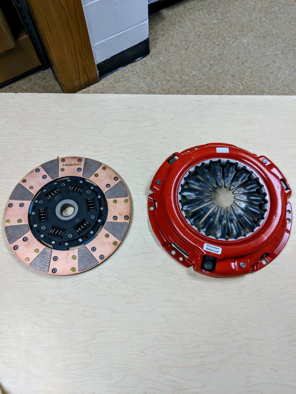

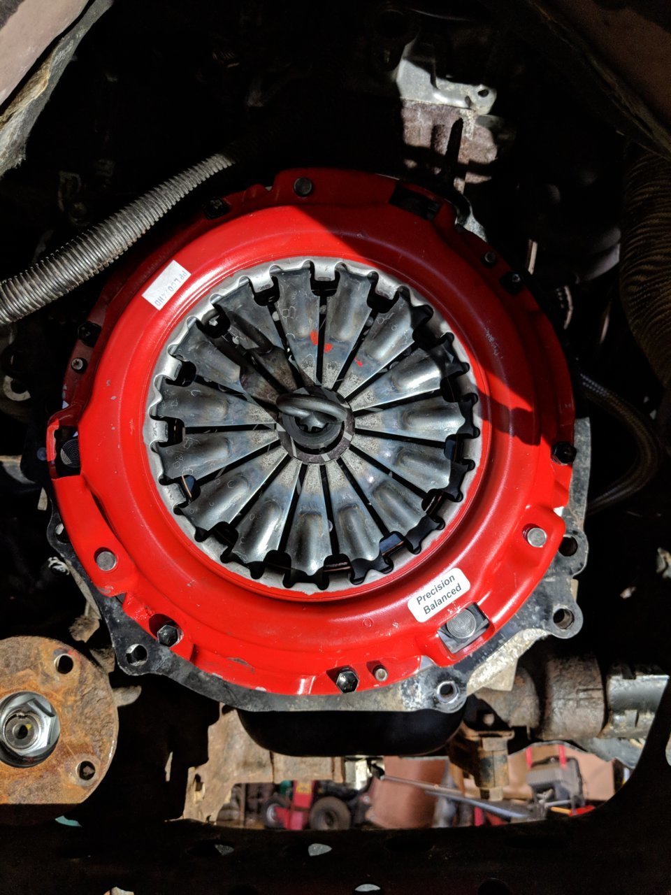

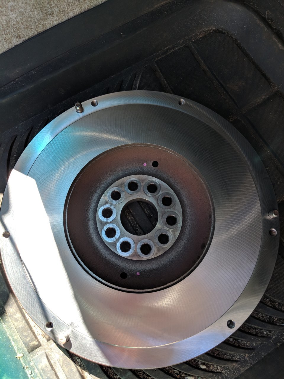

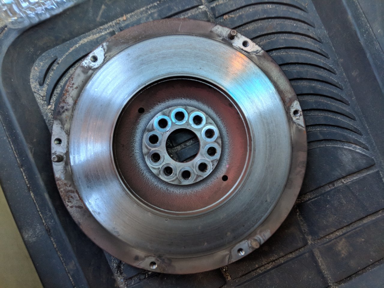

    Removal was pretty easy- removed the front/rear driveshafts and dropped the trans with the t-case attached. Had to smack the bellhousing with a rubber mallet a few times, but no major struggles. The old clutch didn’t look all that bad, but it clearly couldn’t hold much more power/tq than stock. I also used this time to inspect the rear main seal, which was clean and not leaking. I took the flywheel to a local machine shop to get resurfaced- you can see a before and after below…soo shiny!
    Install was cake- using all new hardware/bearings in the LCE kit. Used the paper towel method to replace the pilot bearing, which amazed me! Bolted the flywheel up, then installed the clutch disk/pressure plate using the included alignment tool, and tightened everything up to spec. Installed a new TOB, greased the ever living hell out of everything, then used a trans jack to get it all back in place and buttoned up. Checked the master cylinder fluid level, and ran through the gears with the truck still on the lift to make sure everything was good. After, it was time for a test drive. HOLY CRAP THIS THING GRABS HARD! I stalled it twice getting it out of our shop, like a total n00b. The pedal effort actually felt LIGHTER than my stock clutch, which I found strange- but I wasn’t complaining. Test drive went fine, and I was told to “take it easy” on the clutch for the first 500ish miles.

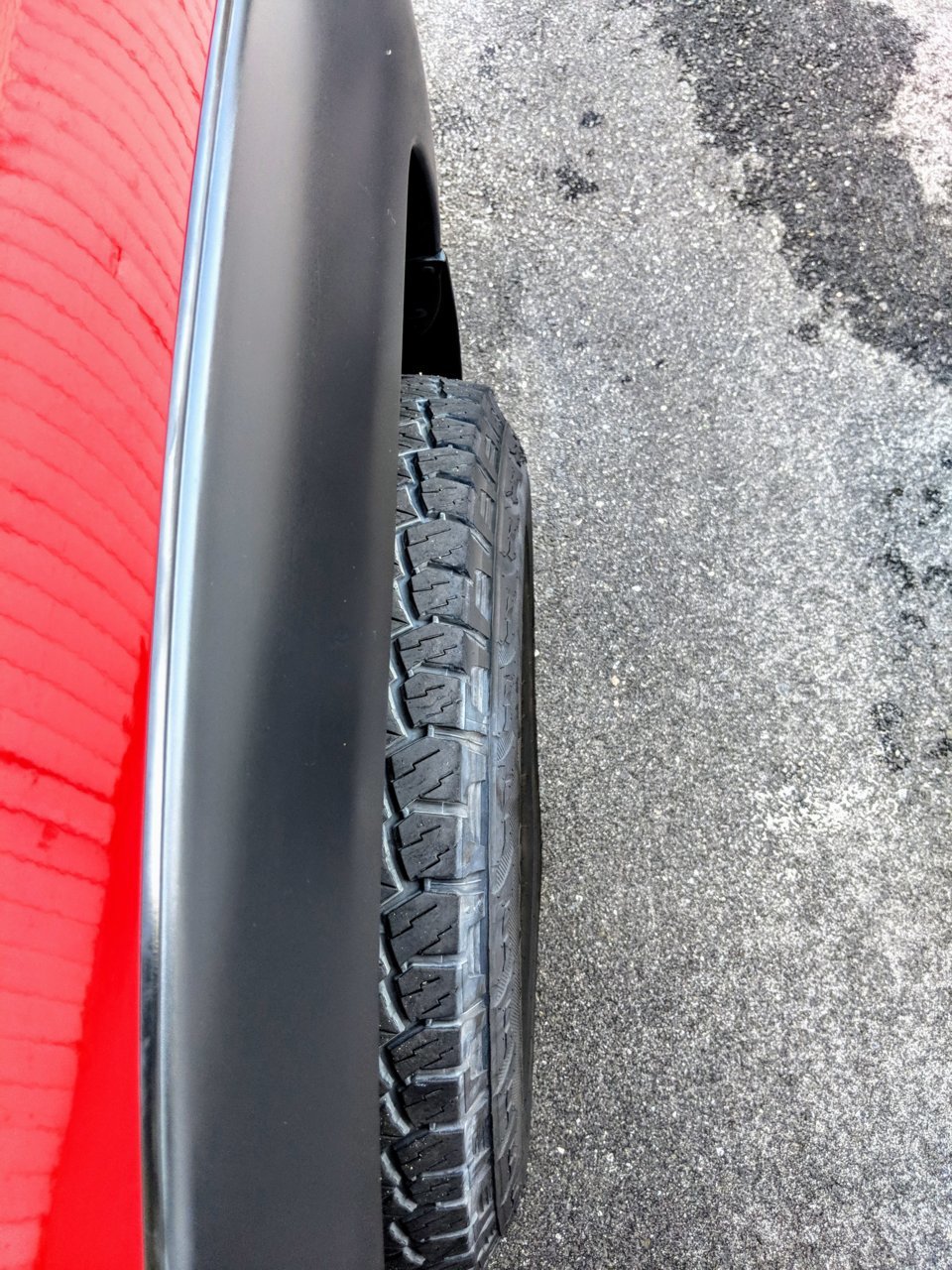

    Decided to give the truck a little love to the exterior yesterday. Scored an awesome deal on new ProComp Series 31 wheels in 16x8 (4.5BS, 0mm offset). I reused my existing Hankook DynaPro ATM 265/75's for now. I left my 1.5" spacers on, as I liked the aggressive stance it gave the truck now. Really happy with these! I think it goes awesome with the Barcelona Red, and black fenders/bumpers.

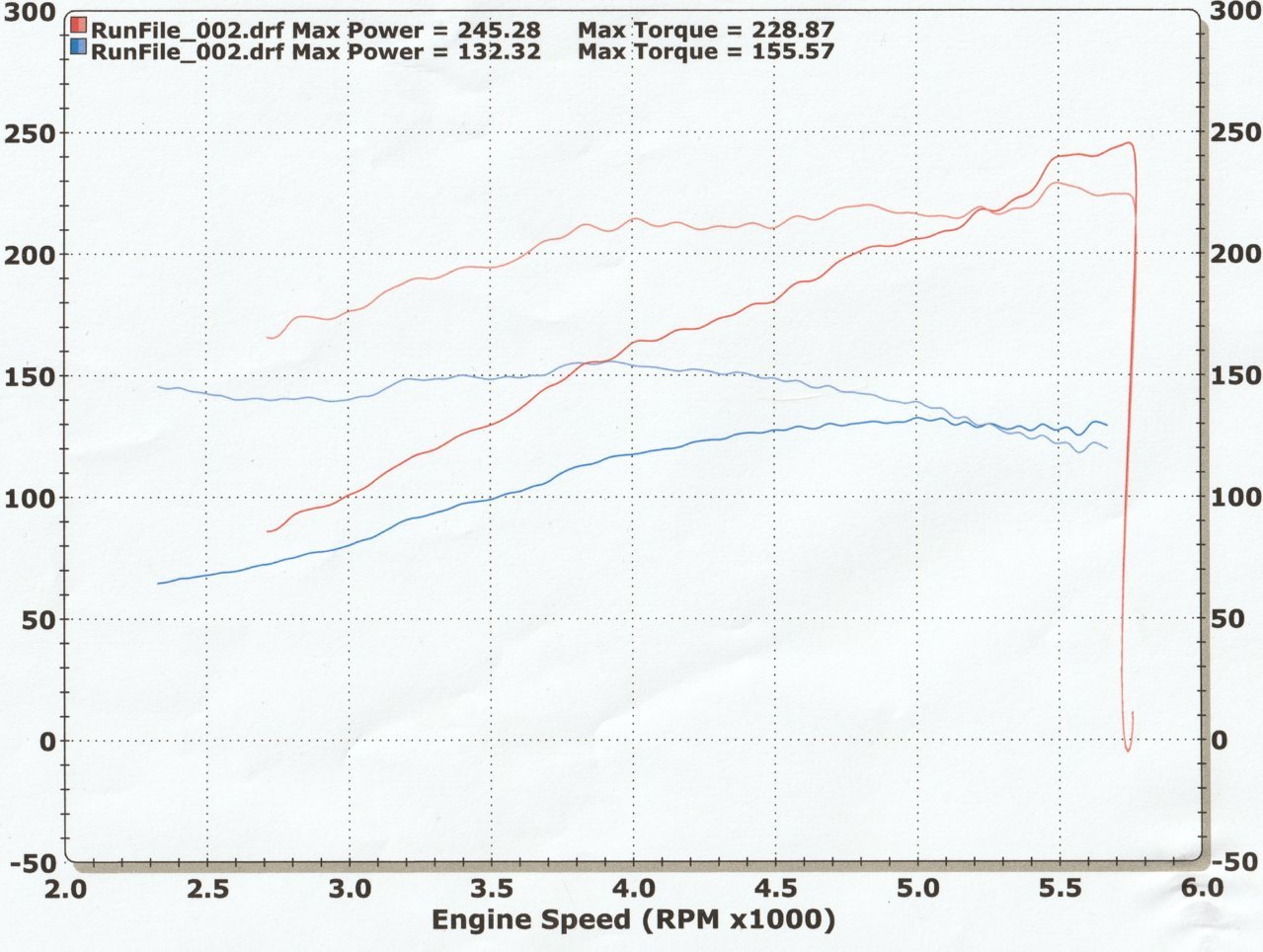

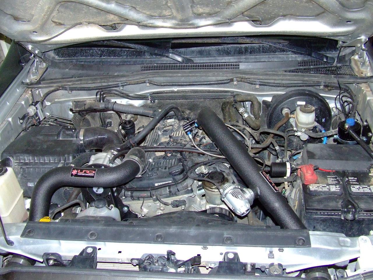

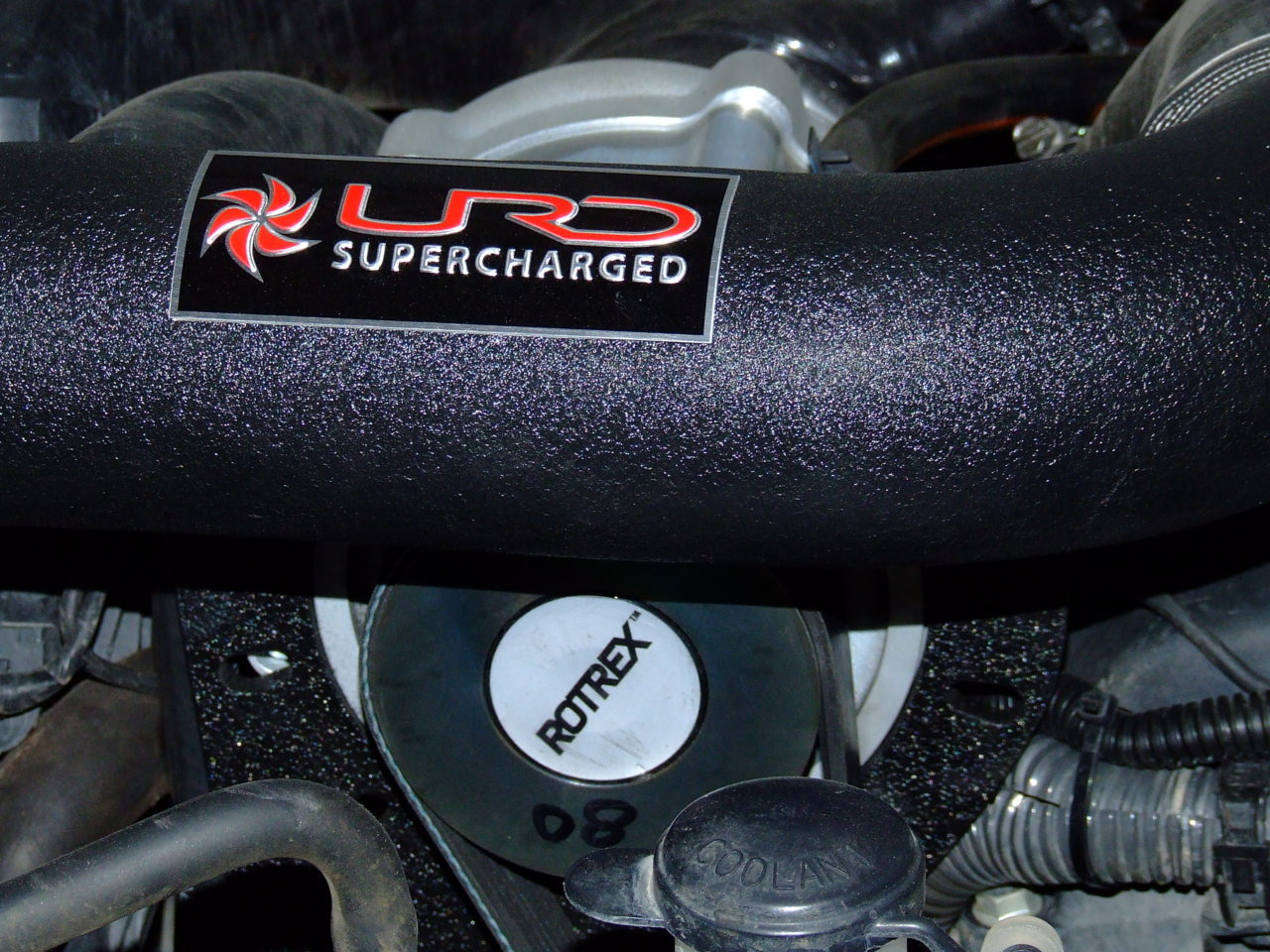

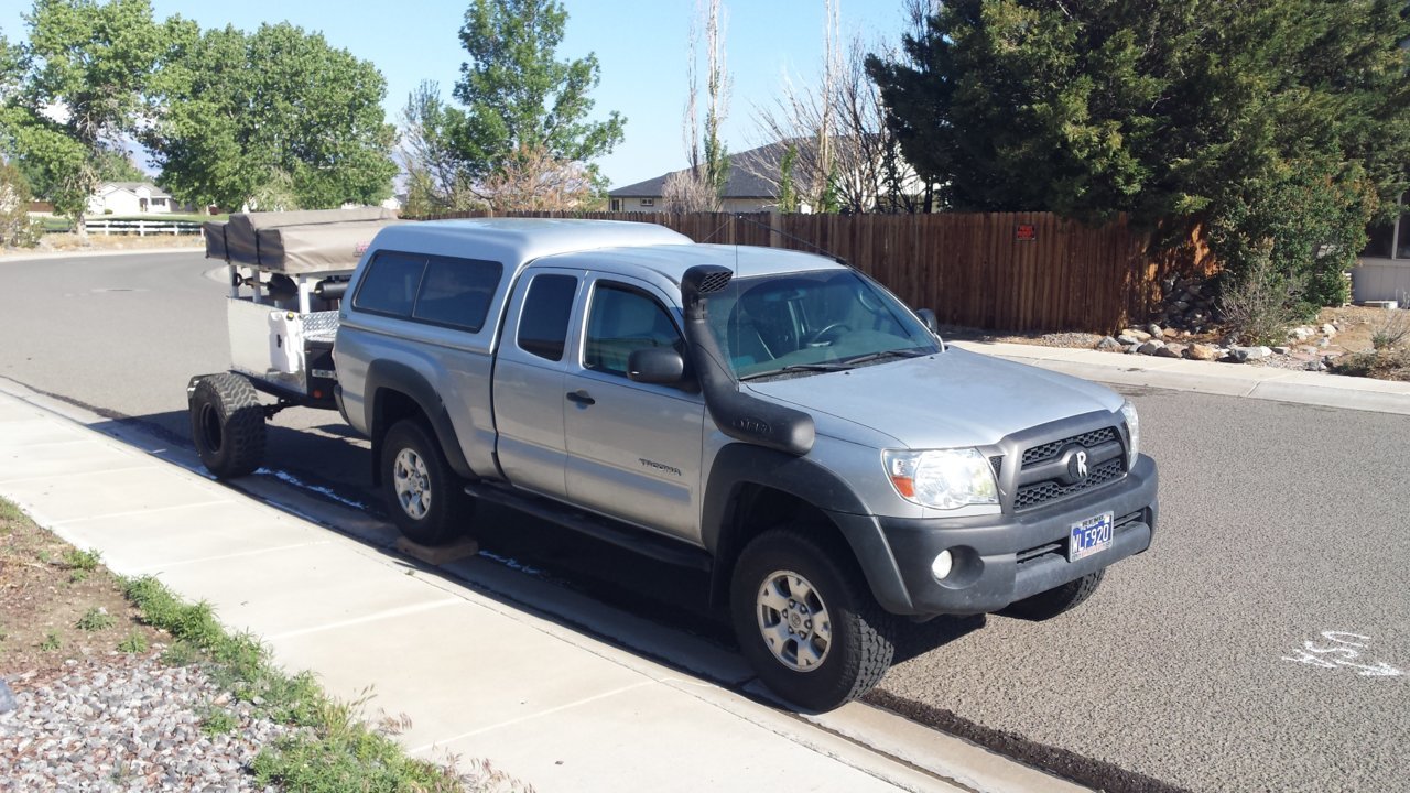

    I like what you've done with yours. I couldn't, so I went the other way.
    URD Mk3 Supercharger kit for 05-15 Tacoma 2.7L 2TR-FE 4 Cylinder
    URD 2TR-FE Stage 1 to Stage 2 Supercharger Upgrade
    LCE Header (a long-tube header in a short-tube package)
    Short throw shifter
    Upgraded clutch
    Magnaflow cat backTacoDyno.jpg DSCF4943.jpg DSCF4940.jpg 20180518_085133.jpg
