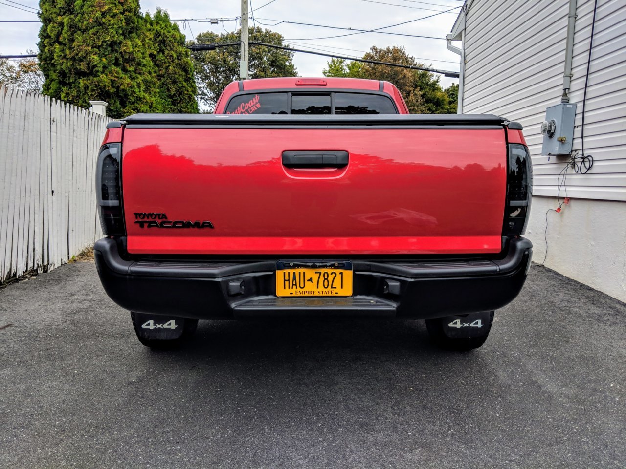

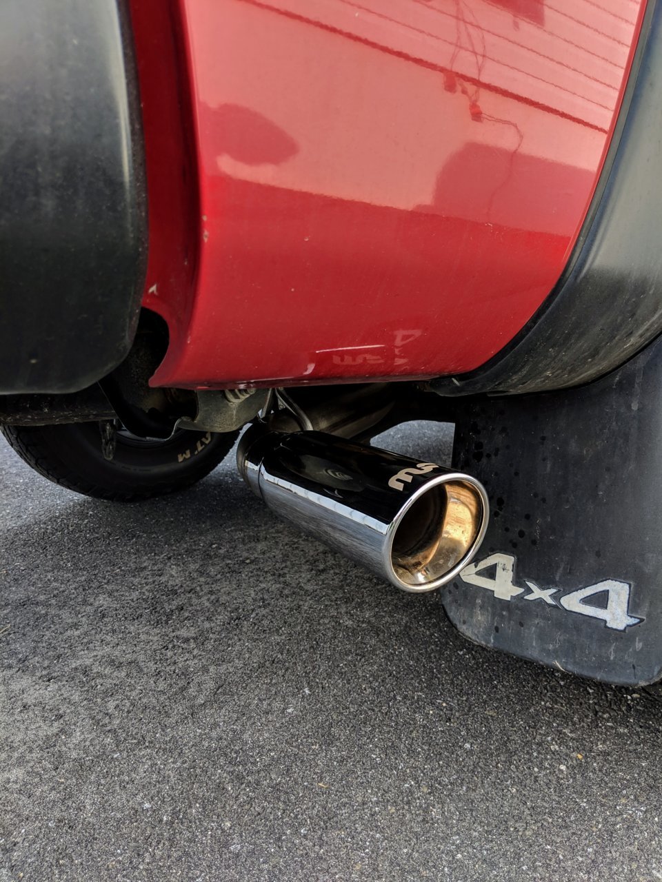

    Picked up a new Magnaflow 15240 catback on Black Friday for way below retail. I love the sound, as it's 2.5" to 3". It really mellowed out the tone, but gave it even more Boxer rumble. Plus it looks so much nicer!
    Swapped out the stock non-LED taillights for some VIPMotoz LED ones. Also changed out the chrome badges for black ones. Loving the look

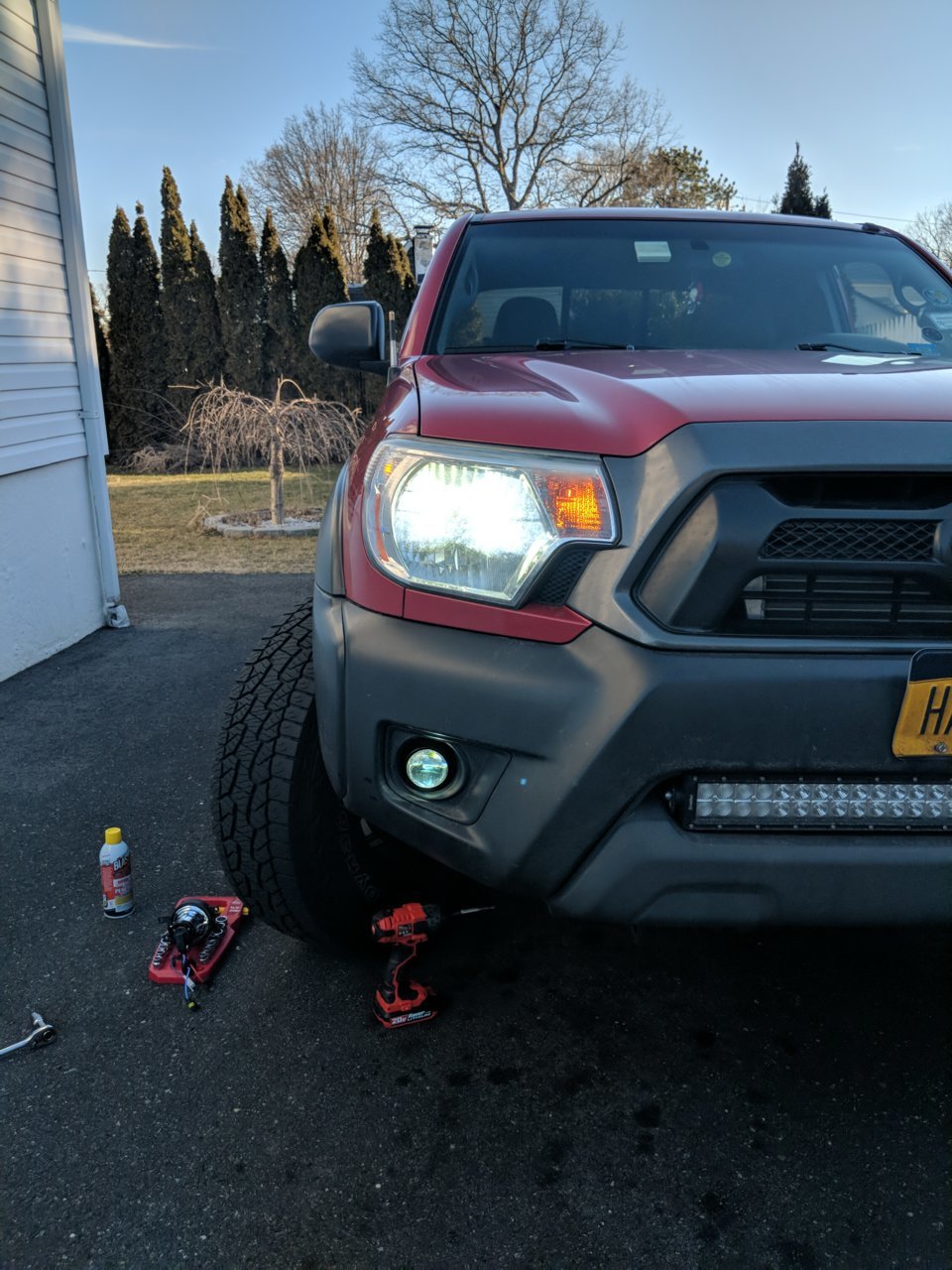

    Picked up some projector foglights from AliExpress, as per another thread on here. I'm iffy on the actual mounting bracket system, but they do look and perform really well! I left my 3000k HIDs in them, and it's a night and day difference.
