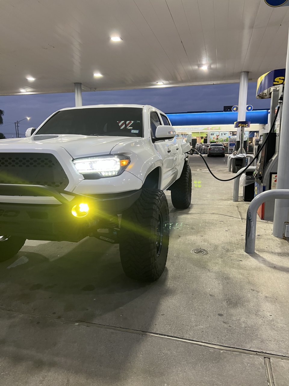

    I’m running 37x13.50’s on my 2010. For daily driving it’s great, only rubs in reverse now with a cmc and my caster kicked forward. But I’ll destroy my fenders and inner fender if I wheel like this. But I have advans for rims with this setup so I won’t wheel with this setup. I’m waiting for a good deal on some beadlocks close to me to pop up so I can go back down to 35’s and wheel comfortably again lol

    35’s are going to rub as well. Might as well leave the 37’s and chop chop!

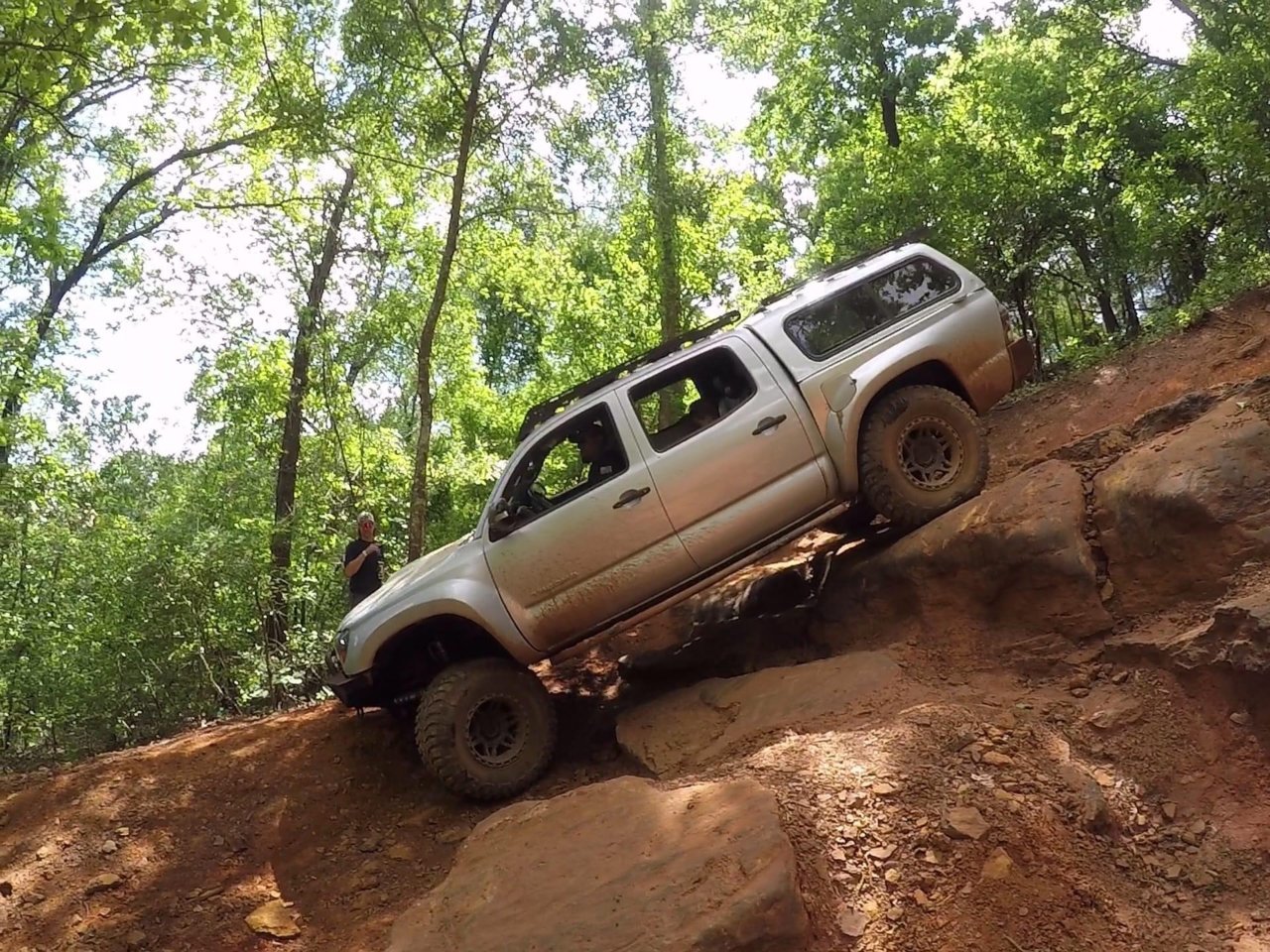

    Only time I would rub before when I was on 35’s was in the rear surprisingly but only when I was loaded down. Front cleared even at full lock and full bump.

    Funny how different these trucks are. When I had 35’s even with max caster they’d still rub on the top of the wheel well and firewall full lock.
