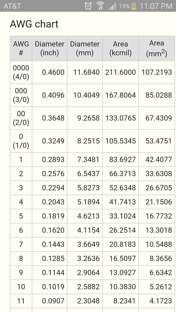

    My DC power roots from installing battery banks wants to use 4/0 (four ott) cable for everything lol

    Is that 4 gauge? I'll take some

    Bigger. Stock batt cables are 2 gauge, .25" diameter of the copper itself.
    I can pilfer my cousin's stash and see what he has that's flex, stranded would be too stiff
