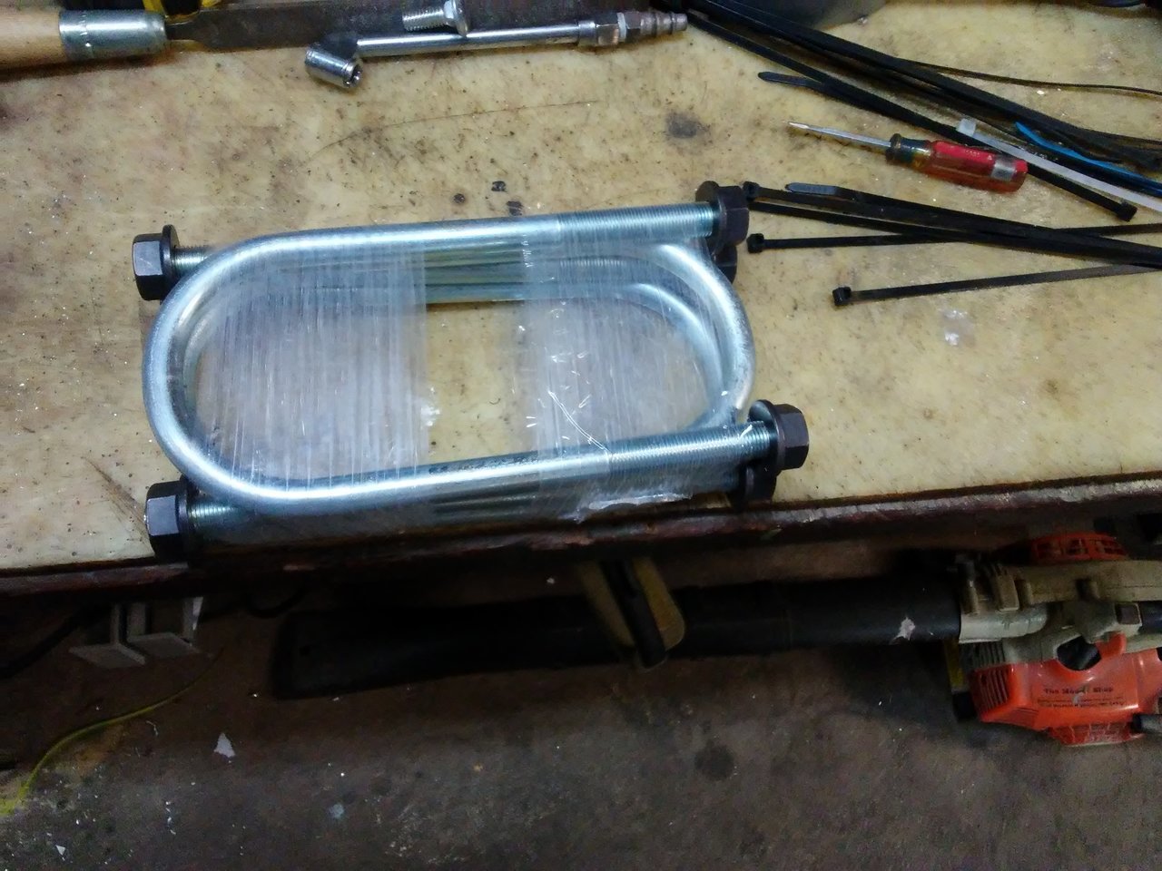

    My u-bolt flip kit was originally bought from Headstrong. They no longer stock it. It is EXACTLY the same as what AllPro currently offers. After having the original bolt on and off maybe 4 times for various reasons, the threads are starting to stretch. Last time I put them on, the nuts were a bitch to turn. So....I ordered new u-bolts from AllPro to have on hand. Next time I take them off, they will be replaced with the new ones.
    I have the invoice from AllPro in my hand right now.. It list's the size as follows;
    Rear u-bolt, 05+ (9/16" x 3.25" x 8.5")
    AllPro part # 4404-AP-05
    They are an EXACT match for what is on the truck. With stock leaf pack + 1/2" thick AAL, there is 1-1/4" of threads exposed above the tightened nuts. I can use 1" block in addition to what I currently have, or thicker leaf pack and these u-bolts would be long enough.
    dirty deeds[OP] likes this.

    What they look like.....
