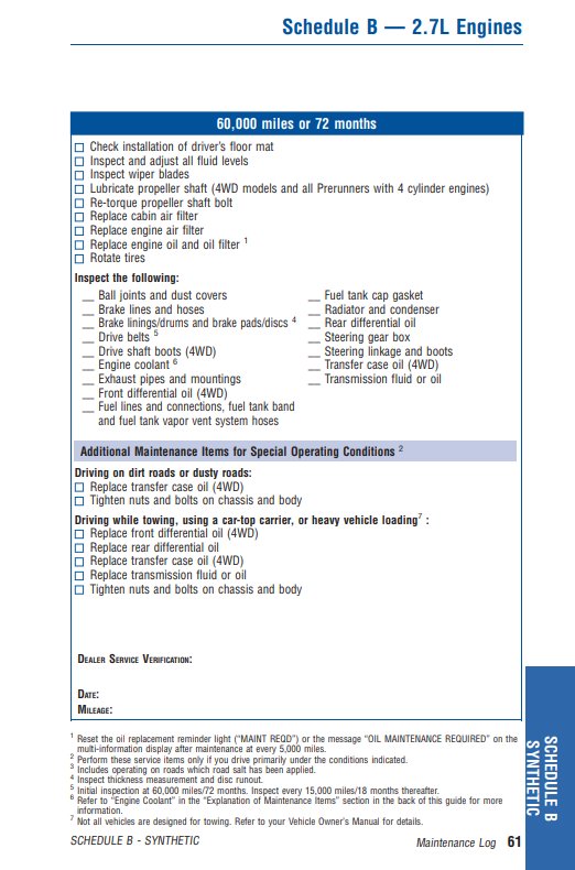

    60k mile service this weekend

    Straight dino blood for the diffs and t-case (gonna get mud in em anyway so why buy high dollar shit to just drain out again), Redline MT-90 in the transmission, $13 fleabay filters FTMFW go into the cabin and engine, torque check all the things.
    Picking up some tools at good ol HF on my way home. Then swing by WelfareMart for dino erls.
