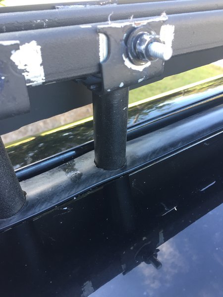

    What brackets are used/made to attach the rack to the roof? And I don't believe that 1/4-20 hardware would fit the 4 holes in the roof.

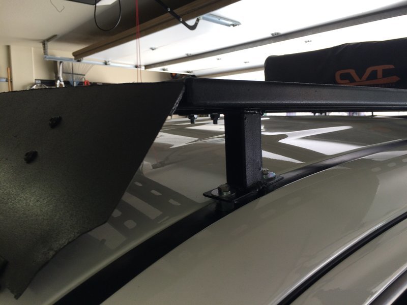

    Not my picture, but mine bolt like this. The bolt goes down through the pipe sleeve into the holes. On top of the sleeve is an L Bracket that my rack sits on like this then is bolted to it just like this.
    If you have a welder, this seems to be a good way as well and you can use smaller bolts to go into the holes and be done with it. My bolts were barely long enough the bolt through the sleeves and into the threads to allow the rack to clear the truck top. I could've used about an extra 1/4" long bolt but it was hard enough to find these long enough to begin with.
