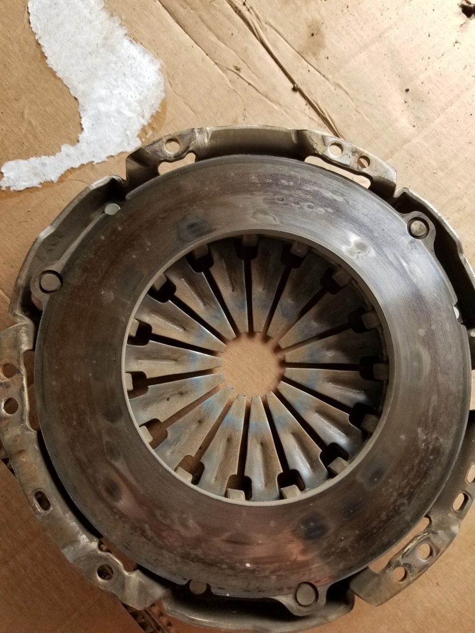

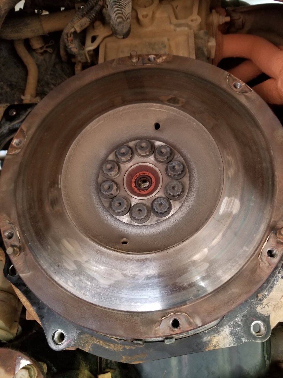

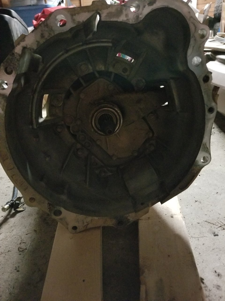

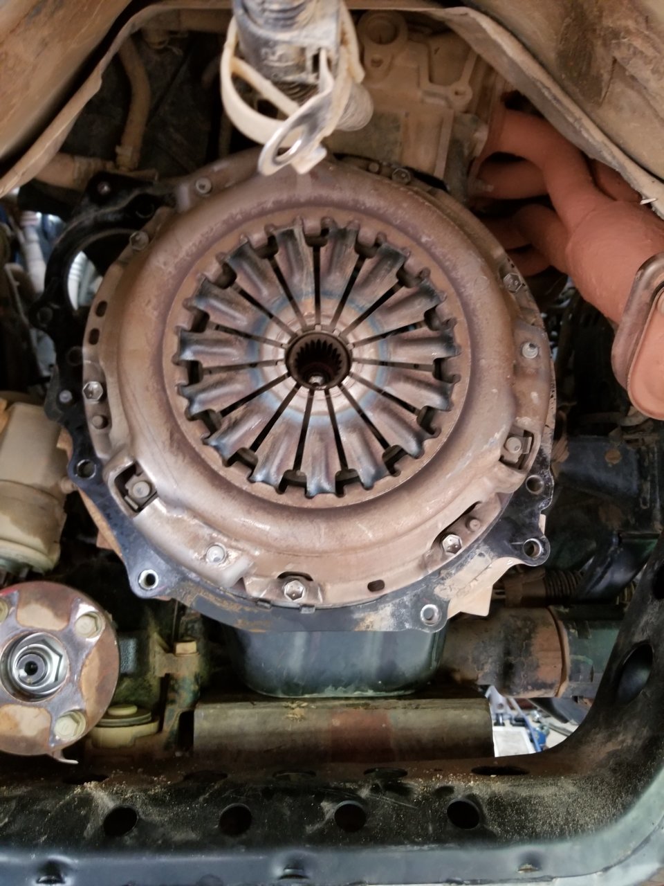

    20180916_002051.jpg 20180916_094045.jpg 20180916_094840.jpg 20180916_095023.jpg
    They've got some hot spots. Good amount of clutch material left, which I figured to be the case. As you see, hot spots everywhere, but no major discoloration or anything too deep. Think I can get away without a resurface.
    Replacing everything but the flywheel regardless.
