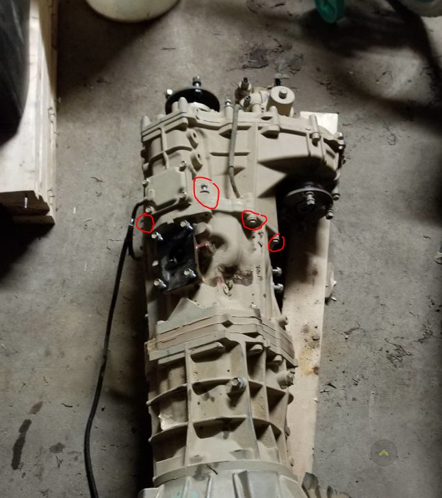

    Anyone know where I could separate the t case from the trans? Without needing to source gaskets and seals that won't be in stock at VatoZone or the like? Or losing all my fluids?
    If none of the above is possible, I'll just wrestle this bitch in again. Inquiring minds.

    No seals or fluid will need to be replaced if you keep them reasonably level. Getting the top tcase bolts in the truck can be a bitch though

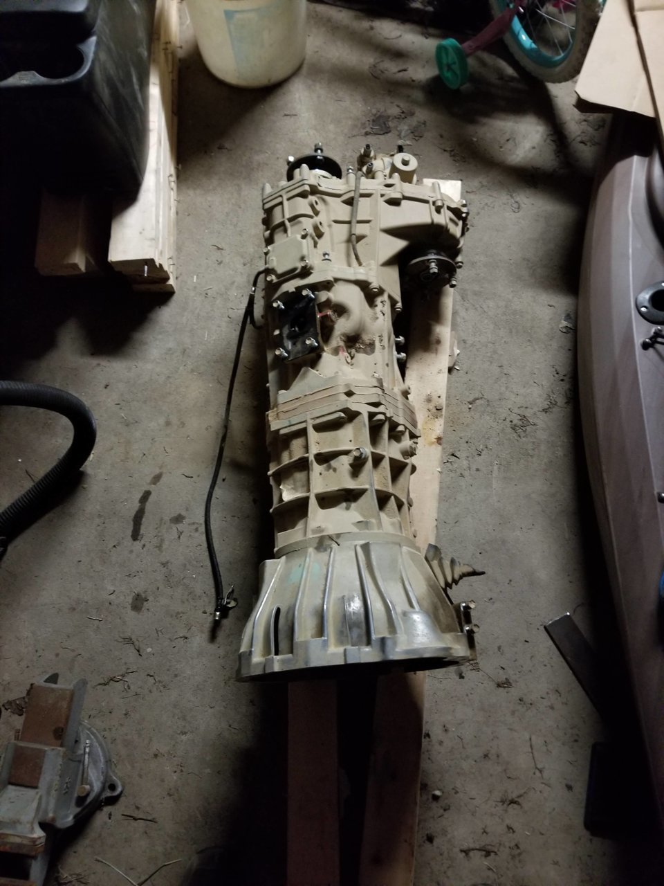

    Right. As seen in that pic, about a quart of MT90 ended up in my driveway through the shift lever hole.
    Gid was telling me I'd have to replace gasket and or seals if I separated parts. Just trying to make this thing more manageable if possible. Not sure where I can split it

    Pull these bolts all the way around if you want to split the tcase from the trans. The void between the tcase and the trans doesn't hold any fluid and has no sealant, there's just a trans output seal that the coupler from the tcase slides into to keep the fluid in the trans.

    I'm gonna give it a whirl!
    You sure there's not gonna be a bunch of fluid leak out? Again, through the hole for shift lever is how fluid got lost on Saturday night when we first got it out.
