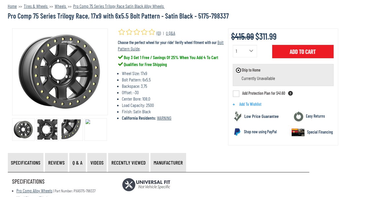

    Real beadlocks and they sell them in raw aluminum if you want to paint them to whatever you like too.
    Wheel mfg aside, if you're serious about wheeling, look really hard at getting beadlocks. More expensive up front but then you won't be left wanting down the road. I've got the pro comps and they don't lose air either.

    I'm really more partial to steel wheels and the ability to bend one back if needed. Can't with alloy, or at least without getting real lucky.
    Just don't think steel and beadlock is a thing, that I've come across and didn't make me wanna throw up prices

    https://www.alliedwheel.com/p-1526-rt81-rock-8-steel-beadlocks.aspx
    Allied makes affordable steel beadlocks. They are quite a bit heavier than aluminum though. My 3RZ needs all the help it can get, so aluminum is is for me.
