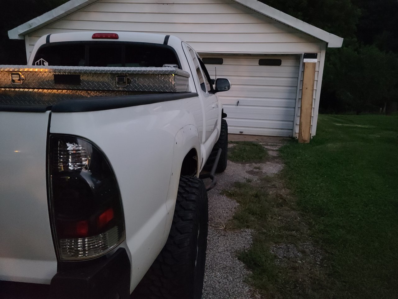

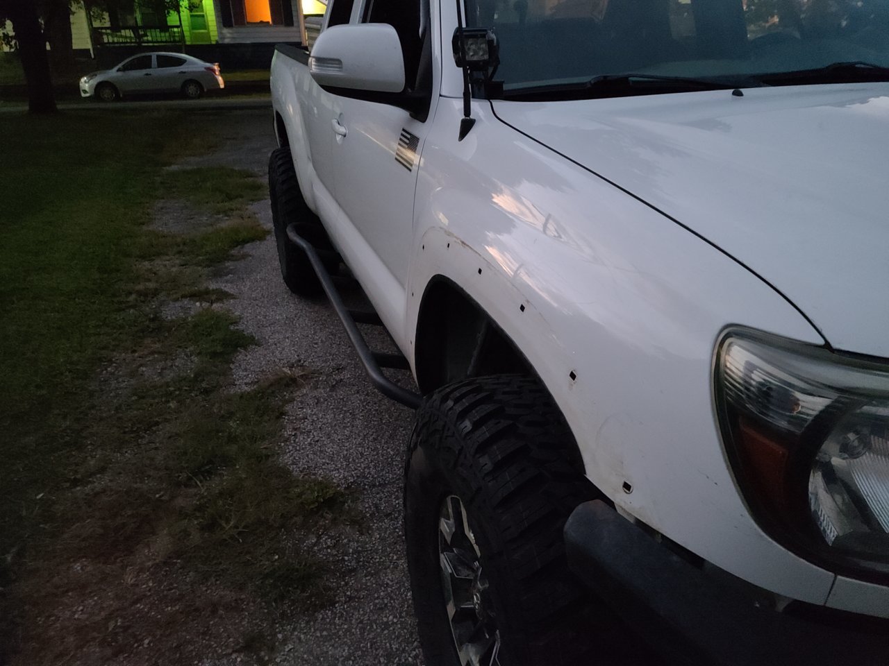

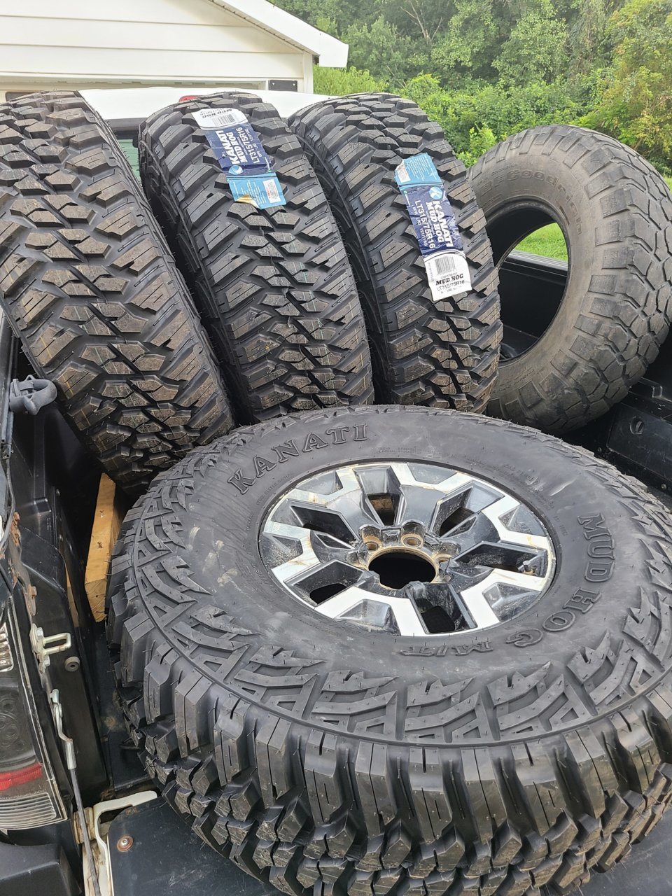

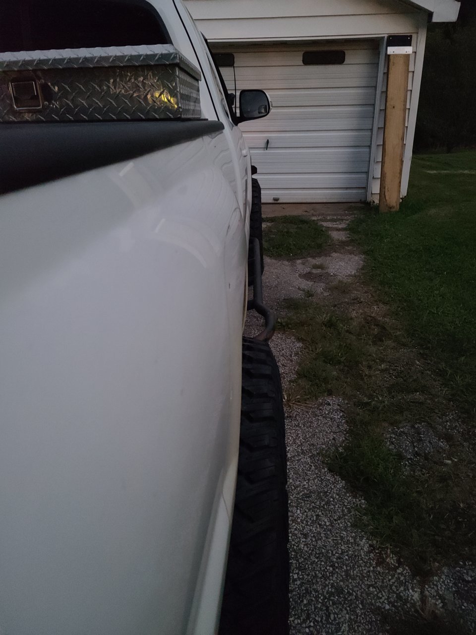

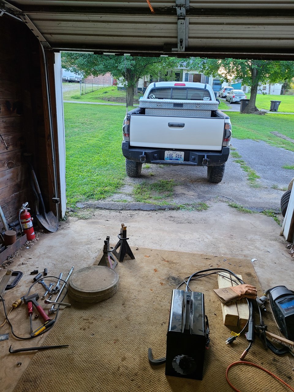

    35s and no dirty vibes!?
    But I'll take it!

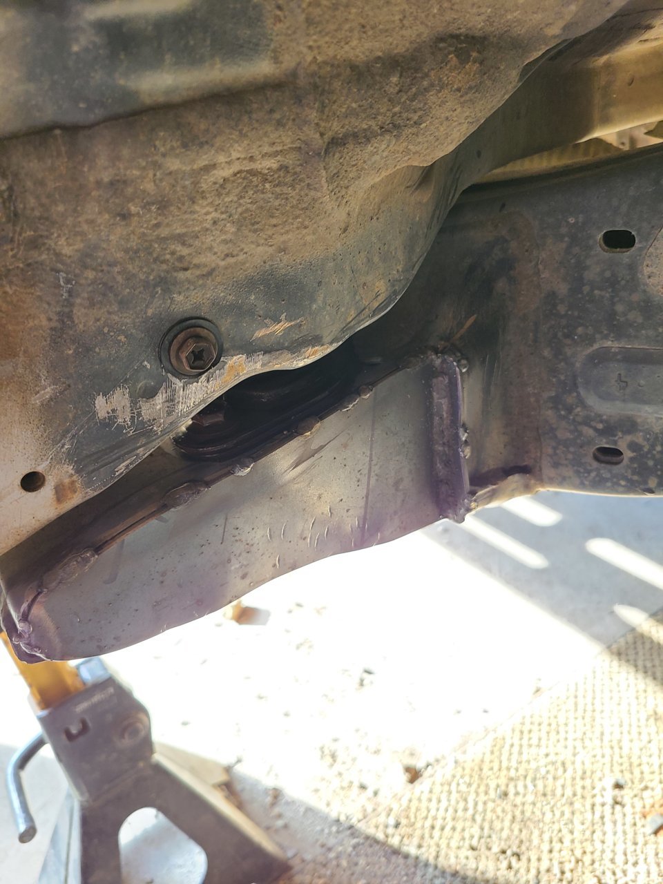

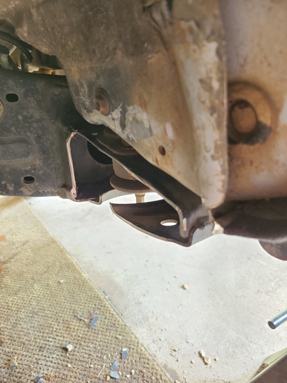

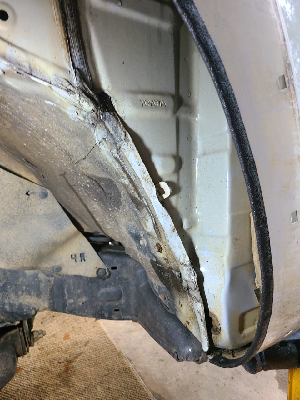

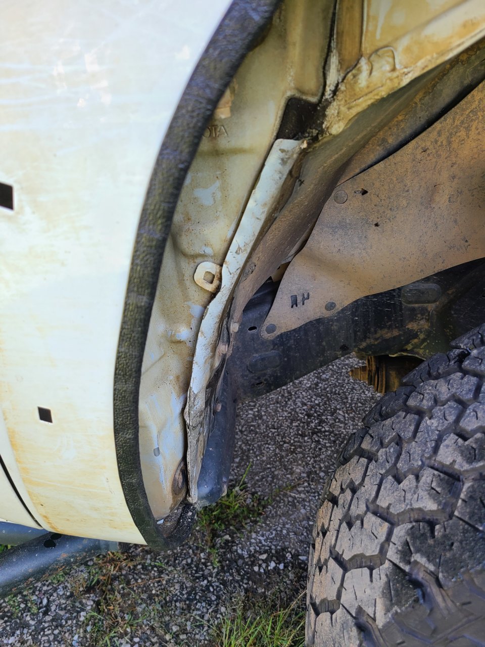

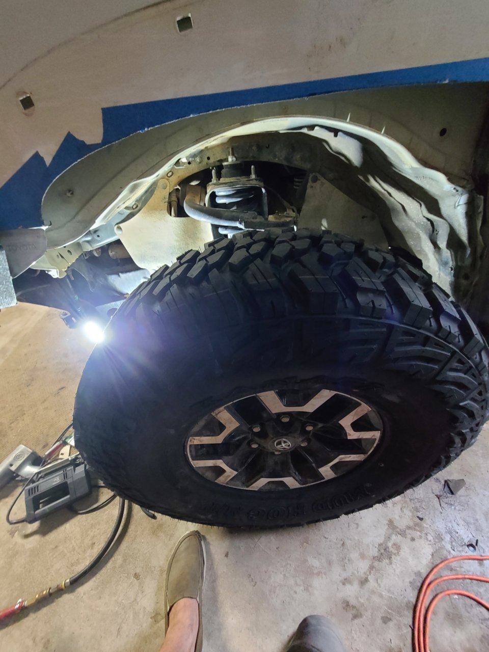

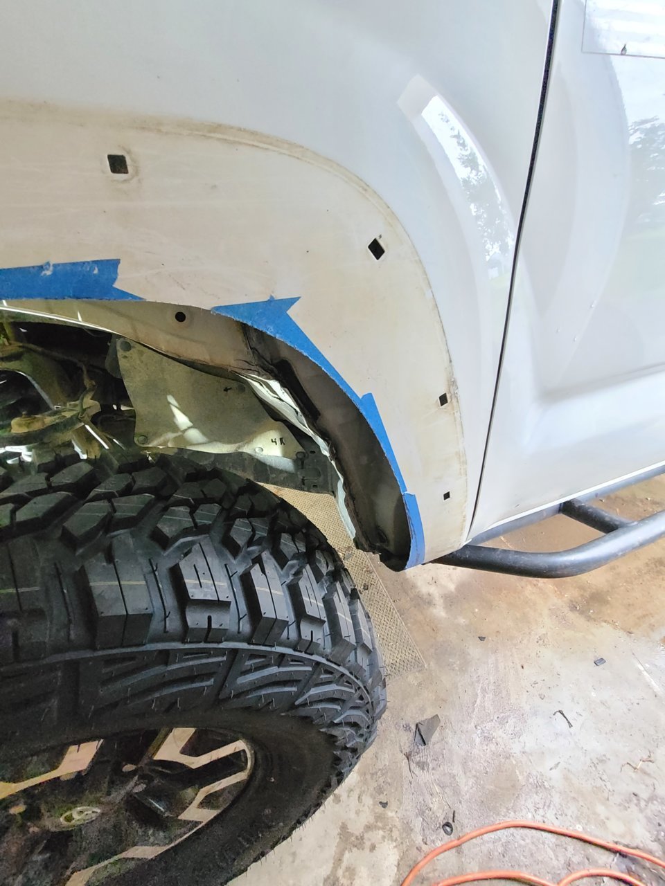

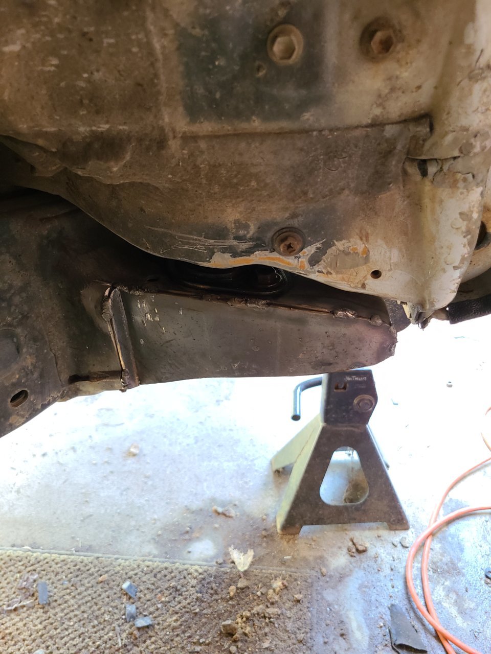

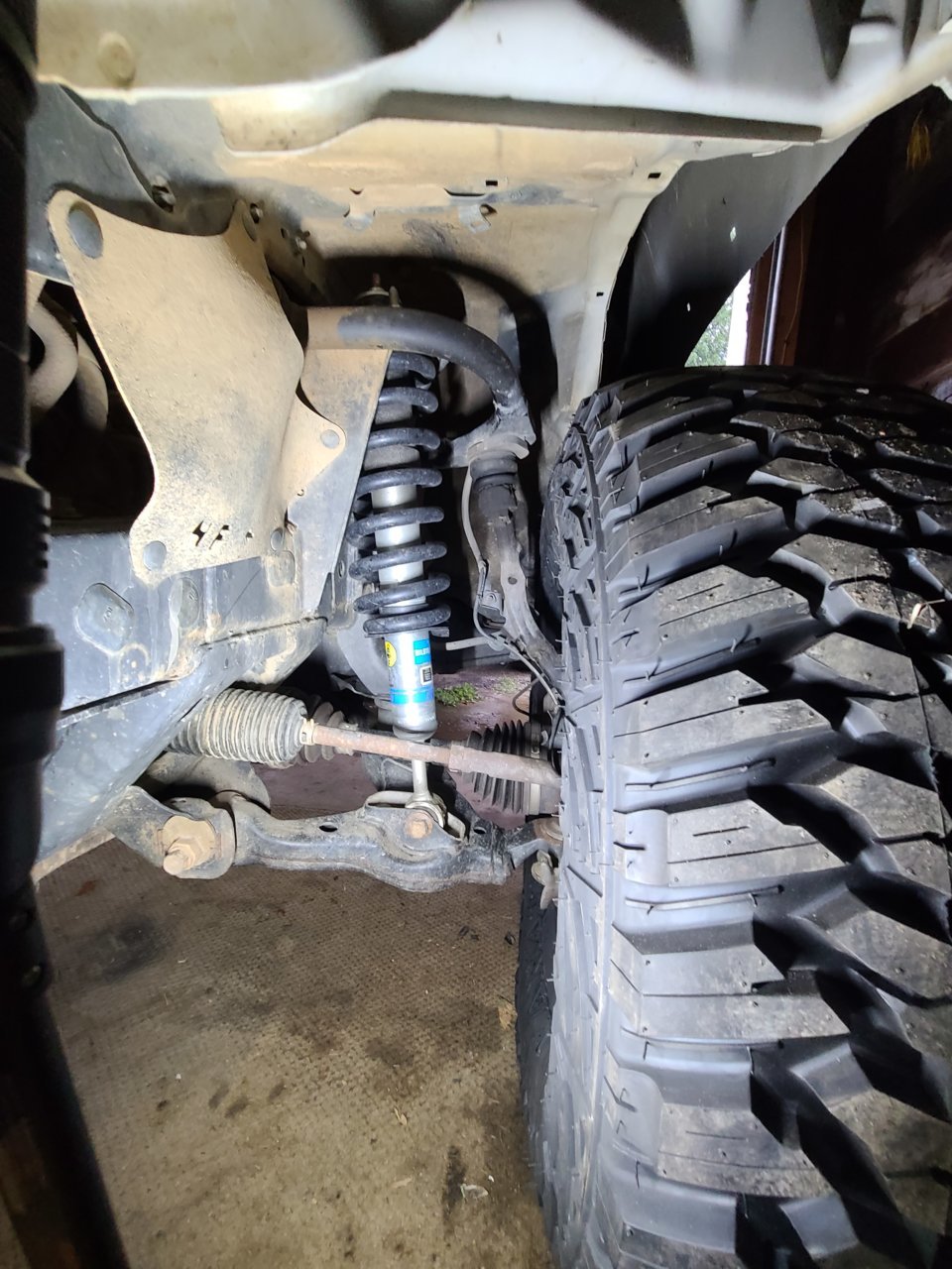

    Pinch weld first, beat in some other protruding parts inside the fender well, then the CMC.
    20200822_180258.jpg 20200822_180310.jpg 20200822_180326.jpg 20200822_180339.jpg 20200822_193242.jpg 20200823_095405.jpg 20200823_150009.jpg 20200823_180914.jpg 20200823_180943.jpg
    Driver front fender needs a bit more slope to the bumper, I'll fix that when I paint after work tomorrow. CMC plates are tacked fairly well into place for now, after the Rush meet this weekend I'll know if I need to cut more.
