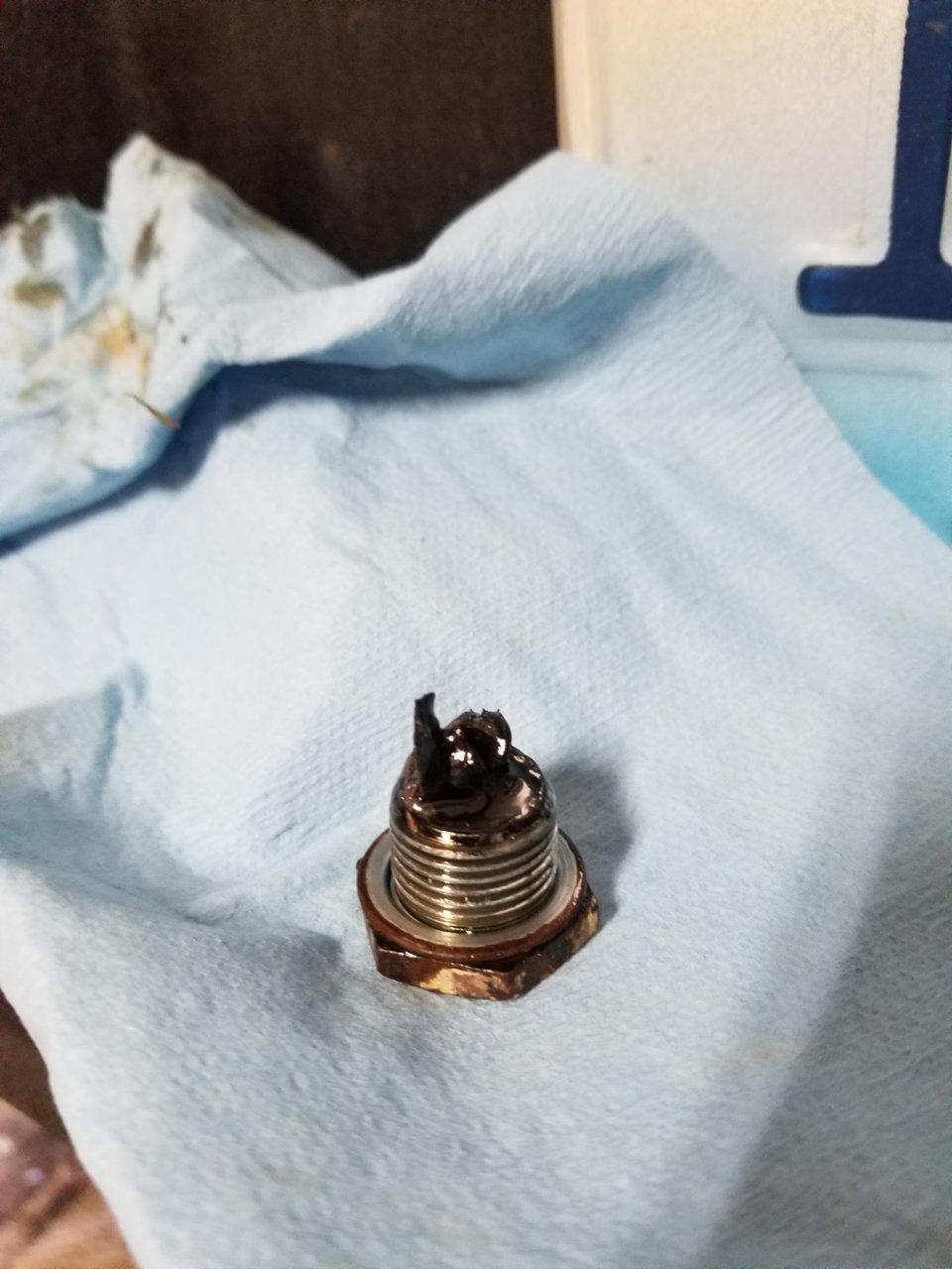

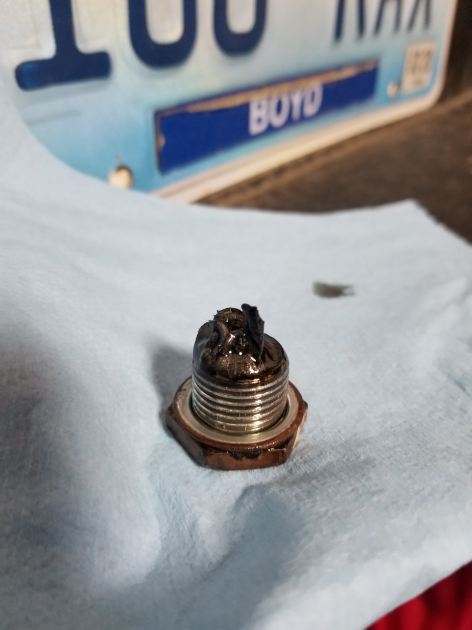

    One year later!
    Still okay so far. Went ~6 mos without a rear, been ~6 mos with the new in. I've not had to crack it back open since break-in, but I'm still a little gun-shy over the failure. My driving at Rush in August would say that's a lie lol!
    Man oh man! How I wish were both wrong here. Definitely was a spring failure.
    A sizeable chunk of one must've found it's way into the gear mesh so perfectly it made the pinion hop on the ring teeth, chowdering up at least 4 of them. I stand on this platform, though; when I was at Rush with my cousin in Oct '19 and tried to climb a rock face, I hit the DS enough to cause some movement, which then caused the eventual spring failure. In my case.
    FYI, I'm not the only person to have found pieces of springs from these lockers. I should be an okay human and contact ECGS or Richmond and let them know what I've found, for the greater good. On the flip side, there are plenty of others that haven't had this issue at all. #notsureandindecisiveAF
    Still not going to an air locker. That'd be more annoyance than squeaking poly bushings and a clutch install!
