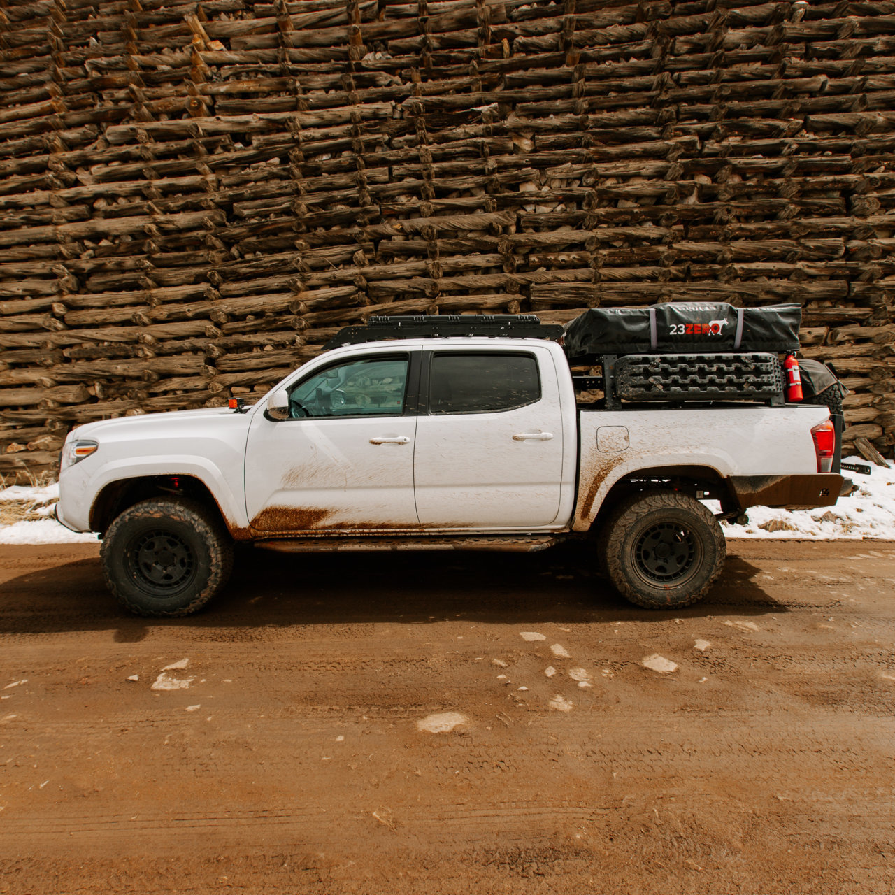

    The photos everyone is here for (from the last 6 months, so some will be missing current mods):
    5X8A0214.jpg 5X8A8519.jpg 5X8A9976.jpg IMG_20200825_203533_Original.jpg 5X8A9953.jpg

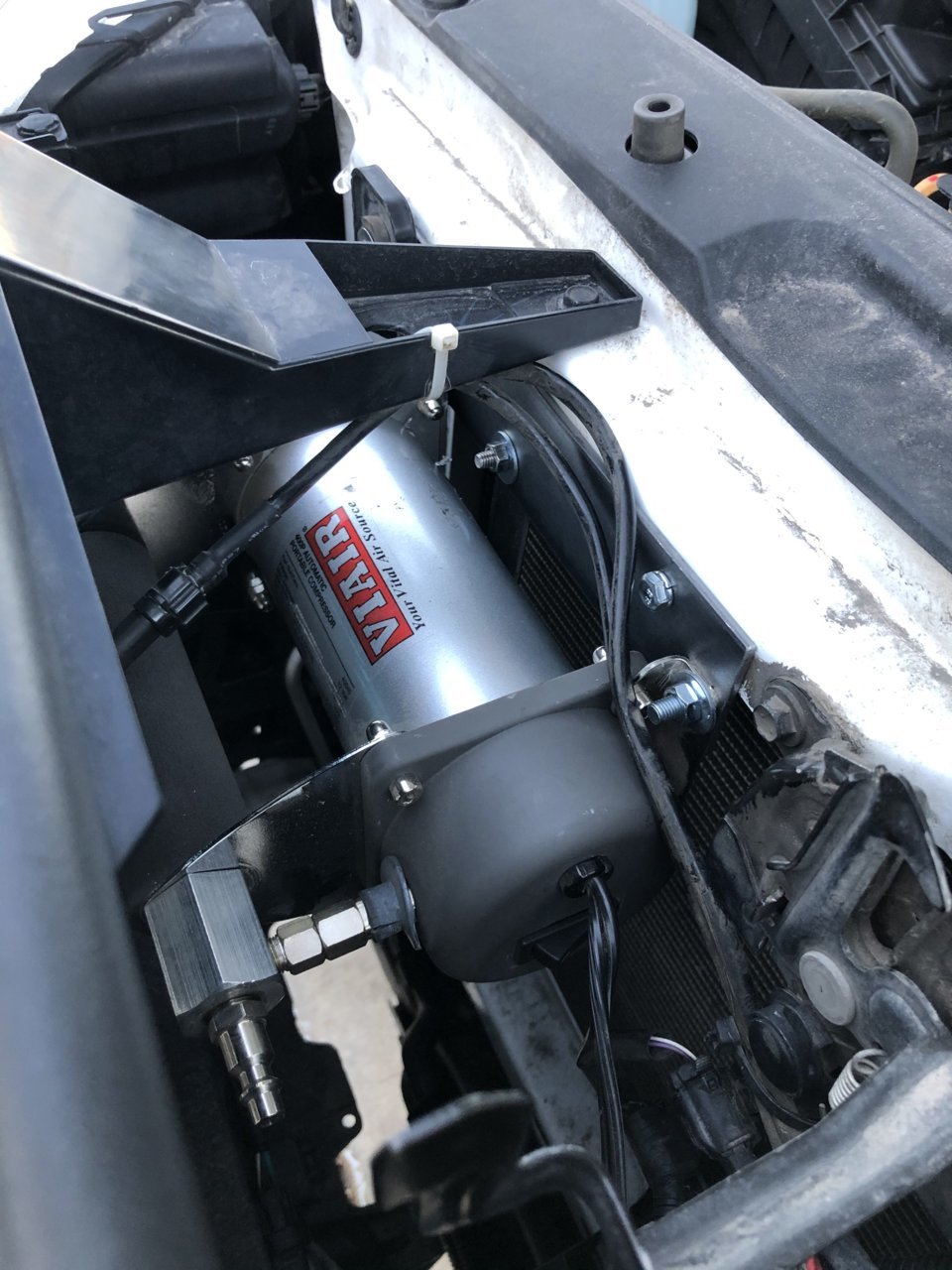

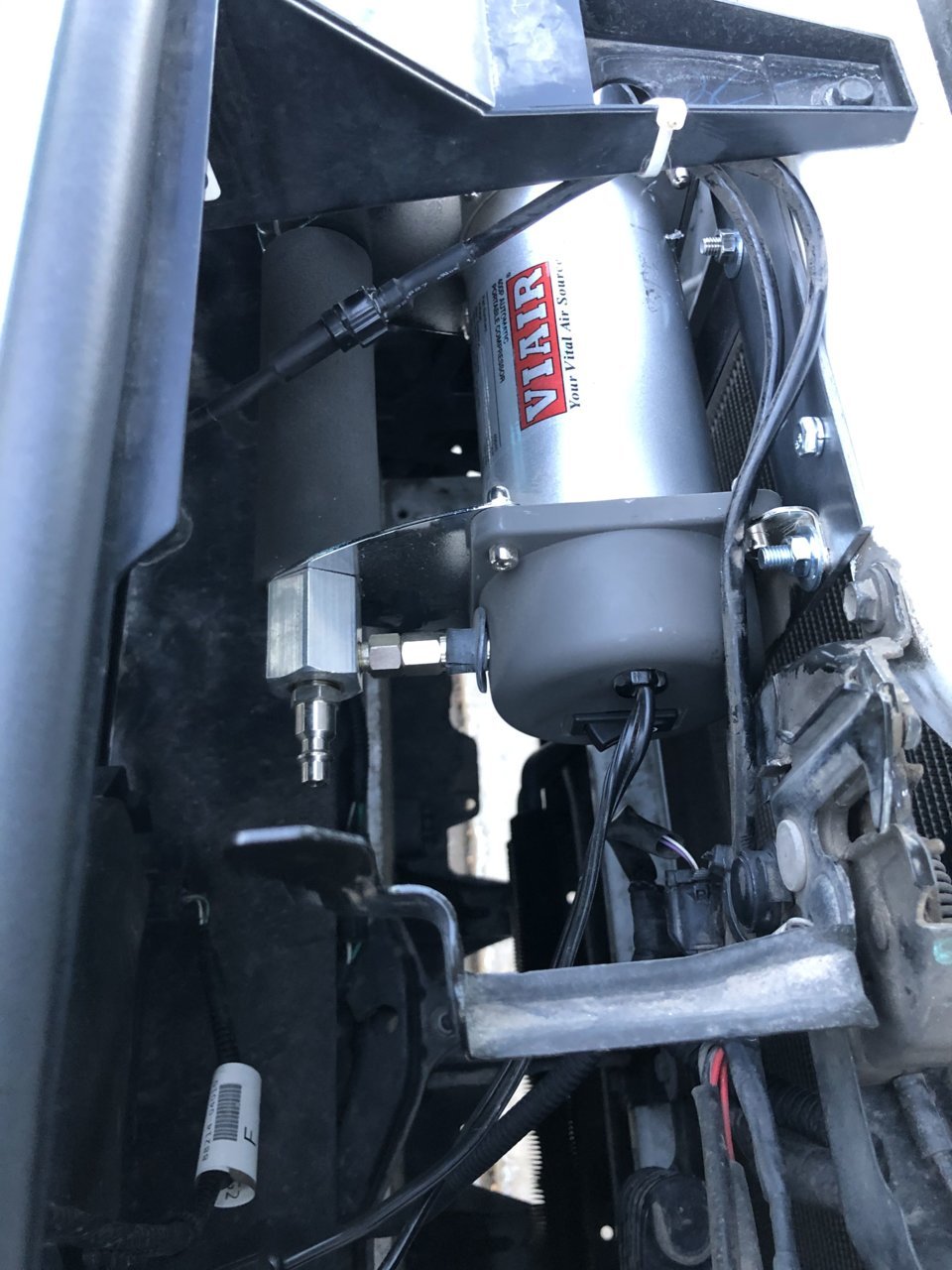

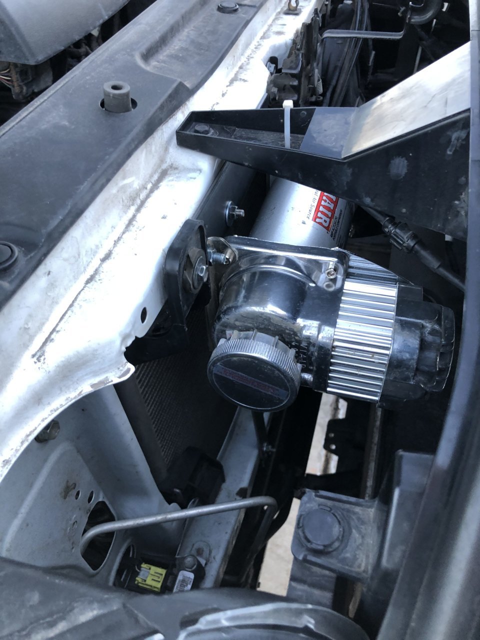

    Any chance I could see a pic of your Viair Compressor mount set up?

    Super jank and temporary mockup right now. The plan was to use it for testing and measurements, then I will CAD design the final bracket and have it laser cut from SendCutSend. Might even sell them if they turn out good. I have rubber isolators ready to put on when I make the final bracket, but it's held up for over a month of use so far without them.
