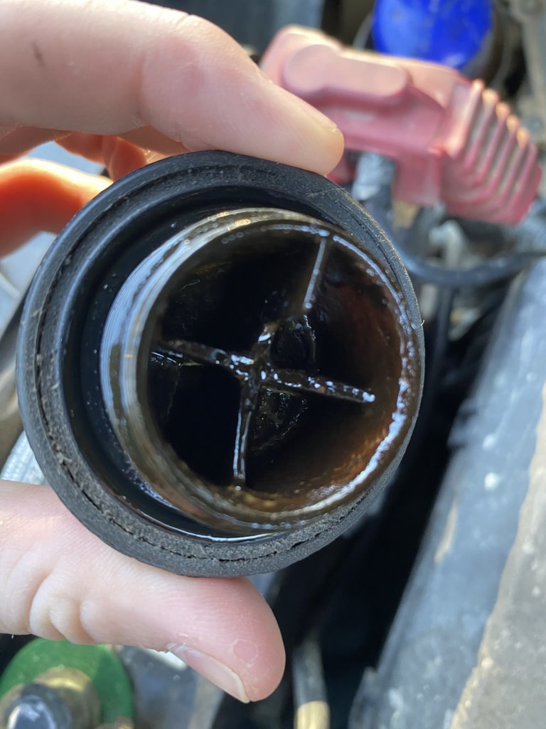

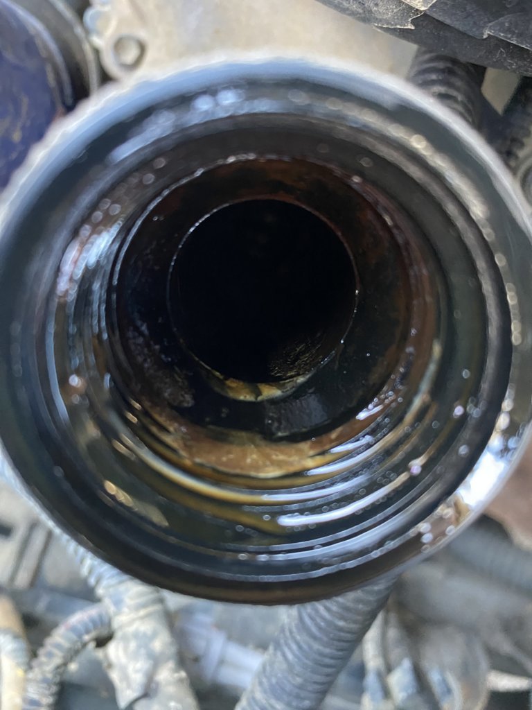

    Opened up my oil fill and this is what I am seeing. Any idea what this is? This is the trucks first oil change with me.

    condensation in the oil is all it is
    when cold out, it condenses in the cap
    23MGM likes this.

    But the white?

    Yes, the white stuff is an emulsion of oil and water

    Many threads on here have, as their focus, your same findings.
    The resolution is to get the engine to operating temperature, especially during the cold months, and to avoid short distance driving.
    Clean the cap with some brake clean, change the oil, and follow the recipe.

    The milky looking stuff is normal condensation especially in cold weather, the brown crusty stuff suggests the PO may have been neglecting oil changes and/or using shitty oil.

    Clean out the sludge the best you can with a rag and next time you take the truck on an extended drive (preferably a round trip at highway speeds for 30 mins or so) remove the cap and check it: The moisture/sludge should be reduced/diminished or gone.
