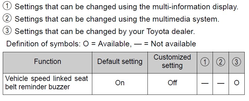

    Just bought a 2019 and I want to disable the drivers side seat belt chime (not necessarily the passengers side). I see several threads on this saying that a dealer may do it, or if not, the Carista app can. I was wondering if anyone had accomplished this by disconnecting the sensor? That worked fine on my '95 Tacoma but the 3rd gens are a little more complicated.

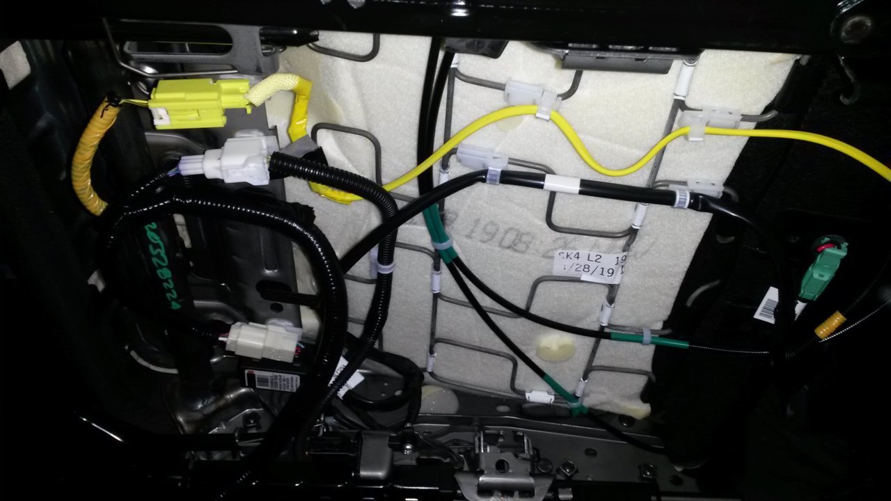

    I took a pic under the seat and there are a lot of connectors so I thought I'd ask for some advice before I started unplugging things. Here's a picture of what's under the seat. Note that I have the heated seat option so there's more wiring than some vehicles will have.
    Anyone know if one of these can be disconnected to trick the system into thinking the belt is plugged in like on the '95. And if so, which one is it?

    You can’t trick it with basic wiring, I tried opening & closing the circuit going into the seat belt itself. Both ways resulted in the air bag light coming on.
    I’ve just been dealing with it since.

    Ask the dealer during a service- I did and no questions were asked

    If you disconnect the wiring you’ll get an airbag light.
    If you want the dealer to do it, tell them during your next oil change you often sit a package or something on the front seat and the weight of it picks up the sensor. You request to have them disable the chime. They should do it for free.
    Pro tip: I worked in dealerships for 10 years

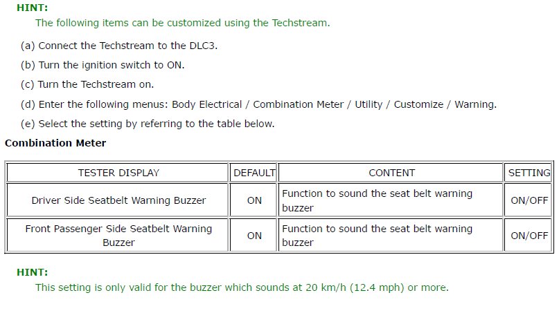

    Go the Carista route. Super easy, plus you can change a few settings with it you may not even realized you wanted. You'll also be able to pull codes from the truck in the future without taking it to the dealer. It's a nice tool to leave in the center console.

    Get Techstream and buy a techstream cable off Amazon.
