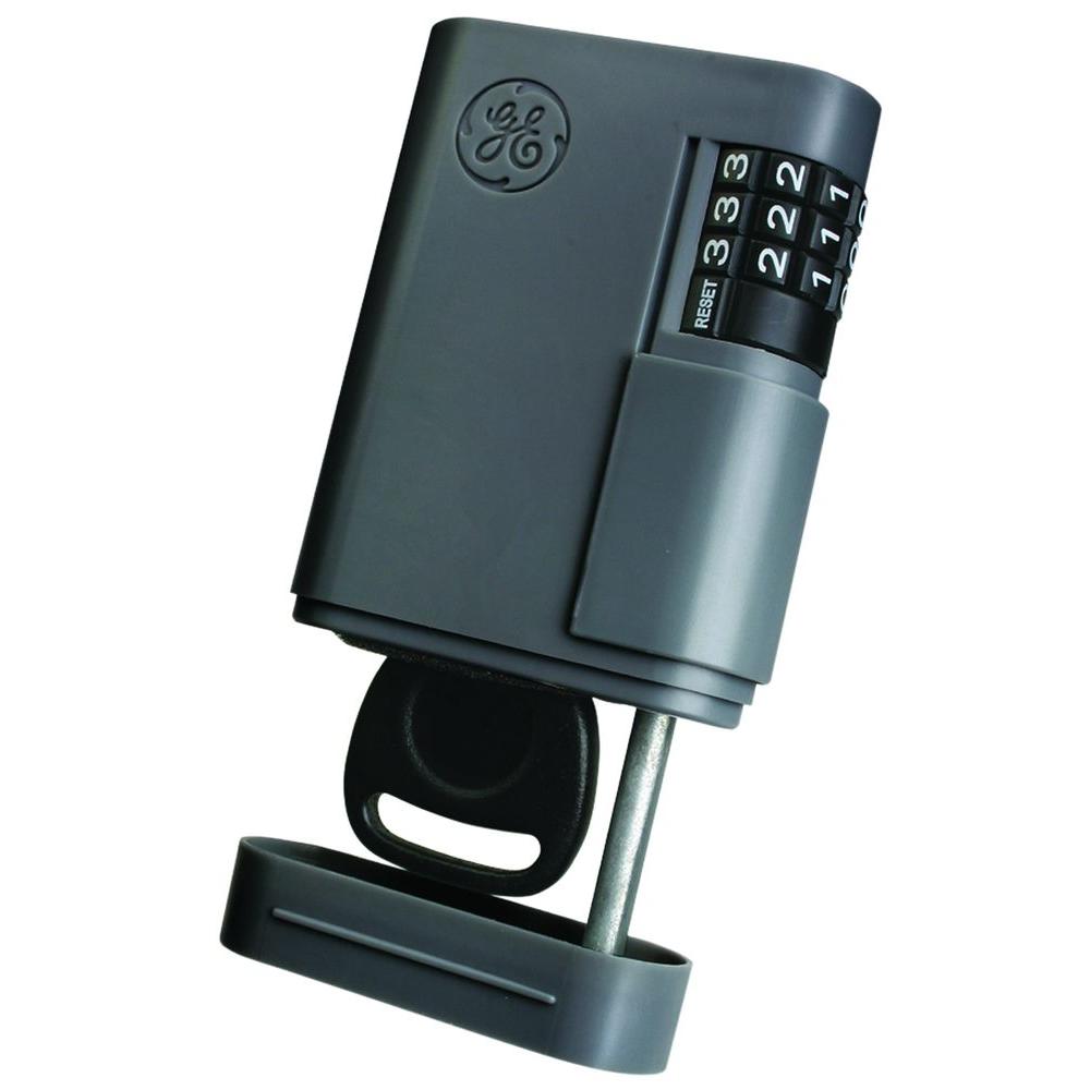

    Just put the key in a combination lockbox and stick it to the inside of the frame. Only $6: https://www.homedepot.com/p/Kidde-Stor-A-Key-Locking-Key-Safe-Charcoal-001859/202072799
    Cut a metal key so it can open the door but won't start the engine.
    But yeah figure out why you're getting the false autolocking to begin with. Faulty door switch. Aftermarket alarm you didn't know about. Whatever.
