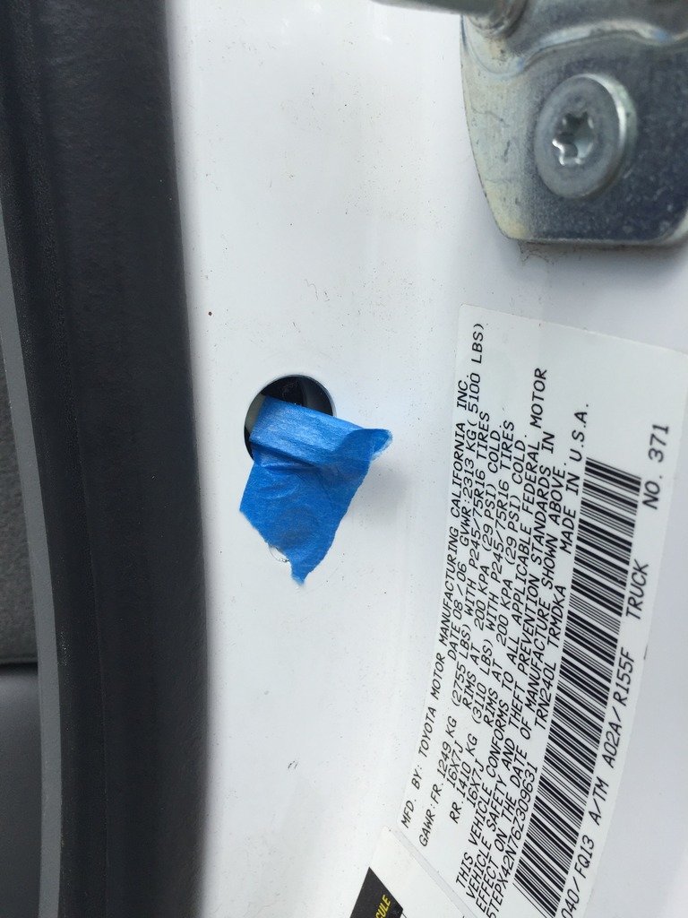

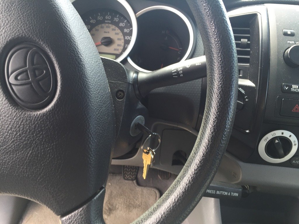

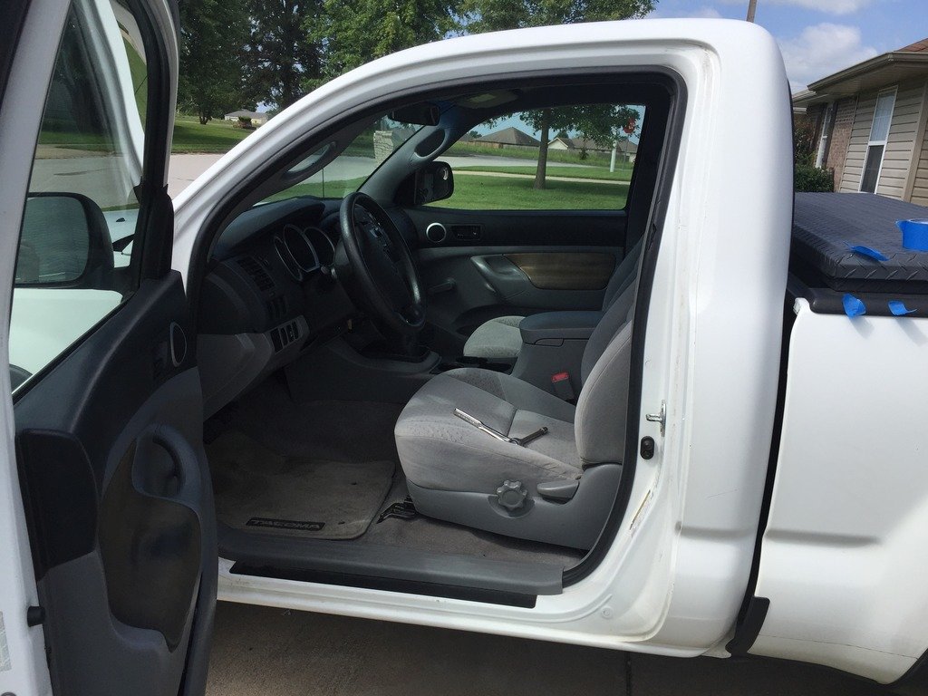

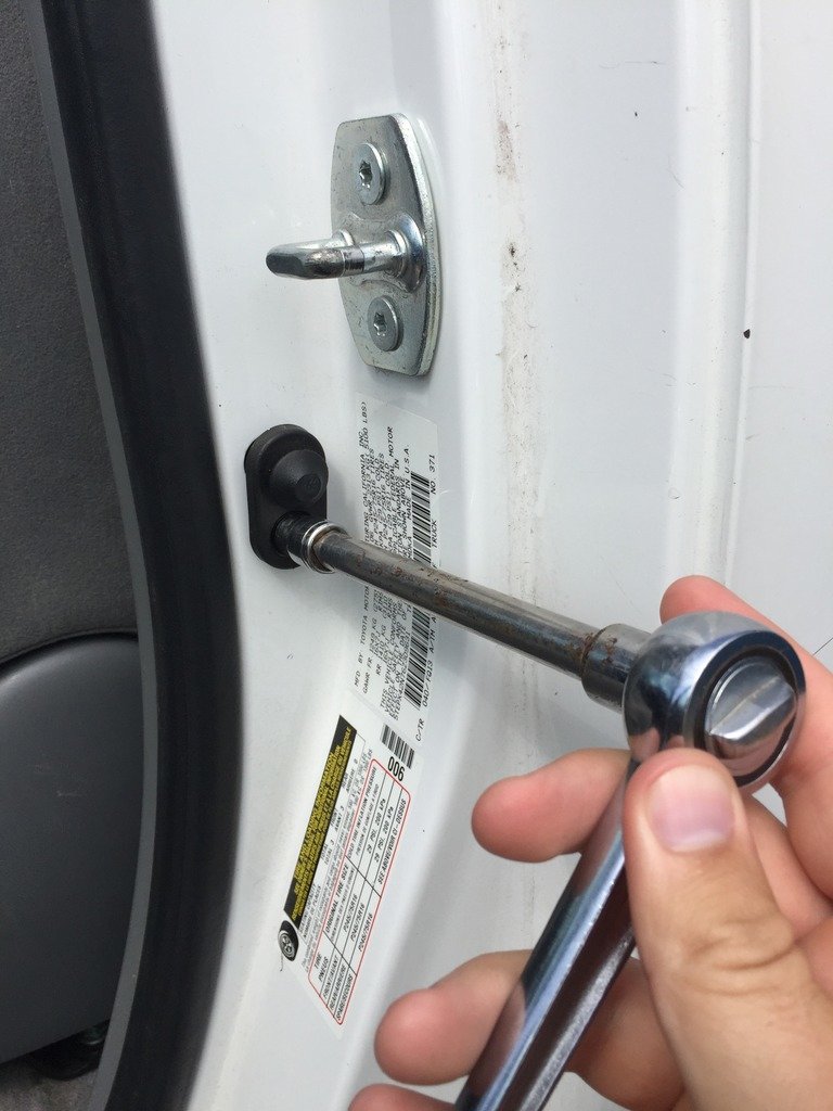

    I decided today that I have heard that silly chime for the last time. I looked at a few pages here where guys were trying to figure out what the fuses go to and which wires to cut or disable. I went outside and looked at the truck for a few minutes and decided to just start taking things apart and this is what I've found.
    3D12DCA8-7F25-40D2-A83B-3C57D04A623F_zps_9433fd74f84368caa793a14c00cfba457885623d.jpg

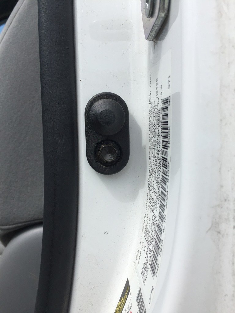

    first off verified the keys were in the ignition and the chime was active. Pushed the little plunger switch down inside the door frame and the chime stops because it thinks the door is closed.
    411C5F57-8496-4B36-B09A-CD613A51A258_zps_71e431d601492d4e4407fe93948d6dcc31829300.jpg
    3728D276-4094-4C9D-8B6E-26132D94F2AD_zps_51f484eeeeec492420e56389070b93e6bbd905dc.jpg
    I took a 10mm socket and took that thing off and noticed that before I even fully removed the switch that the chime stopped.
    6F655D04-0625-49CF-850A-FEF65828C080_zps_1053ac020240f390fa933887731141d9c5e5a59c.jpg

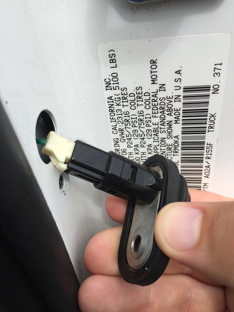

    When I removed the 10mm bolt and inspected the switch I found that the back had a metal connector that likely completed some kind of electrical circuit allowing the switch to function properly. Without the screw being able to complete the circuit the chime can't work.
    194C4ECD-CD8B-4511-958C-3930F684B743_zps_d0e5385232e9c8df33b5b05616b8047ce3c7803f.jpg
    I decided to remove the switch all together and tape the male connector off so that I didn't lose it back in the door frame in case this causes some sort of problem later. Though removing the switch isn't necessary. You could glue it back in place to stop the chime and it would still look normal just as long as the bolt wasn't in it.
    43773E67-987E-49F8-A286-1A0A91F06F22_zps_156a7a9936865df43e28f99ccd2bca43d4b98271.jpg
    21E845B6-533C-4465-A151-26B39BE11E99_zps_304df40a31a580b467b9669633b9e231a553b69c.jpg
    I will add that I have an 06 which I read doesn't have the seatbelt chime. I'm not sure how this would effect any of the newer ones but I did look into lights to make sure my battery wouldn't be drained unknowingly. With this little mod completed, since the truck thinks the door is always closed, the dome light switch will only function as on/off. There will no longer be a "light on when door open" light. However, you can still switch the light to "on" and it will function normally. The headlights act normally and I can't find or think of anything else that would cause any issues. Time will tell I guess.

    Won't this disable the dome light turning on when you open the door?

    Wouldn't it be better to trace that green wire back from the door switch and then locate a place to cut the wire and install a toggle switch to disable the chime only when you want. That way you don't have things taped and hanging out of a hole in the door jam, which is pretty Ghetto IMO.

    As I stated in the post. You don't have to tape the connector like I have. You can simply re-attach the switch to the truck with something other than a metal screw. Epoxy, plastic screw, light glue, etc. The metal screw is really the only thing that need to be removed to disable the chime. My intent with this is to be cheap and easy. Most people that just want that chime to go away probably won't chase wires and install switches, IMO. This just requires a 10mm socket and your imagination on how you want it to look after the bolt is removed.

    your headlights won't go off automatically anymore, don't forget to turn the switch off when leaving the truck

    Yeah I thought about this being a problem with other people. My truck still has manual lights. I enjoy manual everything. Windows that I have to crank up, locks that I physically lock myself, and lights that don't decide for me when they're on or off.
